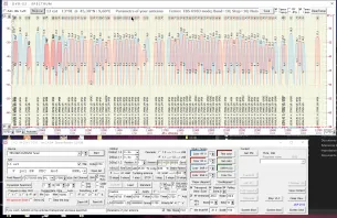

  • You can also use 4T2 as a stand-alone program and load the *.ts file from any other program.
    The system crashes are not due to the IQMonitor, nor to the TBS6925. That definitely other causes!
  • You have not set the correct path in the [Parser] section of your IQMonitor.ini file. (I have red marked in picture)
    For example:
    [PARSER]
    Java=C:/Program Files (x86)/Java/jre1.8.0_161/bin/javaw.exe
    TSRLite=C:/Program Files (x86)/Cool.stf/TSReaderLite/TSReaderLite.exe
    TSR=C:/Program Files (x86)/Cool.stf/TSReader/TSReader.exe
    VLC=C:/Program Files/VideoLAN/VLC/vlc.exe
    MPC-BE=C:/Program Files/MPC-BE x64/mpc-be64.exe
    4T2ContentAnalyser=C:/Program Files (x86)/ABC/4T2 Content Analyser/ABC4T2ContentAnalyser.exe
    4T2INI=C:/Users/your_user_name/AppData/Roaming/ABC/4T2 Content Analyser/ABC4T2ContentAnalyser.ini
    TrEdit=C:/Program Files (x86)/DVBViewer/TransEdit.exe
    Also in Subfolder "positions" from IQMonitor I'm missing the 0130.ini, maybe there are no ini-files (blue marked in picture)
    They are not necessary, but recommended
    satellites.ini.IQMonitor.zip

  • Code
    despite your effort I don't understand how to do it
    in the picture are the things you wrote
    when I start the sw the writings are always grey,
