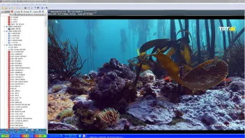

  • TBS 6903X_Dvb-S2/16APSK feed locked

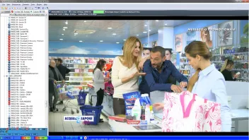

  • tbs6903X-5.0W MIS+PLS with Crazyscan.

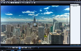

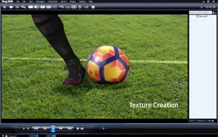

  • tbs6903X-scanned 8k transponder at 85.0E with Crazyscan and played with ProgDVB & DVB Dream.

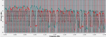

    Here's what the blindscan looks like with this card at 18.0W:
