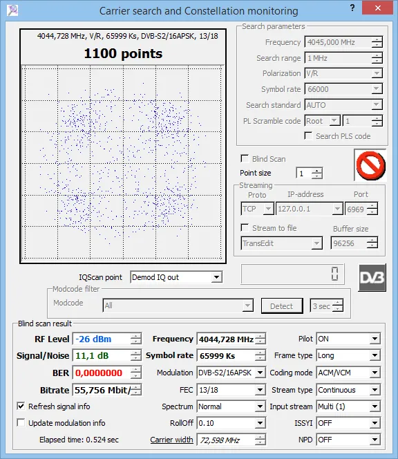

  • 4045 R , one of my tool give a SR at 46.467
    Changed SR now to 66000, with MIS 1. :3:
    (Also in S2)
