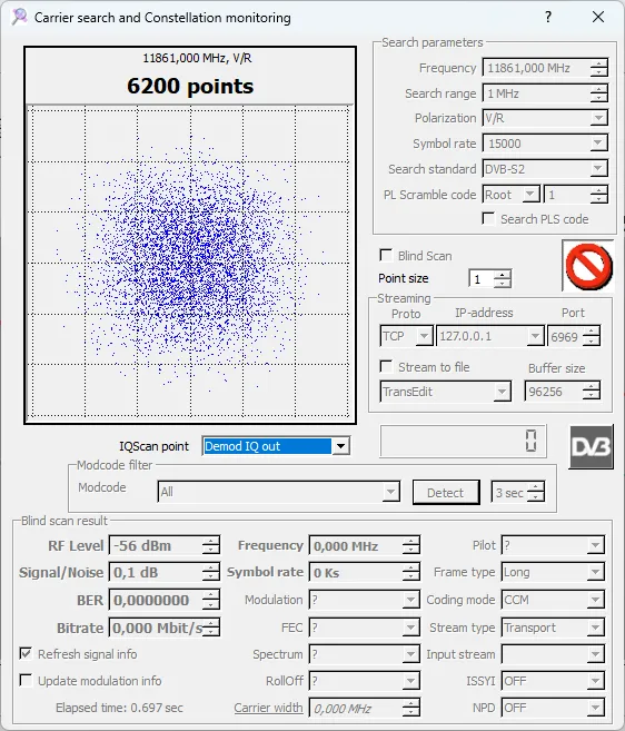

  • New appearing here:
    11861 V 15000 2/3 DVB-S2 QPSK - about 3.2dB under LM on 2.2m from my place

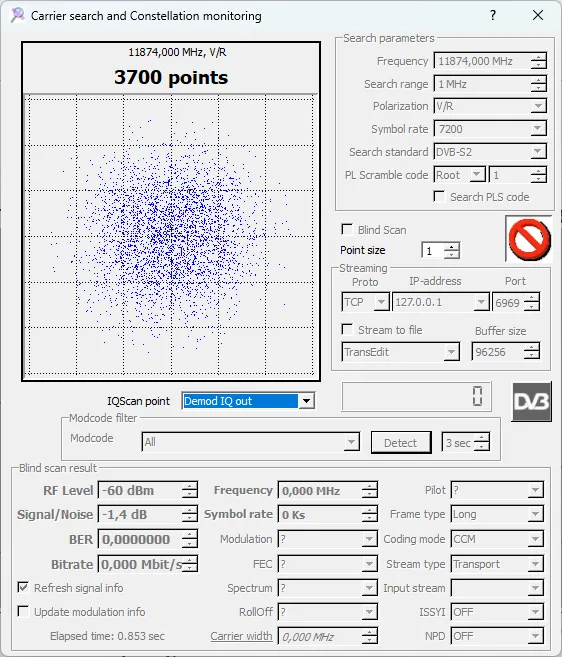

  • Nothing new appeared, but my personal NO LOCKED signal record on:
    11874 V 7200 5/6 DVB-S2 QPSK - about 1.7dB under LM with 2.2m (/edit)

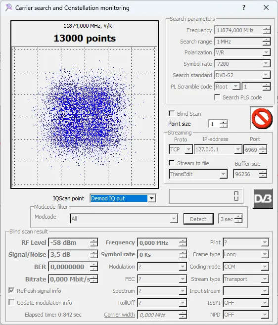

  • 11874 V 7200 5/6 DVB-S2 QPSK
    less than 0.5dB more needed.... :69:
    /edit: locked on 01.12.2024 as GS

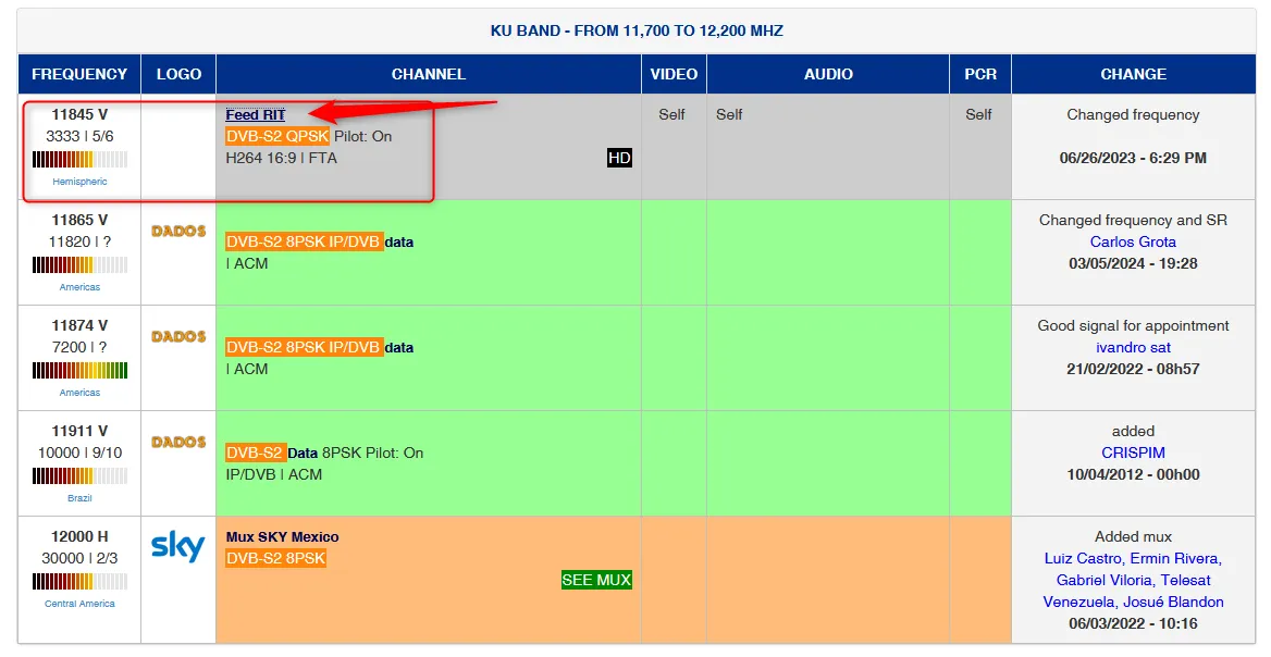

  • First time that I can see "feed parameter" from this satellite here ... :72:
    11845 V 3333 5/6 DVB-S2 QPSK - RIT feed from Brazil, according BSD PORTAL
    PS: About 4.5dB under link margin on 2.2m from my place

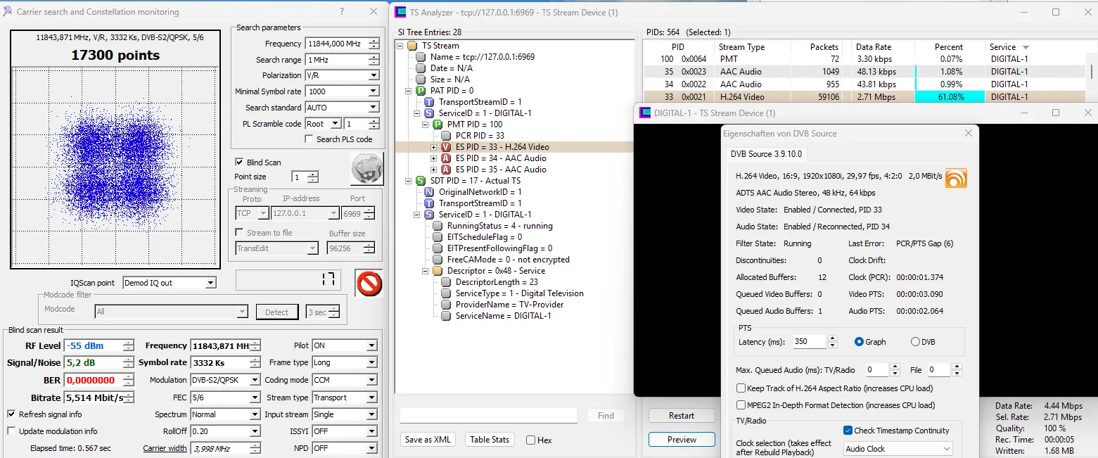

  • :69: /edit 08.35 CET: Locked 11844 V this morning - too low signal yet for showing content (RIT)...
    11844 V 3333 5/6 DVB-S2 QPSK... signal maximum in the early morning hours (from my place)
    PS: 11875 V 5380 (GS) ... signal maximum and lock in the evening hours (from my place) :125:
    /edit2: 12.00 CET ... monitoring TS (from 9.00 to 12.00 CET I was not at home)... getting PIDs :426:

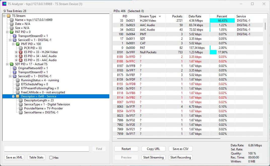

  • Locked RIT (Brazil) on 11844 V 3333 5/6 DVB-S2 QPSK again this evening at 22.00 CET in manual scan with 2.2m from my place
    One screenshot is possible now... :35:
    (PS: 11875 V 5380 (GS) was also possible at 20.15 CET)
