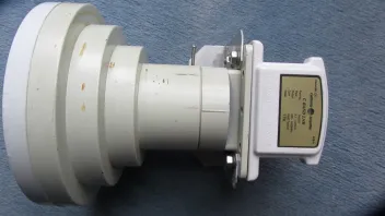

  • Hallo ,
    Kennt jemand von euch diese Art von C Band LNB?
    Ich weiss , dass es nur von 3700 bis 4200 geht ,
    ist es aber eine gute LNB ?
    Das beste ist selber zu probieren , ich weiss es
    Winter ist aber dafür nicht ideal.
    Wenn jemand schon mit solche LNB Erfahrung hat, bin ich ganz Ohr
    Hello
    Do any of you know this type of C band LNB?
    I know that it's only possible from 3700 to 4200,
    but is it a good LNB?
    The best is to try it yourself, I know it
    But winter is not ideal for this.
    If someone already has such LNB experience,
    I would be happy to read them

  • This LNB is standard. Although it has the above range from 3700MHz, it can easily handle lower frequencies. Given the gradual interference of the band below 3.7GHz from LTE internet, this range will be an advantage rather than a disadvantage.:426:

    weiss Du ob diese LNB durchschnittlich ist oder gut oder schlecht in Sache Empfindlichkeit ?
    Thank you very much :73:
    do you know whether this LNB is average or good or bad in terms of sensitivity?

    It is a common commercial DRO LNB. Its properties are at the level of the average. They can also vary from piece to piece. The features of the NJS8486 series or Norsat 8115 cannot be expected. But they are suitable for normal use. :61:

    Sorry for offtopic. I would like to know where you find this feedhorn. I see one @ mkon user from another forum.
    He is using this feedhorn on Mabo antenna 1.85m f/d 0.6.
    Since i have this antenna, i like to buy one and plastic support.

  • You can use the inner part from
    https://www.ebay.co.uk/itm/JONSA-Feed-Horn-/142973652361
    for flange
    and
    https://www.catvindia.com/c-band-scalar-Kit
    for feed,
    or https://roks-tv.com/c-band-offset-feed
    ... if you are using a flange LNB.
    I hope you have an adapted feed holder, I think the original have only an diameter of 40 mm, you need 65 mm.

  • Thanks @all.
    It would be easy for me to find this complete solution rather than to buy and assemble from parts, also, i need the feedhorn support.
    I hope to find this kit in Eu.

    C-band components are more difficult to obtain in the EU. The C band is used only exceptionally, for professional purposes. The components mentioned by feci01 are available in Ukraine. The plastic stepped feedhorn is home made.
