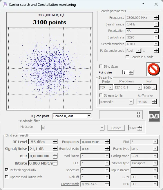

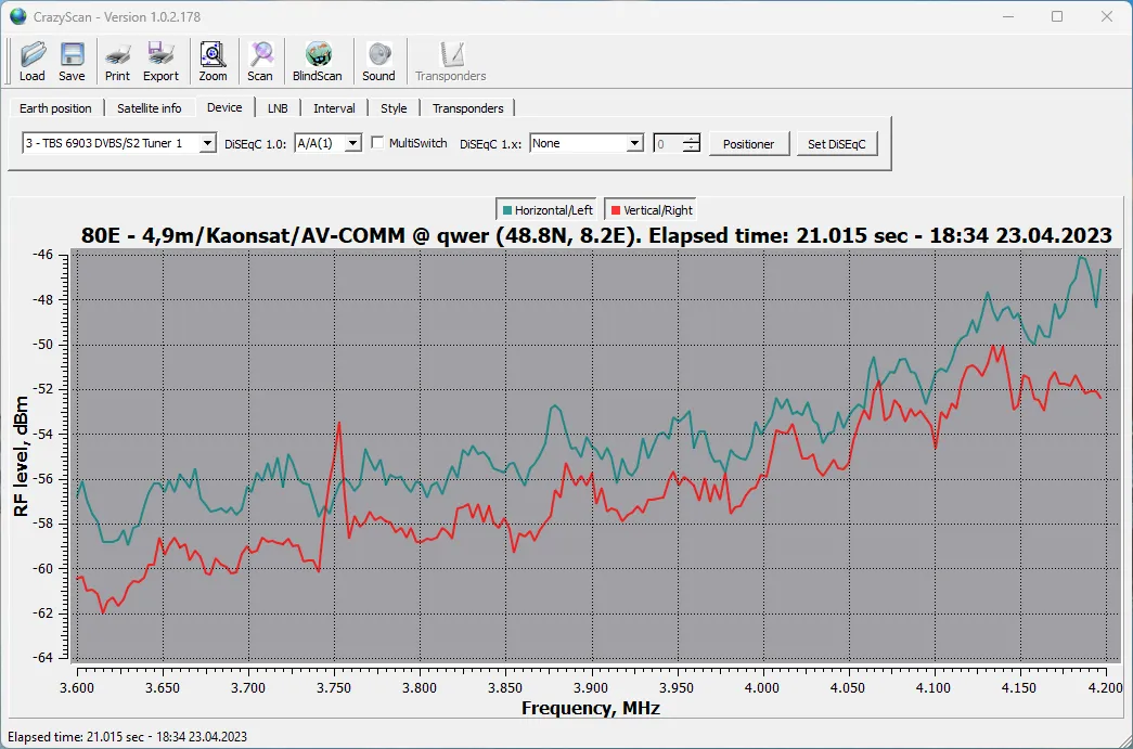

  • :64: Probably somone can check this circular signal at about 3962 (my linear scan here - sorry) - nothing to lock for me on my last C-band position (no clear view to satellite). It also could be an "LNB fake" - but I don´t think...
  • One week later in circular now.
    Still there, peak at 3961 L - constellation.
  • Just my circular spectrum in 2023 on my last "viewable" east-position... :175:
    Nothing "on" in C-band, according LyngSat/FlySat.

  • Just a look in my spectrum - but my "dishsize" is here about 1.2m... according neighbour house...
  • Thanks N_Stanislav ... here my current spectrum...
    3805 L 3290 ... for sure using (also) DVB-S2X... up to +20dB but without lock (on TBS 6903X)...
  • Today on this position...I think... ignore my disturbed spectrum please...
    3813 R 3253 - unlocked, probably GS
    3891 R 13850 - real frequency, no fake

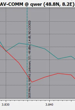

  • One more unlocked appeared...
    3831 L 3904
    :49:When first of these can be locked... I´ll promise starting a new GS toppic and merged them all in there... :26.

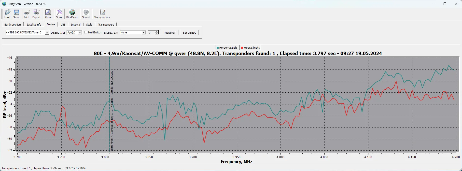

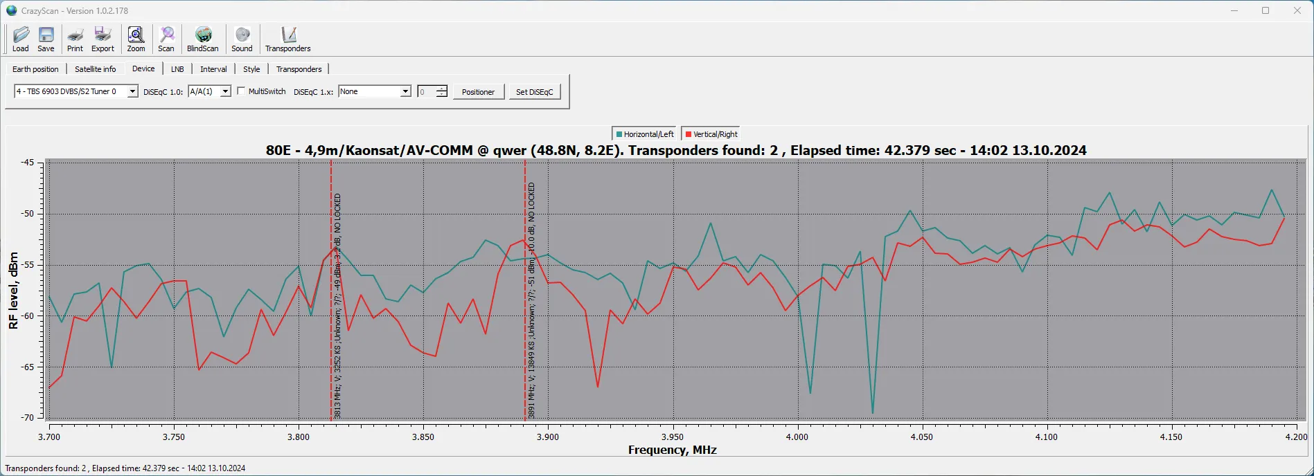

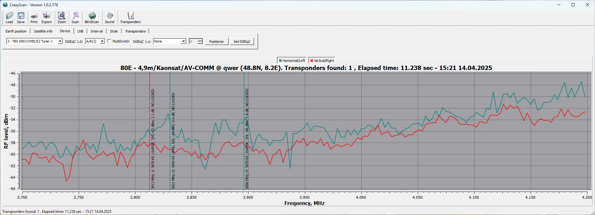

  • qwer still works there lot data streams
    According to your report, it seems that the transponders I found are from 80.0E. I'm not sure about that.
    On the other hand, I'm a little confused that the same transponders are on both polarities. I know that Express 80.0E, like all Russian satellites, works with circular polarization.
    I think I mounted the LNB correctly on the tripod, and I don't think I made a mistake.
    Could it be on Blagovest 3, 70.0E?
  • Could it be on Blagovest 3, 70.0E?
    No, I never saw these "no locks" on position 70.0°E (attached our GS findings in this range)...

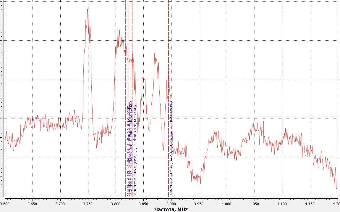

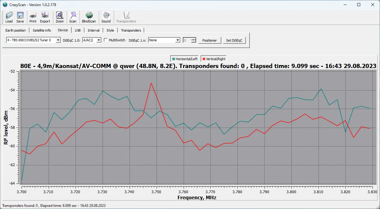

  • ...and my current try... :72:
    /edit: one more later (already posted by satesco in his scan above)
    Thanks, qwer, for your spectrum. :3: I understand from this that there is no mistake with the polarities, as both are being used.
    I am only surprised by the low signal level.
    Even @N_Stanislav's signal is not very good, too, despite being geographically it should be stronger.
    It's strange that both on Ku-band and C-band footprints cover the same geographical area, but the signal is stronger on Ku-band. Probably because of the TV packages.
  • ... okay... 8/9 from satescoscan above... :69: (3830 L 3905 not in my scan)
