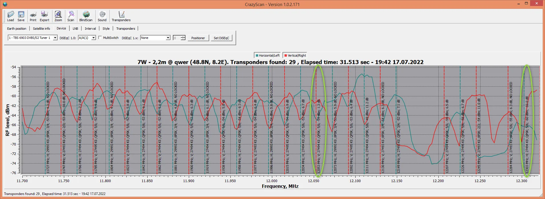

    Nothing changed this evening for me on this one (12053 V) - still no video content possible.
    First "smooth lock" with TBS 6522 on 12303 H - still "-10dB" in BS with TBS 6903 (4.3dB in manual scan). :72:

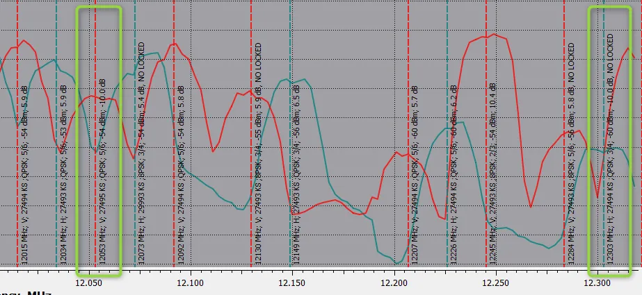

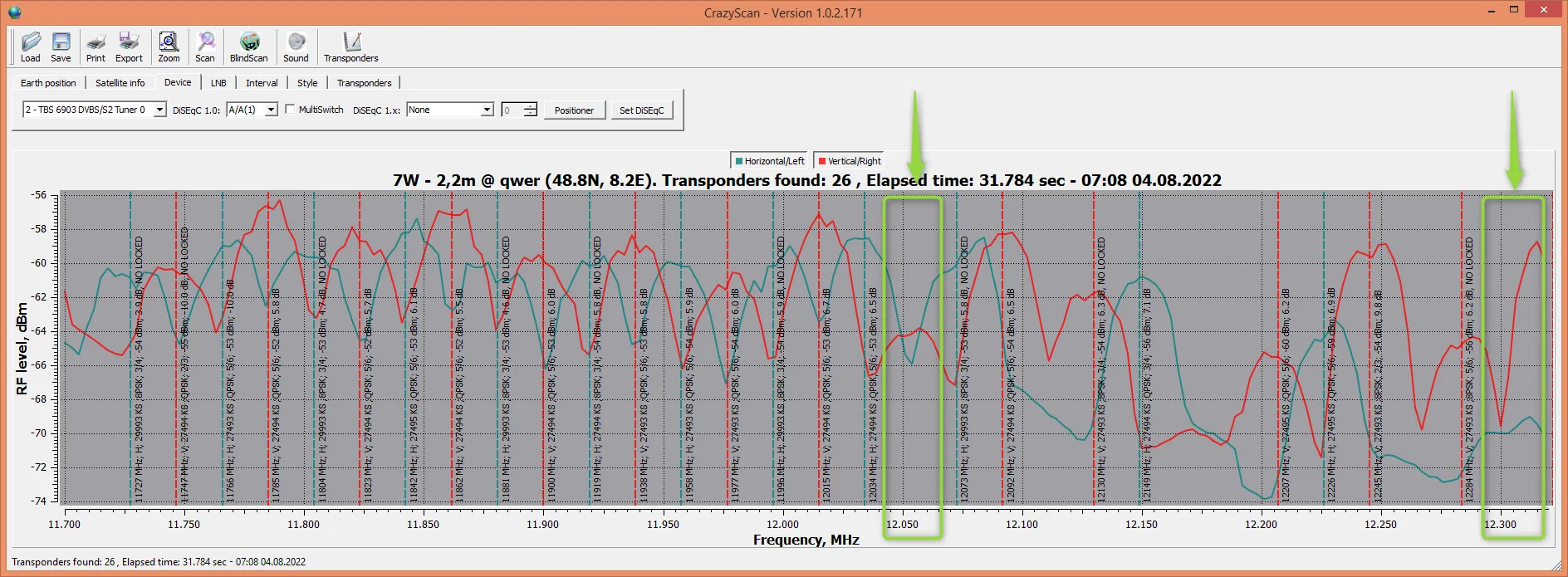

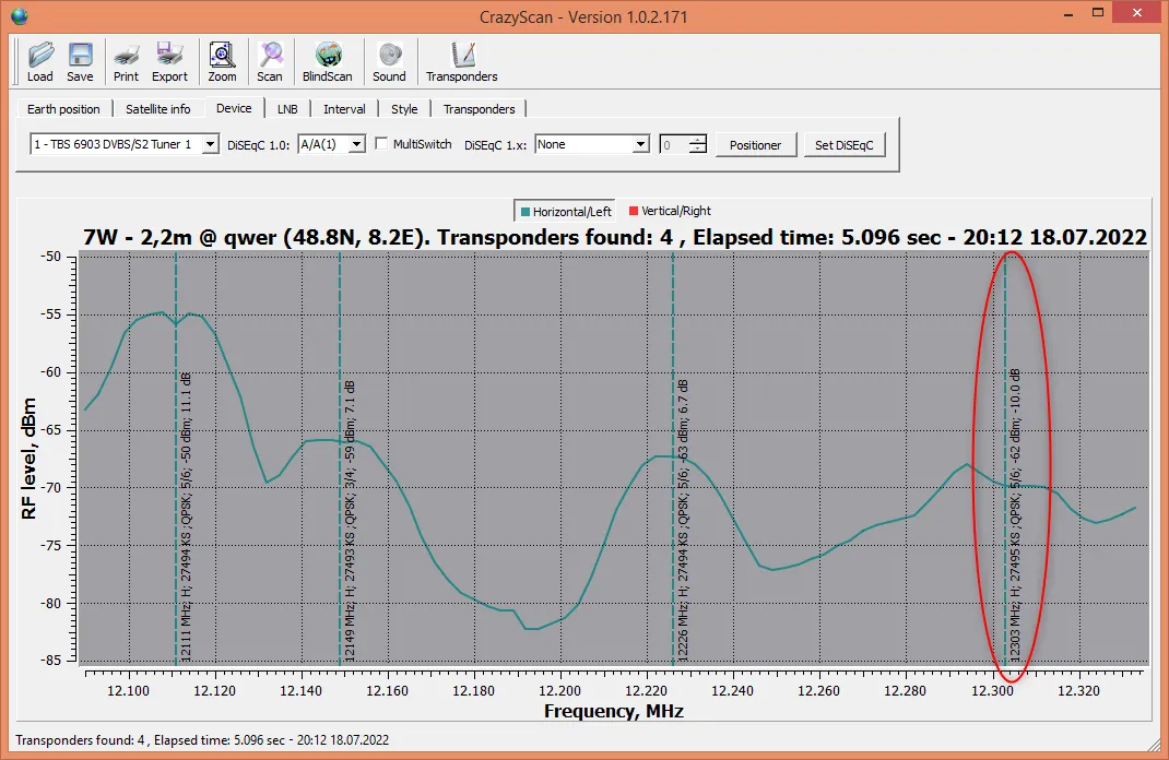

    Hi stephan94,
    thanks for your scan!
    In my opinion, 12284 V (6.7dB with 2.2m at this time) is still from Nilesat 201, because the signal not de-creases in my area, in comparison to 12053 V and 12303 H.
    Best regards
    qwer

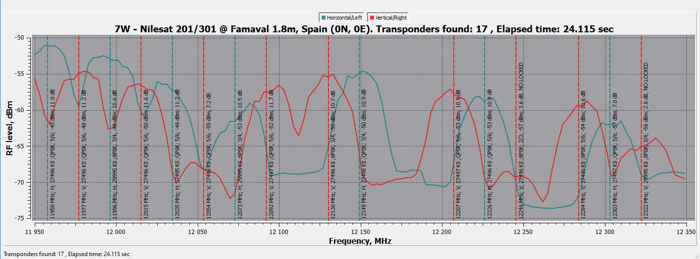

    Danke schön für deine Antwort ,
    Du hast bestimmt recht
    ich hatte nur Flysat gelesen.
    Hier das Ergebnis mit IQMonitor pro
    Thank you for your answer,
    I'm sure you're right
    I had only read Flysat.
    Here is the result with IQMonitor pro
  • I also think that 12284 V belongs to 201, it is possible to see that the signal remains at the level of the other tranponders while 12054 V and 12303 H have a loss of about 3/4dBs.

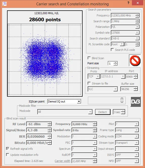

    Just to let you know: both Nilesat 301 tp 12053 V and 12303 H without any signal via CS - only poor QPSK constellation visible - checked whole past week at my place with 2.2m (TBS 6903/TBS 6522).
    PS: Nilesat 201 tp with unchanged signal here [15 DVB-S tp lockable].

  • Both Nilesat 301 tp 12053 V and 12303 H only "visible" in spectrum (TBS 6903).
    PS: "PLS-trick" with TBS 6522 card for manual lock on 12053 V without success yet.

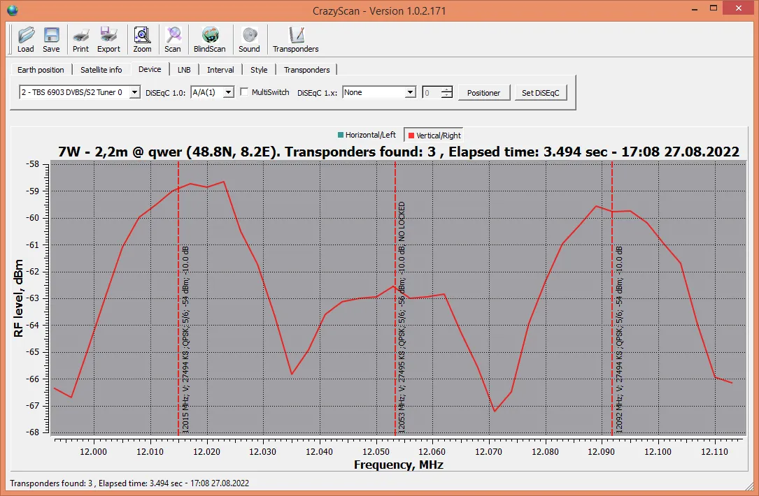

  • No joke today.
    09.00 CET ...I call it "smooth" lock with TBS 6903 (can´t lock in manual scan - and even not with TBS 6522 - so my signal is < 3.8dB on TBS 6522) on 12053 V
    /observing this signal during day...
    19.20 CET - lockable again in BS with TBS 6903
