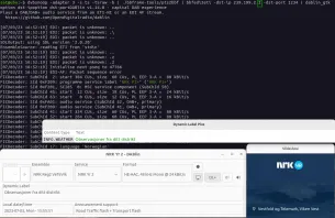

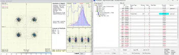

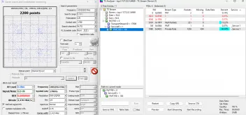

  • Intelsat 10-02 Thor 6 @ 1° W
    10720 C,5400,3/4,8PSK_GenericStream._DAB+ NRK(1-Reg1 OsloVik, 2- Reg2 VeTeVik, 3-Reg3 SerRog, 4-Reg4 Vest, 5-Reg5 Innland, 6-Reg6 TreMeRo , 7-Reg7 NoTrFi, 8-Riks)
    Decoding this stream was a problem for those who tried to do it because, being transmitted in GSE format, they needed a dvb card capable of processing the data of a generic stream, and on the other hand, an application, such as Eti-tools, that knew how to extract the generic stream in a format that the Dablin player could read.
    Among the existing dvb cards on the market, only those with demod stid135 (tbs6903se/6909x or Digital Device) can decode this stream, and these with the official drivers of the manufacturers. But decoding the stream was impossible because I installed the neumoDVB application, which only works with a specially modified driver. That's why deeptho (thanks), the developer of neumoDVB, made some changes in his driver to find the right format (rawframe) for this generic stream.
    Finally, with the new driver, it was possible to decode this NRK stream, which I later discovered has 8 IP addresses, each with a separate stream.
    In short, the dvbsnoop application reads the transponder stream using the 6903x/6909x board, and the neumoDVB application transmits the stream to the Dablin player. You can also use DVBstream or DVBlast.
    I used DVBsnoop, Tune-s2/neumoDVB, and the Dablin_gtk player for these tests.
    Selecting a DAB+ stream (regional) is done by changing only the last digit of the IP, which starts with 1 and ends with 8, i.e., dst-ip 239.199.2.1 (with 2,3,4,5,6,7,8).
    You can see the video below as I worked with Tuner-S2 and neumoDVB:
    Code
    tune-s2 10720 V 5400 -adapter 7 -system DVB-S2 -lnb UNIVERSAL
    dvbsnoop -adapter 3 -s ts -tsraw -b | ./bbframe-tools/pts2bbf | bbfedi2eti -dst-ip 239.199.2.1 -dst-port 1234 | dablin_gtk
    -streamul 8 cu adresa cu adresa 239.199.2.8
    0 : P6 Rock (0xf216) Pri subch= 3 start=144 CUs= 48 PL=eep-3a bitrate=64 DAB+
    1 : P7 Klem (0xf217) Pri subch= 4 start=192 CUs= 48 PL=eep-3a bitrate=64 DAB+
    2 : RADIO NORGE (0xf21a) Pri subch=31 start=432 CUs= 54 PL=eep-3a bitrate=72 DAB+
    3 : P24-7 MIX (0xf161) Pri subch=34 start=576 CUs= 36 PL=eep-3a bitrate=48 DAB+
    4 : P4 LydenAvNorge (0xf214) Pri subch= 1 start= 0 CUs= 96 PL=uep 3 bitrate=128
    5 : NORSK POP (0xf33f) Pri subch=35 start=612 CUs= 36 PL=eep-3a bitrate=48 DAB+
    6 : P24-7 FUN (0xf31a) Pri subch=39 start=786 CUs= 36 PL=eep-3a bitrate=48 DAB+
    7 : P0DPLAY (0xf41a) Pri subch=40 start=822 CUs= 30 PL=eep-3a bitrate=40 DAB+
    8 : P8 Pop 80s (0xf218) Pri subch= 5 start=240 CUs= 42 PL=eep-3a bitrate=56 DAB+
    9 : P9 Retro (0xf219) Pri subch= 6 start=282 CUs= 48 PL=eep-3a bitrate=64 DAB+
    10 : P10 Country (0xf213) Pri subch= 7 start=330 CUs= 48 PL=eep-3a bitrate=64 DAB+
    11 : NRJ NORGE (0xf212) Pri subch= 8 start=378 CUs= 48 PL=eep-3a bitrate=64 DAB+
    12 : KISS N'DANCE (0xff61) Pri subch=33 start=540 CUs= 36 PL=eep-3a bitrate=48 DAB+
    13 : RADIO ROCK (0xf03f) Pri subch=32 start=486 CUs= 54 PL=eep-3a bitrate=72 DAB+
    14 : VINYL (0xf01a) Pri subch=36 start=648 CUs= 54 PL=eep-3a bitrate=72 DAB+
    15 : TOPP40 (0xf11a) Pri subch=37 start=702 CUs= 48 PL=eep-3a bitrate=64 DAB+
    16 : P5 Hits (0xf215) Pri subch= 2 start= 96 CUs= 48 PL=eep-3a bitrate=64 DAB+
    17 : P24-7 KOS (0xff1a) Pri subch=38 start=750 CUs= 36 PL=eep-3a bitrate=48 DAB+
    External Content youtu.be

    Two DAB WDR streams were activated at 19.2E on trp 11604 V,2200,3/4, and a copy of the two was activated at 23.5E on 12645 V,2200,3/4. (Credit goes to Adam792 on the UK forum)
    dvbstream -c 1 -o 3000 | fedi2eti 3000 228.10.1.5 10010 | ni2out --list
    dvbstream -c 1 -o 3000 | fedi2eti 3000 228.10.1.5 10010 | dablin_gtk
    Radio DAB+ WDR
    0 : WDR Event (0xdf96) Pri subch= 6 start=252 CUs= 36 PL=eep-3a bitrate=48 DAB+
    1 : WDR 2 BERG.-LAND (0xdc92) Pri subch=22 start=810 CUs= 54 PL=eep-3a bitrate=72 DAB+
    2 : WDR 2 S�DWESTF (0xdb92) Pri subch=21 start=756 CUs= 54 PL=eep-3a bitrate=72 DAB+
    3 : WDR 2 M�NSTERL (0xda92) Pri subch=20 start=702 CUs= 54 PL=eep-3a bitrate=72 DAB+
    4 : WDR 2 AACHEN (0xd492) Pri subch=19 start=648 CUs= 54 PL=eep-3a bitrate=72 DAB+
    5 : WDR 5 (0xd395) Pri subch= 4 start=156 CUs= 48 PL=eep-3a bitrate=64 DAB+
    6 : WDR 2 OWL (0xd592) Pri subch=18 start=594 CUs= 54 PL=eep-3a bitrate=72 DAB+
    7 : WDR 2 RHEIN-RUHR (0xd792) Pri subch=16 start=486 CUs= 54 PL=eep-3a bitrate=72 DAB+
    8 : WDR 2 RUHRGEBIET (0xd692) Pri subch=17 start=540 CUs= 54 PL=eep-3a bitrate=72 DAB+
    9 : WDR Maus (0xdf95) Pri subch= 2 start= 54 CUs= 48 PL=eep-3a bitrate=64 DAB+
    10 : WDRcosmo (0xd496) Pri subch= 5 start=204 CUs= 48 PL=eep-3a bitrate=64 DAB+
    11 : 1LIVE diGGi (0xdf91) Pri subch= 3 start=102 CUs= 54 PL=eep-3a bitrate=72 DAB+
    12 : WDR 4 (0xd394) Pri subch=14 start=360 CUs= 54 PL=eep-3a bitrate=72 DAB+
    13 : WDR 2 RHEINLAND (0xd392) Pri subch= 7 start=288 CUs= 54 PL=eep-3a bitrate=72 DAB+
    14 : 1LIVE (0xd391) Pri subch= 1 start= 0 CUs= 54 PL=eep-3a bitrate=72 DAB+
    15 : WDR 3 (0xd393) Pri subch=15 start=414 CUs= 72 PL=eep-3a bitrate=96 DAB+
    dvbstream -c 1 -o 3000 | fedi2eti 3000 228.10.2.5 10010 | ni2out --list
    dvbstream -c 1 -o 3000 | fedi2eti 3000 228.10.2.5 10010 | dablin_gtk

    DAB+ Turksat on 10953 V has not been working for some time now because although there is a signal, it can only lock with difficulty, and the stream cannot be received, no matter which card I use.
    Only IQmonitor(and 6504) manages to find the parameters and play them back, but that's all.
    How is the signal in your area?
