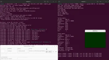

    11221 V,30000,5/6,QPSK2- DAB+ Radio Salisbury
    Code
    -tune-s2 11221 V 30000 -adapter 0 -system DVB-S2 -lnb UNIVERSAL (or neumoDVB on Linux)
    -dvbstream -c 0 -o 701 | fedi2eti 701 239.232.1.201 2048 | dablin_gtk
    The UDP port is now 2048.
    The rest of the parameters for DAB+ Salisbury have remained the same.

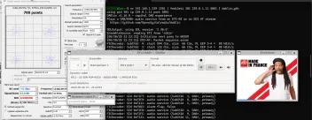

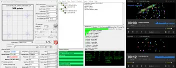

  • Thanks to @andymik #39, we can now listen to DAB+ on Windows using WSL2(Windows Subsystem for Linux).
    I conducted tests on DABs NRK at 1.0 W(6909x card), RAI DAB (6902se card), and Mitropolitain (6983 card) at 5.0 W. Fortunately, they all ran very well.
    For Windows users, it's an advantage that they can work on this system while listening to DAB streams.

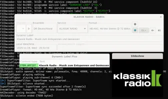

  • The DAB+ German mux-12567 V test at 7.0E on WSL2 (Eti-tools) on Windows (Crazyscan) works as expected.

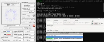

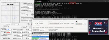

    Real time processing of DAB+ under Windows11:
    From Windows 11 I am streaming the full TS from ALT DVB ver 2.5.0 directly to the IP of WSL2 (unicast UDP).
    You can find this IP in linux using for example this command "ip addr" (generaly it is under eth0)
    On the WSL2 in UBUNTU 24.04 as a MPEG transport stream processor I am using the tsp plugin from TSDuck and some apps from etitools.
    On the picture you can see the command line for tsp and processing. For playing DAB+ streams I am using Dablin GTK GUI from Opendigitalradio,

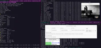

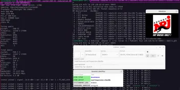

  • I haven't tried running a DAB+ stream with the Blindscan app (neumo-tune and neumo-dmx) yet.
    The first one I tested was DAB NRK at 1.0W on 10716 V, 5400,3/4, 8PSK, MIS 171, which can only be activated with a Stid135 card (6903x/6909x).
    With a Neumo-tune console for the signal and another Neumo-dmx for decoding, the stream can run well with the Dablin player.

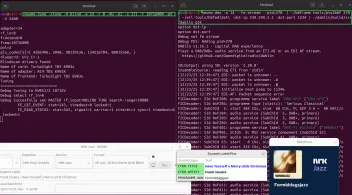

    Here is the final phase showing DAB+ with Windows and Linux (Ubuntu 24.04) with the Metropolitan 1 stream on 11461 H, 5780.3/4 at 5.0W:
