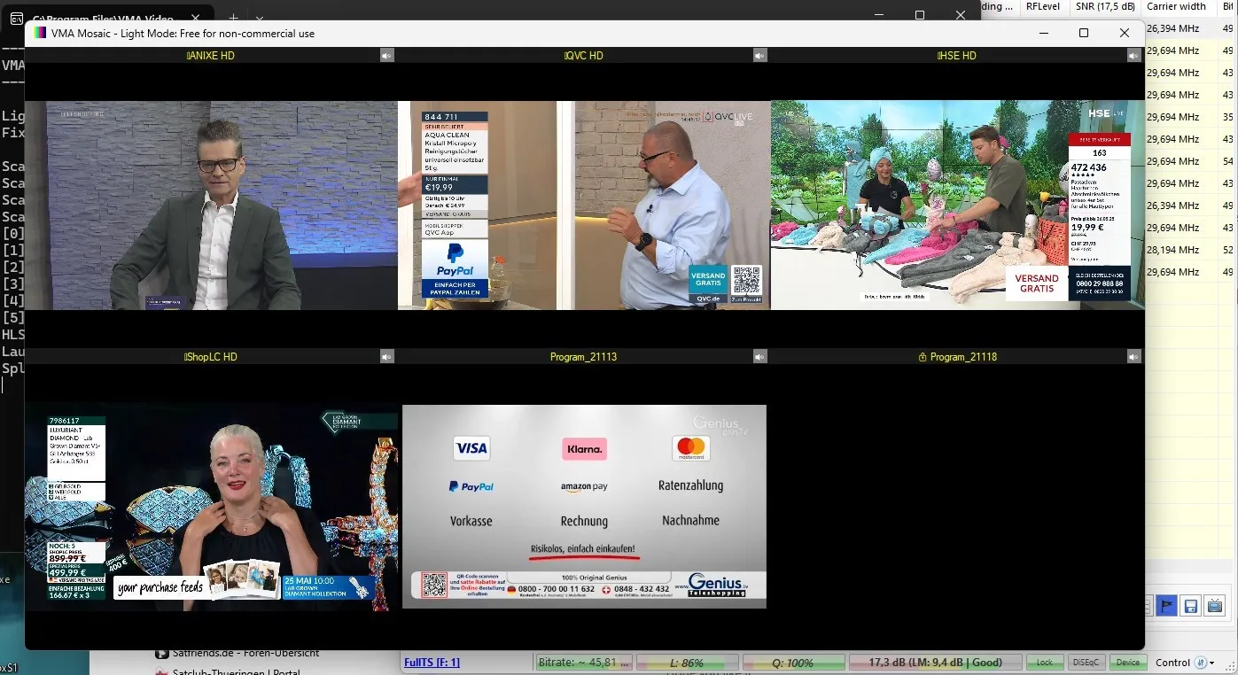

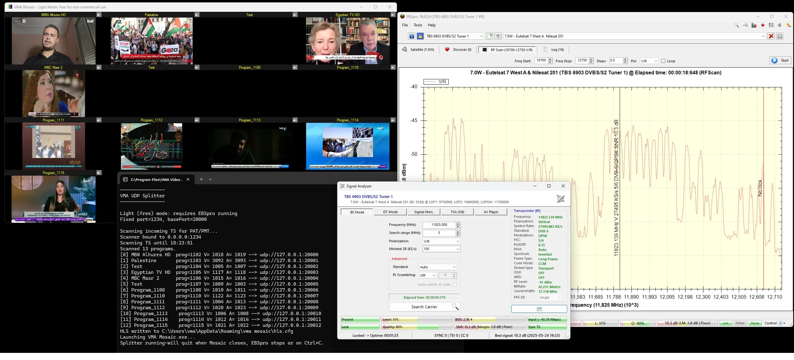

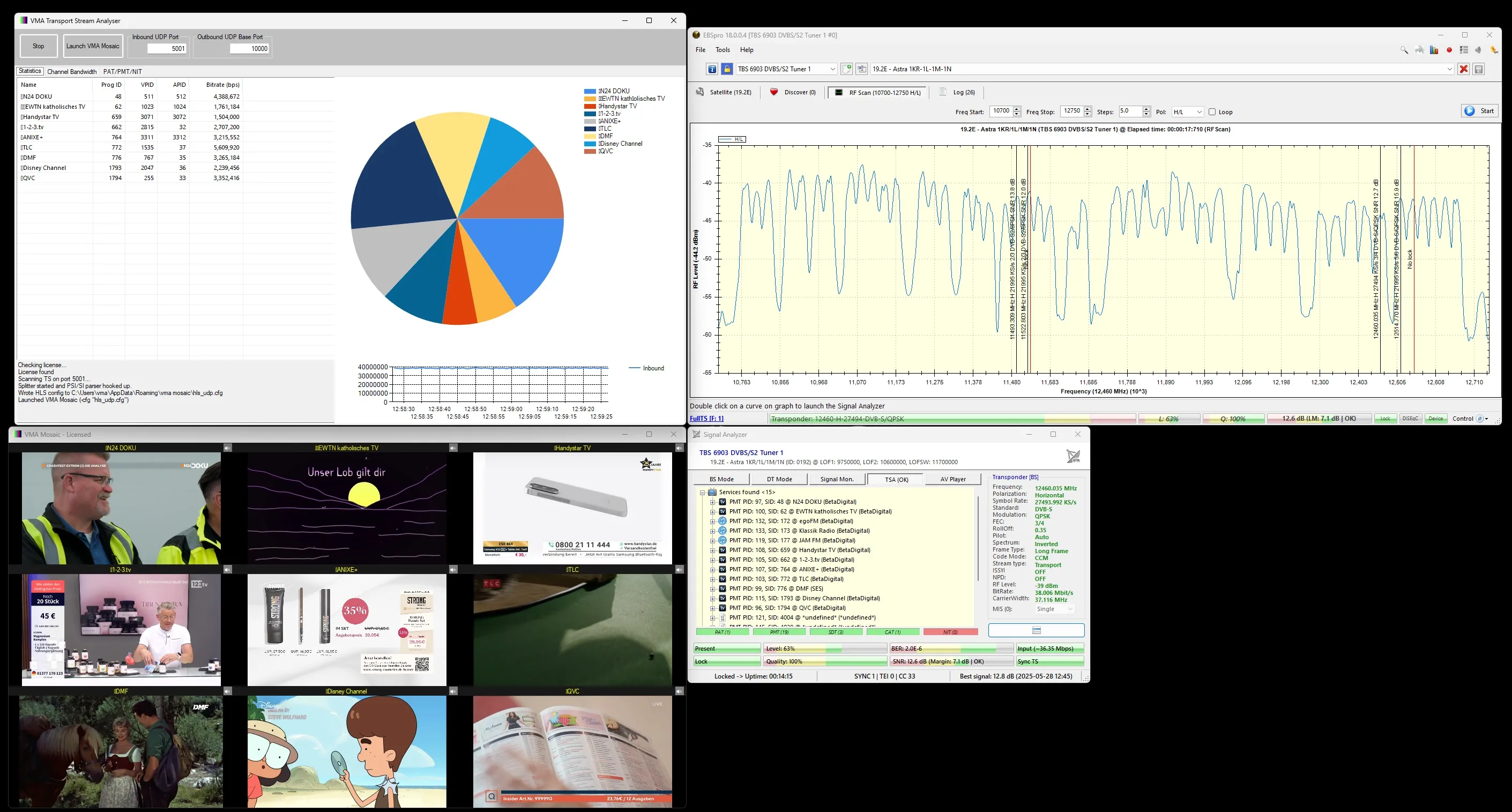

    Finally I managed to make an old dream come true: being able to see a video mosaic of all channels in a satellite transponder, using EBSpro.
    TSReader was close, but the video wall was static, with each panel being refreshed every few seconds. I wanted live video.
    According to the author of TSReader, it could be done with an old VLC version, but it never really worked for me.
    Today I am proud to have finished the VMA UDP Splitter!
    What it does:

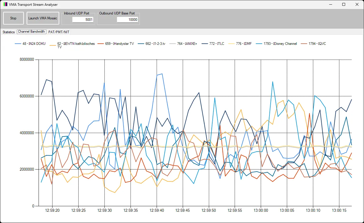

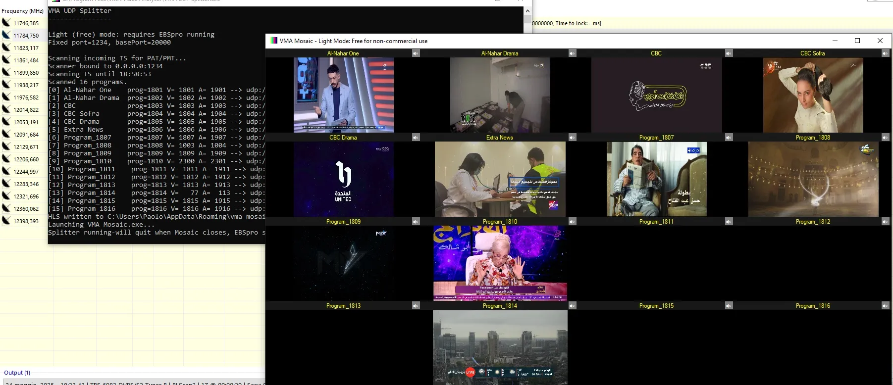

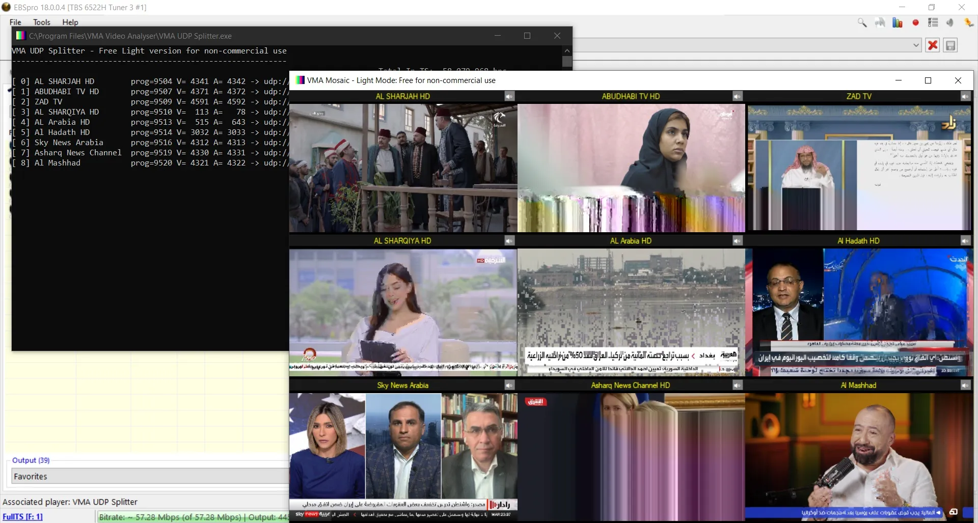

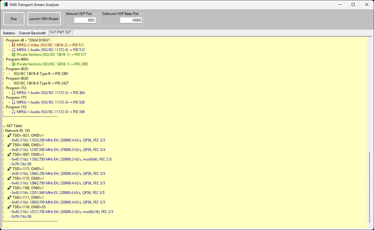

    1. Listens for an incoming MPEG-TS feed over UDP
    2. Demuxes each program into its own UDP channel
    3. Auto-generates an hls.cfg playlist for VMA Mosaic
    4. Launches VMA Mosaic for instant multi-view playback
    It works for any UDP Unicast source (EBSpro, Dektec DtLoop, professional receivers that can stream into the network, etc.).
    I still need to finish the tool, but I wanted to show this off right away.

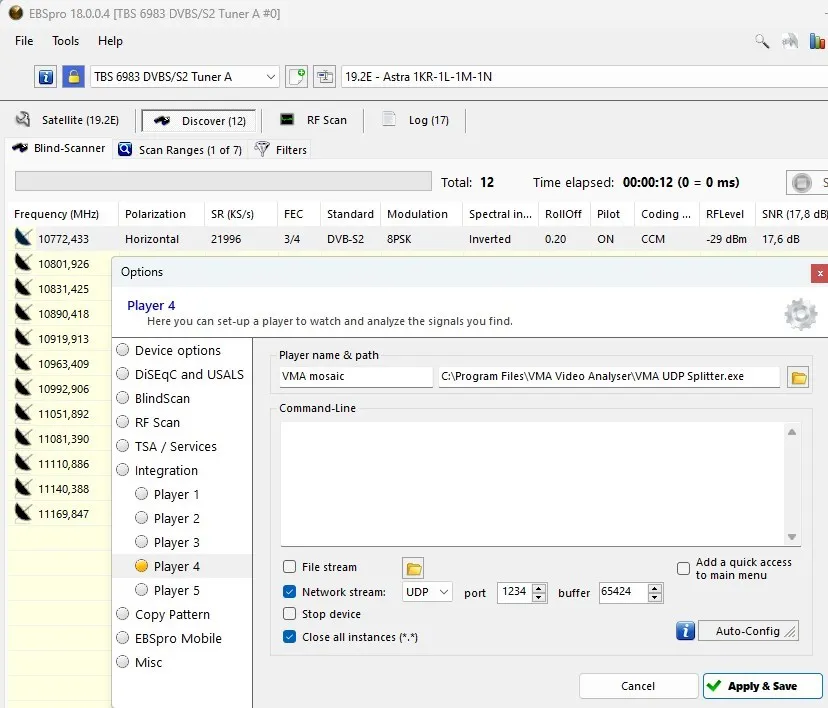

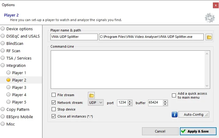

    Make sure to configure EBSpro like this:
    Hope you like it.

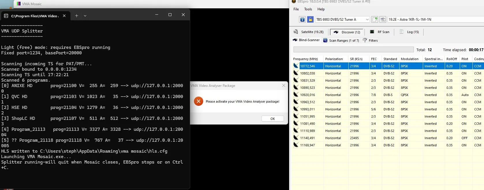

  • Ein Demo Mode startet nicht, nach dem Programmstart kommt die Fehlermeldung
    A demo mode dont start, after program start only this error message.

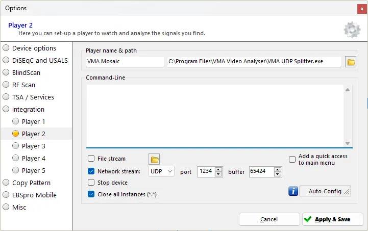

  • Without a license you can only use VMA UDP Splitter with VMA Mosaic from within EBSpro.
    Configure EBspro to start VMA UDP Splitter. Select a transponder and then transmit to VMA UDP Splitter. See image I posted previously.

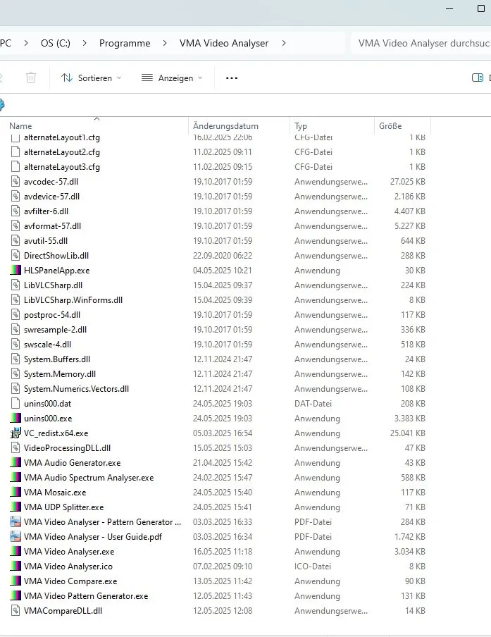

  • I believe you did not uninstall a previous version befor installing today's release. Please uninstall VMA Video Analyser and install version 2025-05-24 again afterwards.
    Never had this software installed on my PC. First time today. Anyway I will uninstall and try again. Thank you this
  • uninstall and re-install dont help
  • Please download again. I just uploaded a new installer. The file name is the same. I uploaded it right now (19h20 CET/GMT+1).
