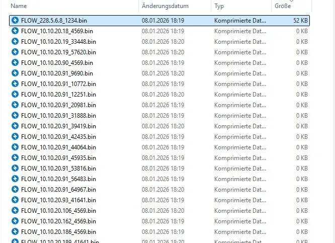

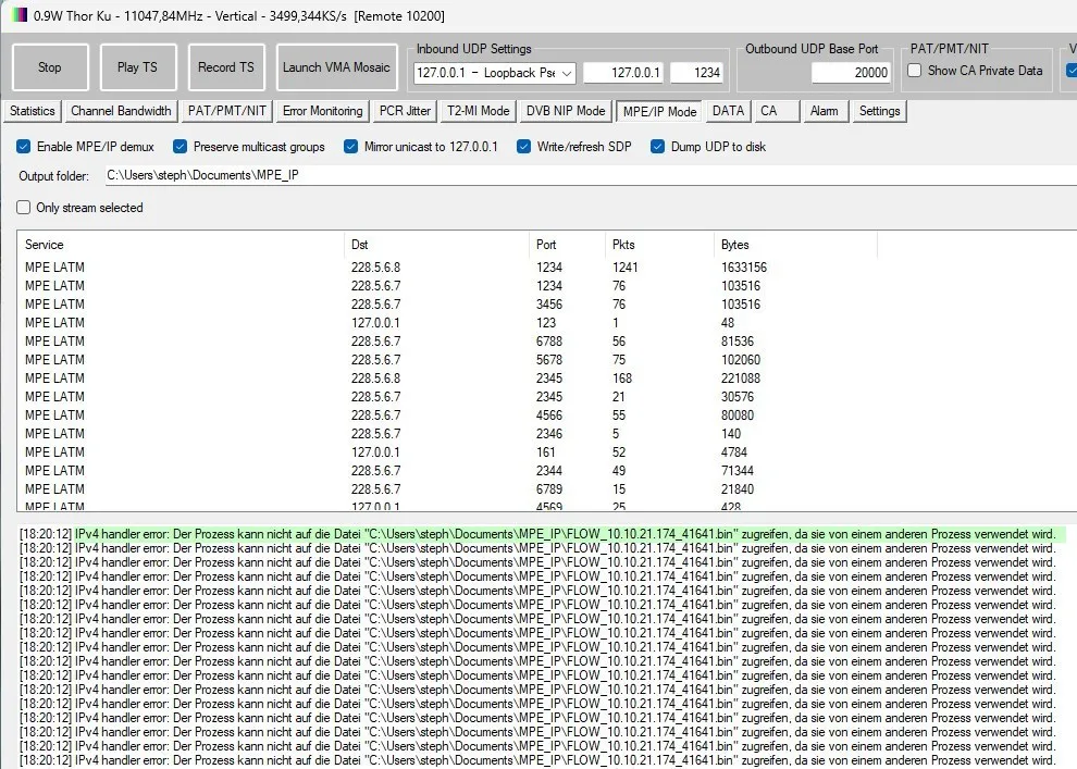

  • Zufällig habe ich auf 1° west diese IP Transponder entdeckt .
    11048 V 3500
    Mit VMA Stream reader habe ich versucht davon irgendwas zu bekommen.
    Ich weiss aber nicht ob ich wirklich alles richtig gemacht habe .
    was merkwürdig ist diese Meldung :
    IP handler error...........von einem anderen Prozess verwendet wird
    Da habe ich keine Ahnung welche Prozess ????
    trotz diese Fehlermeldung bekommen ich eine einzige FLOW Datei mit ein paar KB , alle anderen sind mit 0 KB
    Mit Potplayer kann ich eine kurze video davon sehen ( nicht flüssig)
    konnte ich was besseres bekommen ? und wenn ja wie ?

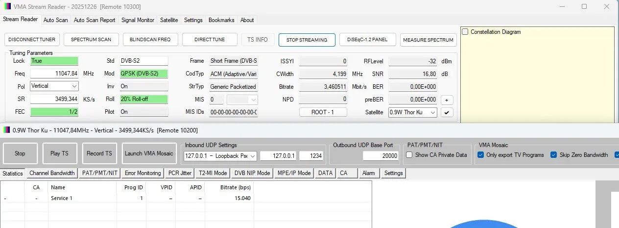

    I happened to discover this IP transponder at 1° west.
    11048 V 3500
    I tried to get something out of it using VMA Stream reader.
    But I don't know if I did everything right.
    What's strange is this message:
    IP handler error... is being used by another process.
    I have no idea which process????
    Despite this error message, I get a single FLOW file with a few KB, all the others are 0 KB.
    With Potplayer, I can watch a short video of it (not smooth).
    Could I get something better? And if so, how?
  • I don't think it's an error. If you uncheck "dump" from the tab, the flow list disappears.
    Otherwise, at least one video stream runs on port 1234. Port 2345 does not work.

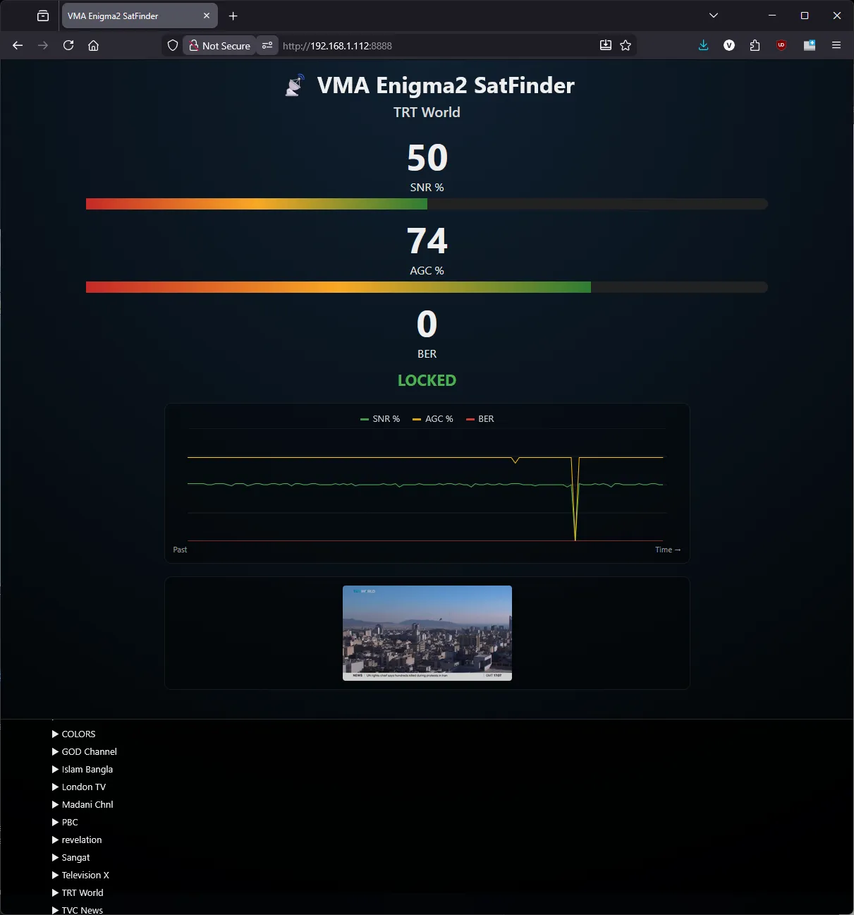

  • Now you can go to the roof and use your mobile phone as a sat finder, connected to the Enigma2 receiver via the VMA Enigma2 Client Pro.
    On the bottom of the page is a finger friendly channel list to switch channels.
    The image (if signal is locked and service is FTA) is updated every second.

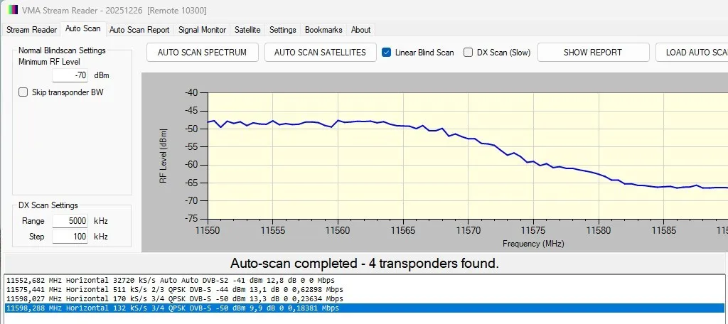

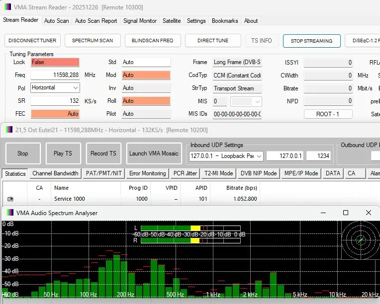

  • On 21.5 East, there is a radio station (Arabic language) with an SR of 132.
    11598 H 132
    Obtained with VMA Stream Reader.

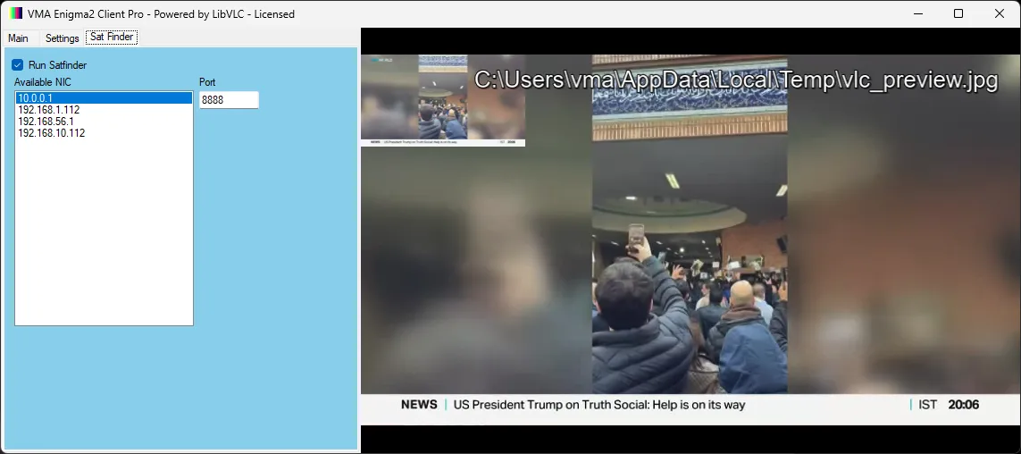

  • 1-How do I change my IP address?
    116017-image-png
    2-How do I display this page on my computer or phone?
    116019-image-png
  • The listbox shows all network adapter on your computer. From your client (PC or mobile device) point to one of these IP's and ports (your client must be in the same subnet).
    Example: your mobile phone is connected via WLAN and has 192.168.1.100. Your computer, where VMA Enigma2 Client pro runs has IP 192.168.1.2. Open a browser on your mobile device and type as address 192.168.1.2:8888.
    That is all.
