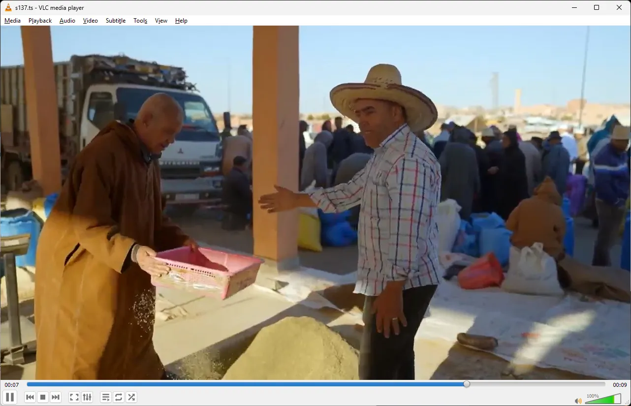

  • I am still figuring this out myself. Probably one mistake is to assume *.ts when I should assume *.gz.
    So to get continuous "off-line" play, rename *.ts to *.gz, open with 7zip, enter "." folder and extract video folder. These will work 100% but for some odd reason, no audio is included. This applies only for large files found in the folders.

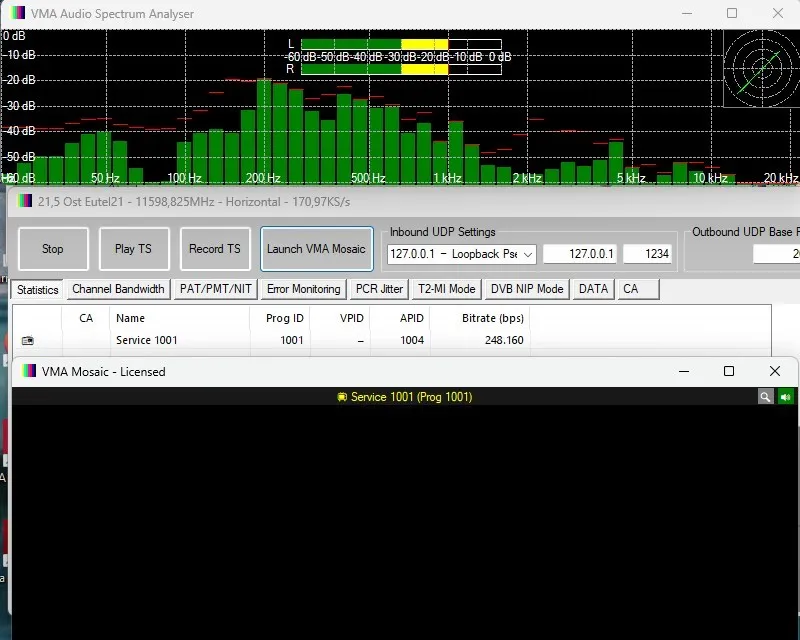

  • Das erste mal , dass ich mit "audio spectrum analyser"
    einen Radiosender mit einem SR von 171 hören kann .:76:( 21,5 Ost 11599 sr 171)
    Bisher war das nicht möglich: Der Transponder wurde zwar gefunden, aber die Statistiken lieferten nie Ergebnisse (bei einer so schwachen SR).

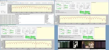

  • Ich glaube, bisher hatten wir bei der Mosaic noch nie so viele FTA-Bilder .
    Es handelt sich nicht um Standbilder, sondern um 20 Fenster mit flüssiger Bewegung,
    einfach großartig.

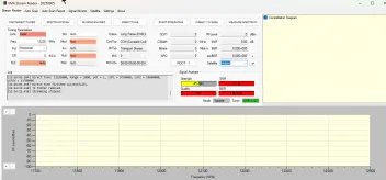

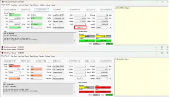

  • Hi VMA,
    I have been wanting to let you know about a problem with the signal on your app for a long time.
    That is, on some transponders, such as 12226 V at 13.0 ° E (there are others), "Blindscan Freq" or "Direct Tune" does not lock the signal even though it is strong.
    I don't know why this is happening. I am providing you with my settings so you can see the bug(?) that I cannot detect.
  • Hi VMA,
    Make sure to choose the correct polarity for the frequency, which is Vertical, not Horizontal.
    Decryption Satellite world
  • Also, make sure to switch PLP off, not ROOT 1.
    I observed that it sometimes switches to ROOT 1, but I am unsure why. Did not have time to follow this up.

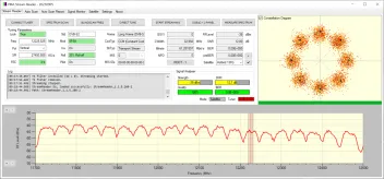

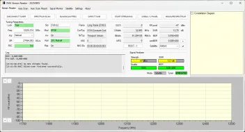

  • Make sure to choose the correct polarity for the frequency, which is Vertical, not Horizontal.
    Here's what happens when you click Blindscan Freq, unlock signal.
    So the problem remains.:25:

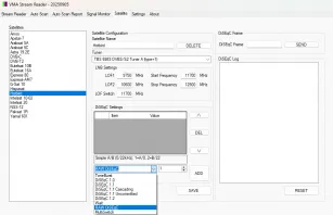

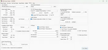

  • I disabled Set pol and BB for Diseqc 1.0/1.1.
    Where should I look for the switch off? In Diseqc Settings?
    I tried several settings; only once did I turn off the signal, but on the second attempt, the same problem occurred.

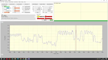

    Here are the same settings at 12380 V and 12226:
  • The signal was eventually locked.
    There is probably a delay on some frequencies when the tuner sees the signal. This shouldn't be the case, especially with a strong signal.
  • Versucht eine andere streamreader.dll zum Beispiel1.2.5.208 (06.06.2025). Selbst mit den schwachen Signalen an meiner T90 funktioniert es.
    An ROOT-1 habe ich nichts geändert.
    Achtet auch darauf, dass nicht Windows Defender mal zwischendurch Unsinn macht.
    Try a different streamreader.dll, for example, 1.2.5.208 (06/06/2025). It works even with the weak signal on my T90.
    I didn't change anything in ROOT-1.
    Also make sure that Windows Defender doesn't do anything stupid every now and then.
