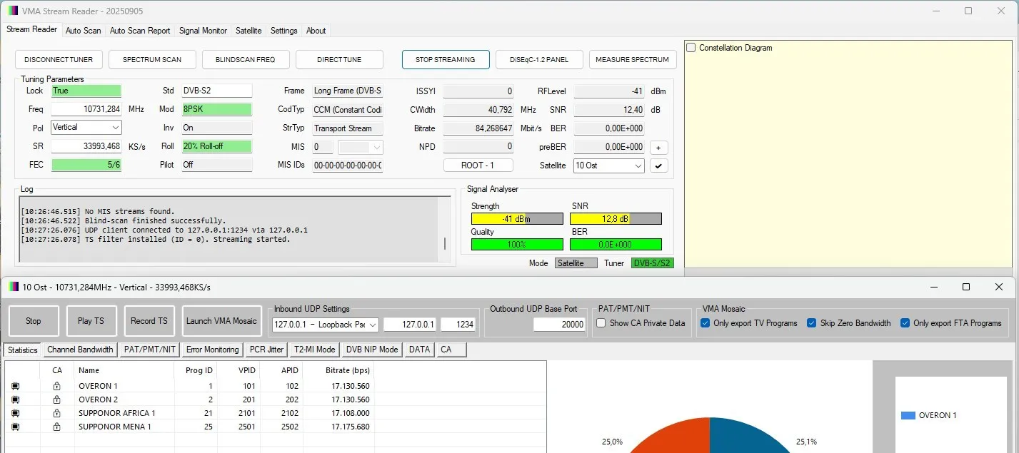

    I am facing a problem with this frequency on the Eutelsat 10 East satellite 10732. The signal is present on other programs and does not appear here. What is wrong?
    Kein Problem bei mir
    No problem for me , on your screenshot there is no SR

  • Das Problem besteht nicht darin, die Frequenzen zu finden (das funktioniert sehr gut), sondern direkt danach, wenn man das Streaming aufruft, tritt das Problem auf. Es werden nicht alle Daten übernommen, die während des Blindscans gefunden wurden (keine Polarisation und SR), sodass es natürlich nicht mehr funktioniert.
  • Vermutlich liegt es daran, dass L gleich H sein müsste
  • You guys are speaking about two different things:
    L/T might be linked wrong to H/V. femi can you please test and confirm?
    10732: After blind scan, is there a lock or not? Is the lock lost after streaming? Please test and explain exactly what you are doing.

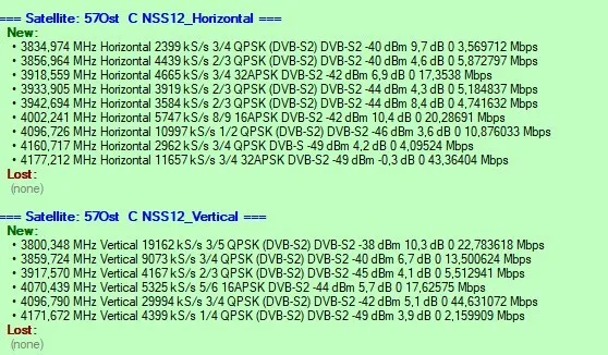

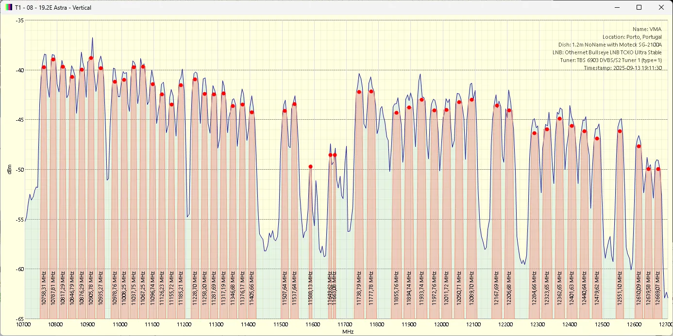

  • A test with the VMA app on a C-band satellite (57.0E) with Circular polarization.
    How can both polarities be scanned so that they appear on the same list and spectrum, rather than separately?
  • that is not possible, by design
    the reason:
    each scan result (per polarity) can be saved and later loaded back
    if you then double click any item on the list (main window), it will blindscan the transponder
    this is a quick alternative to having transponder/channel-lists like you do have in normal tv applications
    as a result, each polarity is handled individually
  • #911:
    all ok, but if you look the spectrums #910 you can see the log in th 2nd scan write "set polarisation to vertikal", thats wrong with circular left. The other's are ok

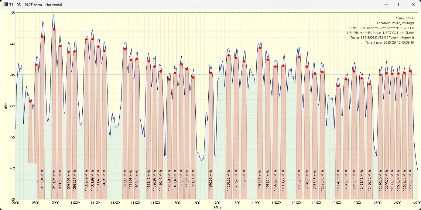

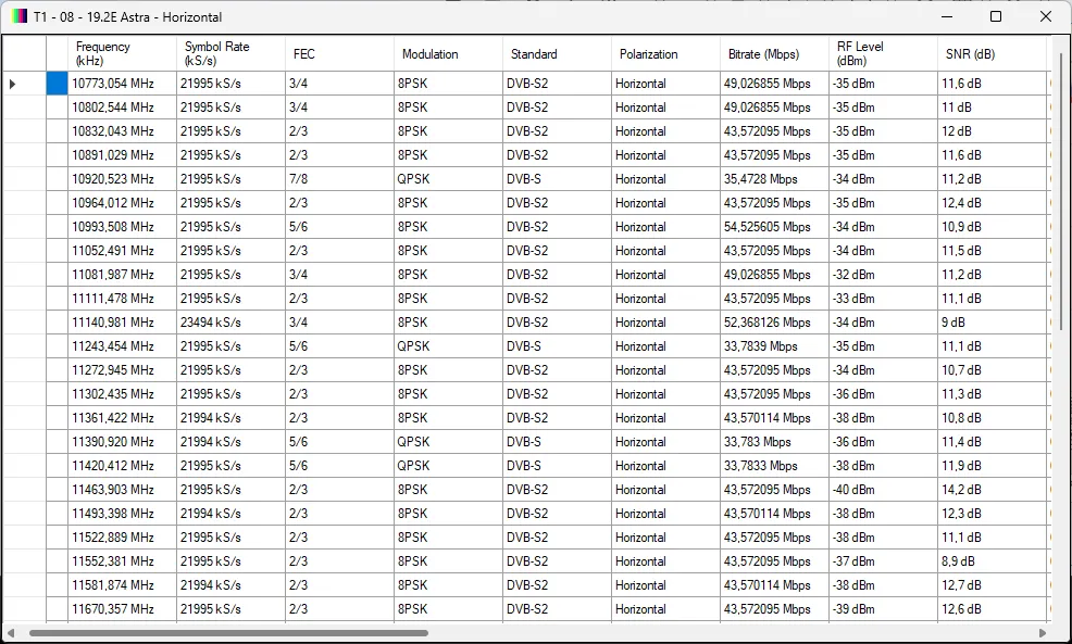

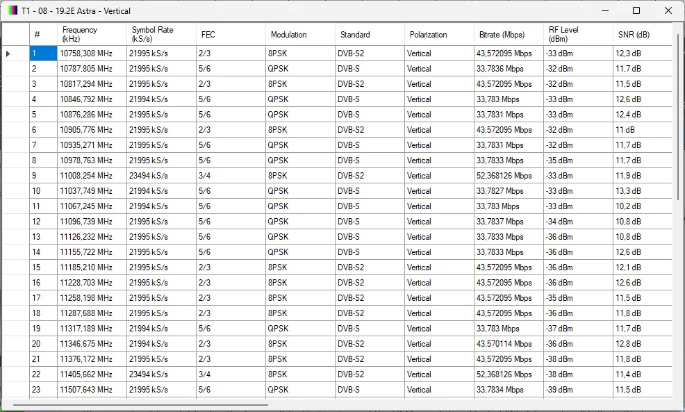

  • Thanks, stephan94, for trying. But that's not what I want. What I want is what I said before: the muxes found and spectra reported on a single list and one graph.
    VMA knows this, but since he designed his app based on EBS, he will be able to find a solution so that, at least during blind scanning, both polarities are scanned and the result is listed with both polarities.
    But he also tells us that it's not possible. Only he can know what is and isn't feasible with his app.
    It's normal not to ask him for the impossible. He has turned the VMA app into a kind of "Christmas tree" full of gifts for us, who never thought that a DVB application would open up so many possibilities.:3:

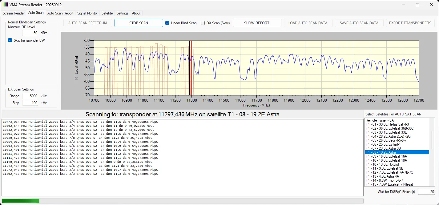

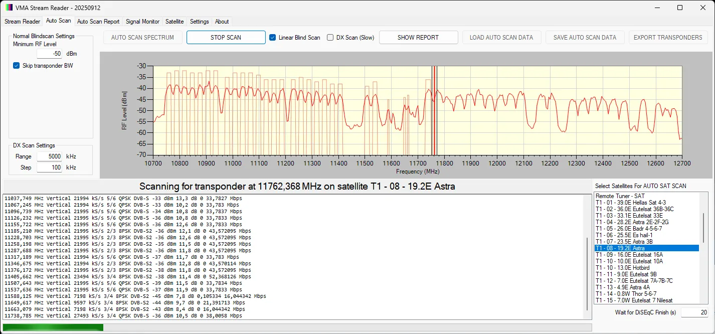

  • If you use AUTOSCAN SATELLITES and only select one satellite, you will get what you want
    But as you can see, the list is reset when vertical polarity is processed:
    And this originates new reports for vertical polarity:
    This is how I designed the software and I am not going to change this - sorry!
    As stephan94 said, you can use Auto Scan Report to see all in one page. Perhaps not exactly what you want, but close...
  • VMA,
    I should have kept quiet, because it was a kind of wishful thinking, understanding that you can't change a house if you already have it on the foundation.
    Thank you. :74:
