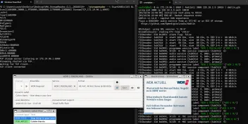

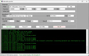

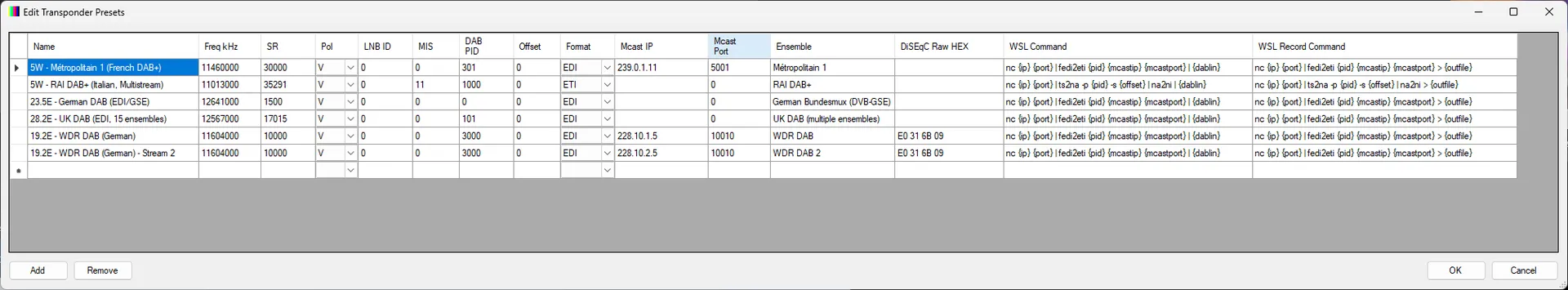

    I build myself a tool called "VMA DAB Launcher".

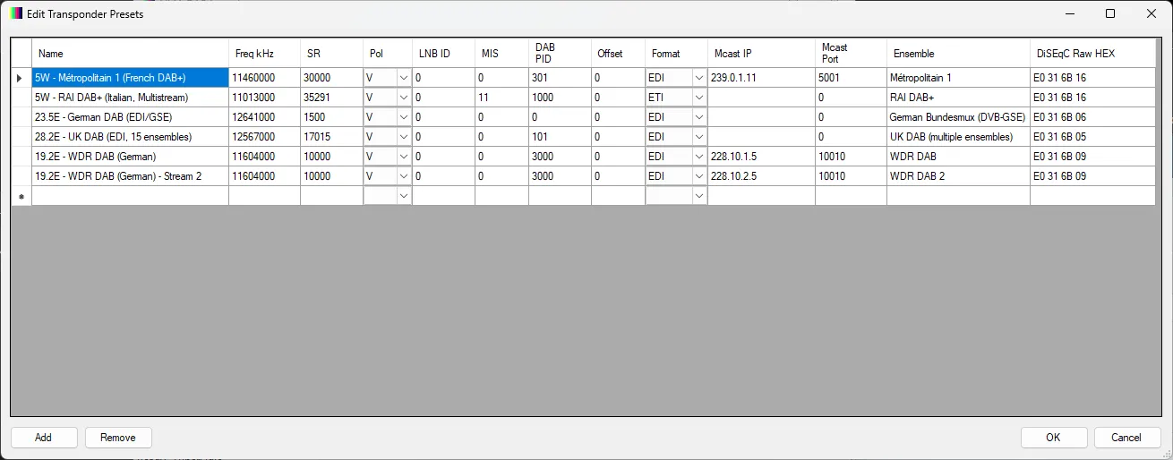

    It allows to configure known transponders carrying DAB services:
    These can then be recalled and started automatically, without having to open CMD shells and typing Linux commands.
    All of this works (except it is hard-coded right now to always use fedi2eti, which might be wrong - perhaps the command line needs to be a column on it's own in the configuration table). The software is self-contained: it issues the required DiSEqC-Commands, tunes and locks the transponder and streams via TCP to WSL and here to nc, fedi2eti and dablin_GTK.

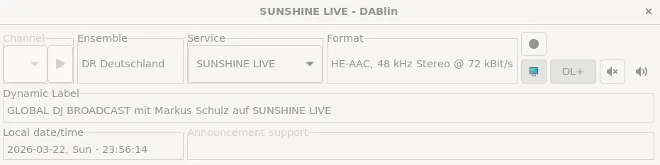

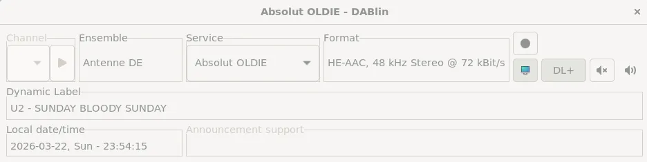

    Hello, for example on 23.5E to listening to a DR Deutchland or Antenne DE DAB+ i had to modify your script
    start "" "%~dp0streamreader.exe" Stop() StopDVB() StartDVBEx(1) BLScanEx(12168000,27500,1,9750000,10600000,11700000,1000000,0) Stream(UDP,172.19.xxx.yyy,1234)
    timeout /t 10 /nobreak >nul
    wsl -d Ubuntu-24.04 bash -lc "tsp -I ip 0.0.0.0:1234 -P ip 239.128.43.43:50043 | fedi2eti 4121 239.128.43.43 50043 | dablin_gtk"
    echo Finished. Press any key to close...
    pause >nul
    wsl -d Ubuntu-24.04 bash -lc "tsp -I ip 0.0.0.0:1234 -P ip 239.128.72.10:50010 | fedi2eti 4122 239.128.72.10 50010 | dablin_gtk"
    pause >nul
    In wsl you should check your active ip adress with command (ip addr show eth0). In WSL I am using the MPEG transport stream processor from TSDuck (tsp), the NetCat is not working on my setup

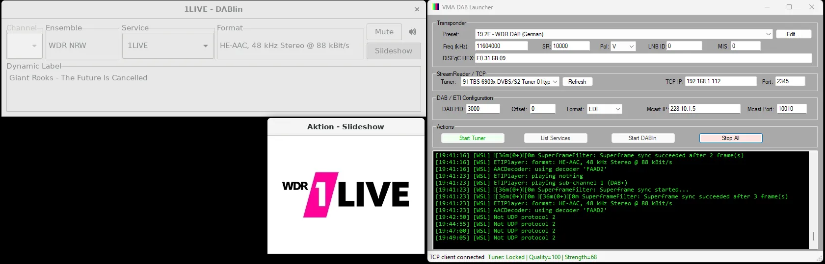

  • This is the new public version: https://vma-broadcast.com/wp-content/upl…%2020260323.zip
    It allows RECORDING DAB or playing via DABlin.
    The Settings allow a complex and versatile configuration of ETI Tools for (hopefully) any case:
    I am satisfied: I can now listen or record ETI files without having to remember the command line syntax for the WSL based Linux shell.

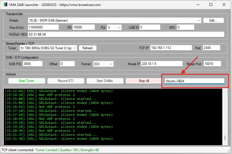

  • Please download the same link again.
    You can now specify your WSL version:
    Where should this be specified in DAB Launcher?
  • I can't tell from the picture where I can enter my version number. There's no place in the Launcher where I can enter it.

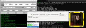

  • After several attempts, I managed to download the correct version, but I'm still getting the same message:
    "Starting DABlin GTK...
    [18:07:17] TS source host: 172.19.96.1:6969
    [18:07:17] WSL cmd: nc 172.19.96.1 6969 | fedi2eti 301 239.0.1.11 5001 | dablin_gtk
    [18:07:17] ERROR launching WSL: The system cannot find the file specified
    [18:07:17] Is WSL installed? Try: wsl --status"

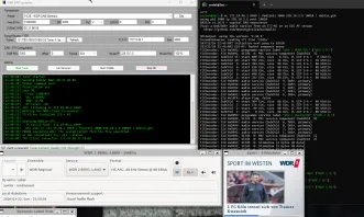

  • After minor modifications on my network configuration between Windows 11 and WSL2, finally the VMA DAB Launcher works well also on TCP port. Good job, thank you Vitor.
