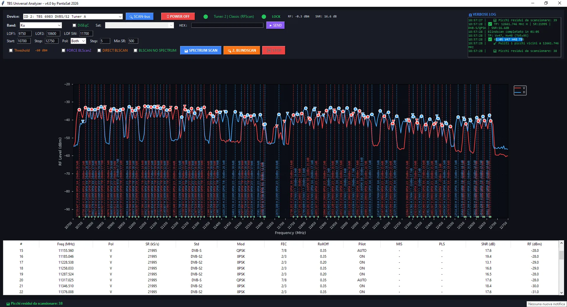

    I developed this software with the goal of fully exploiting the Blind Scan capabilities of TBS tuner cards, both new and legacy generations. The program has been thoroughly tested and optimized directly on a TBS 6983, but its architecture is ready to operate with all models supported by the StreamReader API.
    🔍 WHAT THE SOFTWARE DOES (BLIND SCAN MODES)
    The core strength of this tool is its flexibility in handling different types of Blind Scan depending on your hardware setup and current needs:
    • Blind Scan on Spectrum Peaks (Fast): You run the Spectrum Scan first. The software automatically detects the signal peaks (the "humps") and unlocks the Blind Scan button. At that point, the core launches a targeted BLScanEx routine (with a fixed 15 MHz range) exclusively on the detected peak frequencies. You get a lock and a populated transponder table in just a few seconds.
    • Linear Blind Scan without Spectrum (BLScanEx): If you prefer not to run a preliminary spectrum scan, simply check the BLSCAN NO SPECTRUM box. The system will scan the entire band step-by-step. I have implemented a Smart Skip algorithm: as soon as the card finds and locks a transponder, the software calculates its bandwidth based on the Symbol Rate and automatically skips past it. This prevents wasting time scanning the same carrier repeatedly.
    • Linear BLScan2 Scan (Full): By enabling the FORCE BLScan2 checkbox, the software executes the native segmented search (Low Band and High Band), tightening lock times across the entire band.
    ⚙️ HARDWARE COMPATIBILITY & TESTING
    • TBS 6983 and Classic Cards: This is the exact hardware used for all development testing, where the optimization routines (scan speed and skip handling) deliver their maximum performance.
    • TBS Series-X (6903x, 6909x, etc.): The software is fully prepared to work with these next-gen cards (utilizing FFTScan for ultra-fast spectrums). However, since I do not physically own any of these cards to run direct hardware tests, the results with Series-X will likely be the same as what you would get with other software currently in circulation. Without having the actual hardware on hand, this was the best I could do.
    📺 SIGNAL ANALYZER & LIVE TELEMETRY

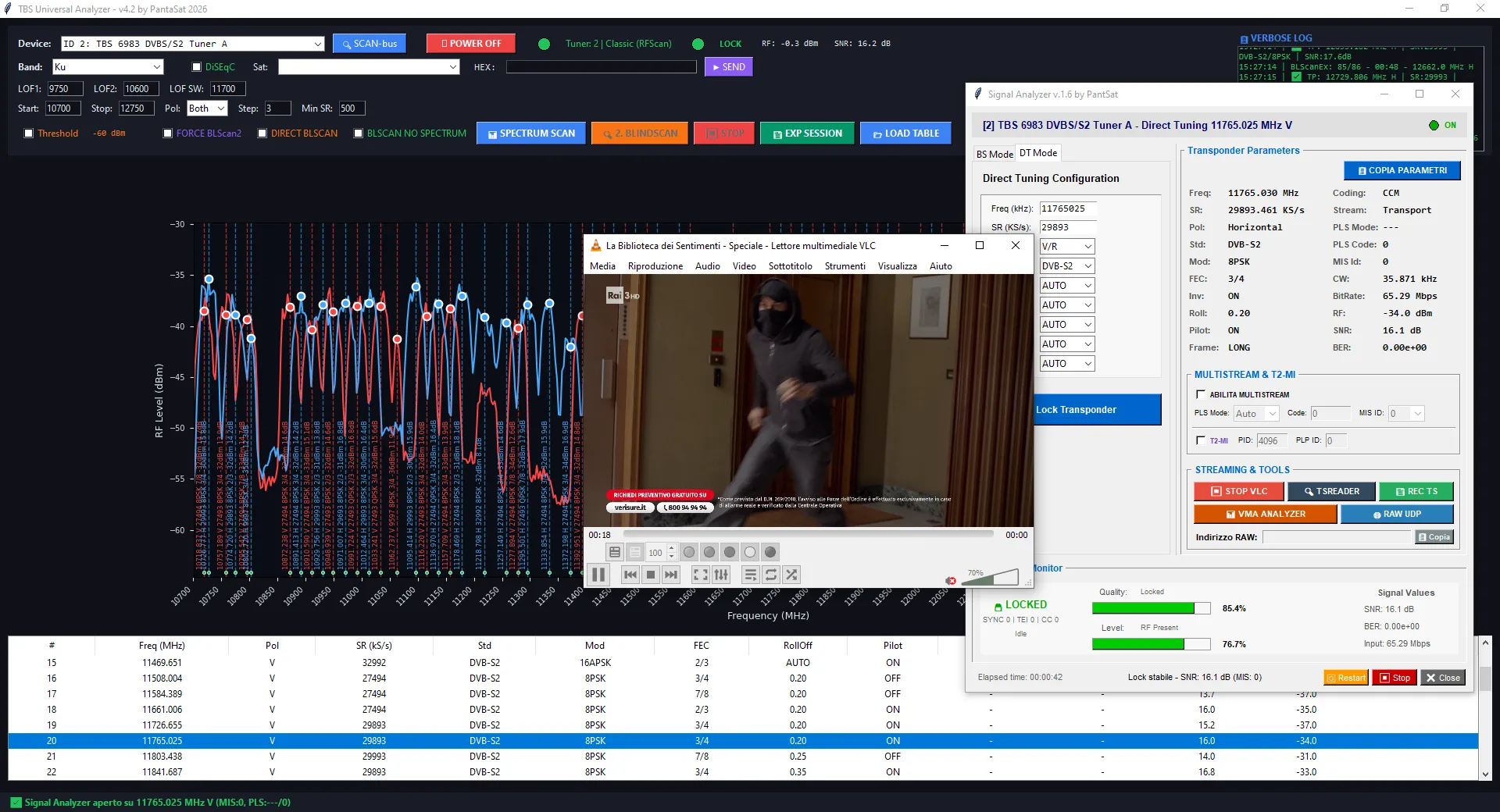

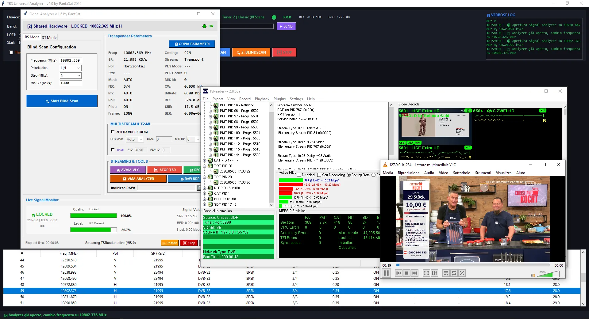

    Double-clicking any transponder found in the table opens the built-in Signal Analyzer module. It operates as a single process sharing RAM with the main GUI, ensuring no double-tuning conflicts or interface freezes:
    • Ghost Lock Elimination: The demodulator is fully cleared on every frequency change to prevent the analyzer from staying anchored to the previous frequency.
    • Real PLS Management: Full support for selecting PLS codes and modes (Auto, Root, Gold, Combo).
    • Carrier Anchoring: The software forces a hardware lock (flag 0xFF) to stabilize the signal even before launching any external players.
    • Streaming & Process Watcher: Instant streaming output to VLC, TSReader, RAW UDP, or VMA Analyzer. The software checks every 3 seconds if the external player has been closed, immediately freeing up the tuner card without locking up the interface.

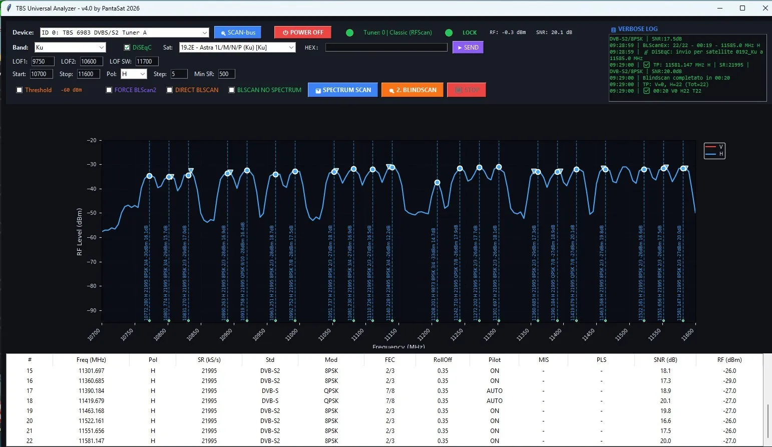

  • PantaSat explained above the purpose of TBS Universal Analyses. These are TBS cards from a Chinese manufacturer that are fully or partially supported by the CrazyCat library.
    But because PantaSat wanted to take advantage of the blind-scan capabilities of TBS cards, he developed this app specifically for that purpose, making it a standalone application with features and functions implemented similarly to those of Frequency Tester.
    I tested several of these TBS cards that I already have installed, with different models and capabilities. The first one I checked was a Stid135, 6909x card, which could not be scanned with the Frequency Tester Suite version, even though it is part of that suite.

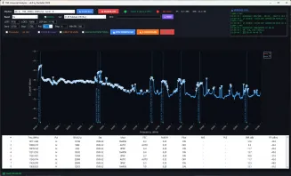

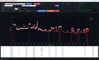

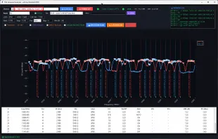

    I (blind) scanned part of the band at 19.2E with the 6909x using Universal Analyses, without enabling the Force BLScan2 function, because the app detected it as an FFT card.
    The scanning time with this type of card is the same and performs largely as with Crazyscan, though it depends on the steps and signal strength. In addition, it has a feature I haven’t found in any other DVB app: the ability to force the signal to lock it with BLScan2, which I used for the tested cards.
    The idea of a Signal Analysis utility in the Universal app is a good and necessary one. I say this because instantly checking a mux directly from the transponder list is a must for any user.

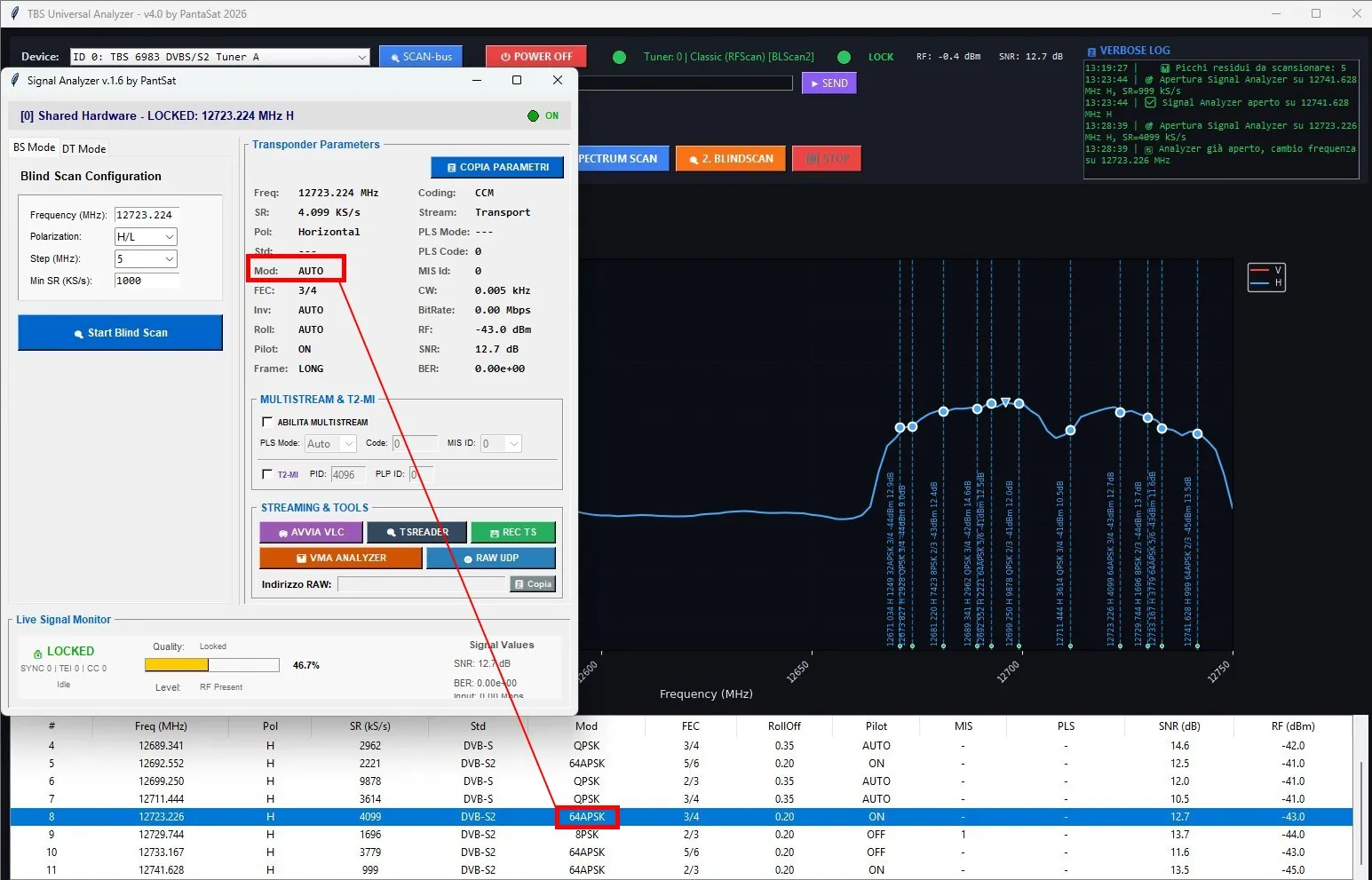

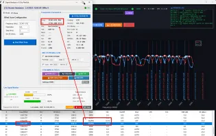

  • Wirklich ein sehr gutes Programm.
    Kleine Anmerkung:
    Wenn der Modus auf „Auto“ steht oder nicht gefunden wird, wird 64APSK angezeigt (Satesco hat das bereits erwähnt, allerdings in Bezug auf die Frequenz).
    Im Moment finde ich keine Frequenzen mit niedrigem SR.
    It really is a very good programme.
    Just a quick note:
    when the mode is set to ‘Auto’ or cannot be detected ,it displays 64APSK (Satesco has already pointed this out, but in relation to the frequency).
    At the moment, I can’t seem to find any frequencies with a low SR.

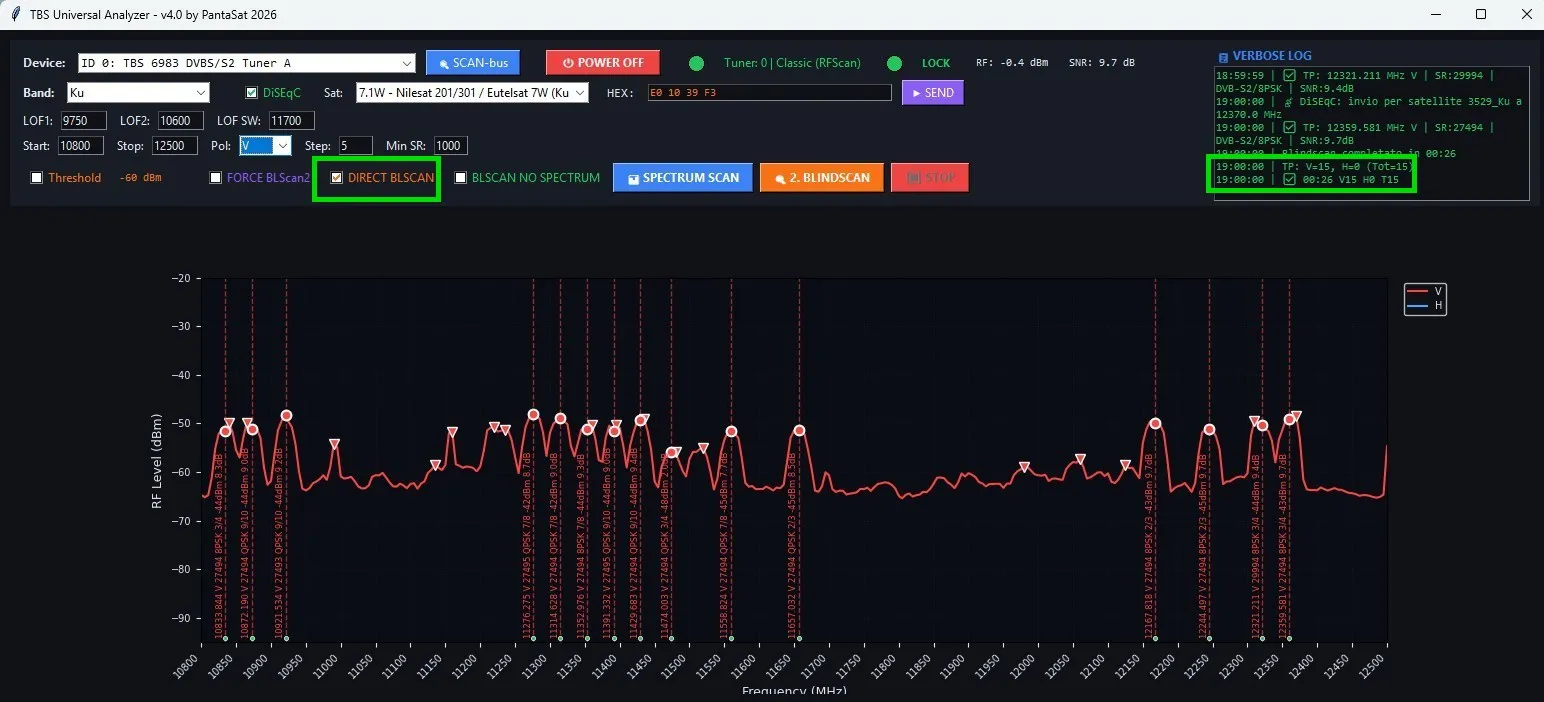

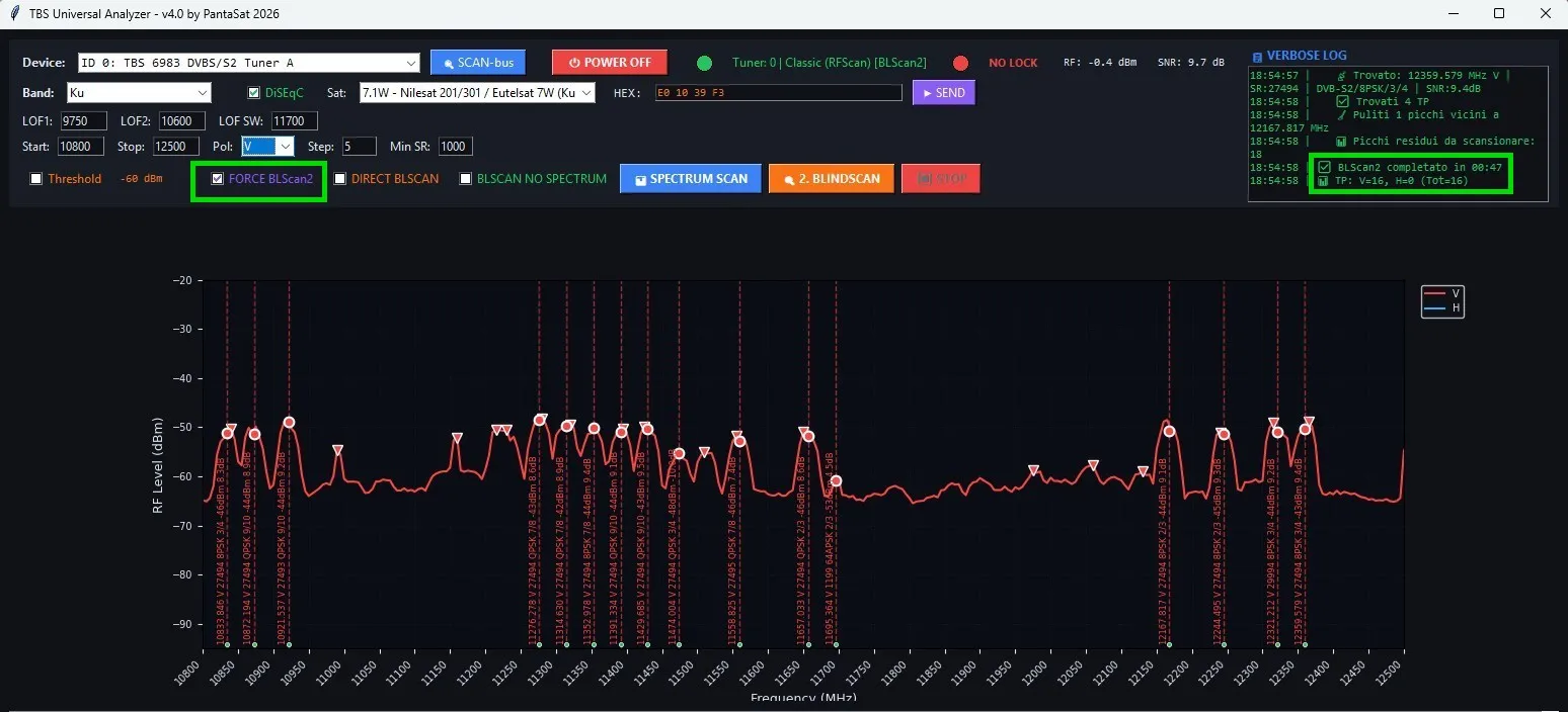

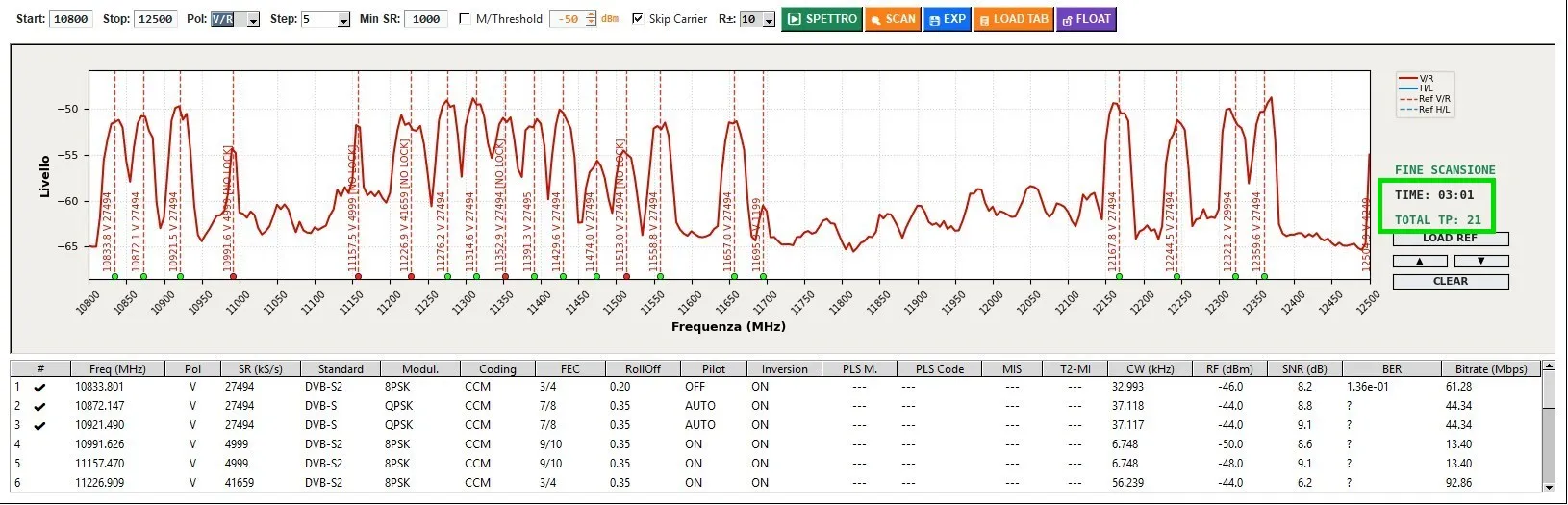

  • Since it’s now possible to perform a blind scan(auto) with the TBS Universal Analyser app on the 6909x card, I decided to compare (it's a must) the results with Crazyscan at 21.6E, a position where I receive signals from both the eastern and western beams, which have different signal strengths in my area.
  • Perhaps a comparison test with an STV091X-based card (6983/69093, 5927)—which many users have—using the Crazyscan app and TBS Universal Analyser, also at 21.6E, would be more relevant. I used the Blindscan2 feature in both apps for the scan.
    As I expected, CrazyCat seems to have outdone himself with his app by implementing BLScan2 (do you remember when he asked us back in 2015, if my memory serves me right?), especially if we want it to find muxes that can’t be locked!
    After I enabled BLScan2, I recall the signal strength seemed to have improved slightly, making this STV091X-based card the best-performing one on the market for DVB-S2 reception! No other card or model can match it in this category!!!
    In the PantaSat app, I enabled "Force BLscan2," which gave the best results compared to the others—Direct BLscan, Threshold, and BLScan No Spectrum.
    However, PantaSat’s FeedScanner Suite app, with the BLScan2 (no lock) feature enabled, achieves the same performance with the tbs6983 card as Carzyscan does
    But instead of adjectives or superlatives, it would be better for other users to scan and compare the PantaSat app with Crazycat’s app using these cards.

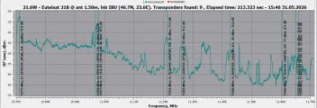

  • Subject: Request for streamreader.log from your 21.6°E test / Updates on Signal Analyzer
    Hi satesco,
    First of all, thanks for sharing your test results at 21.6°E comparing Crazyscan and the TBS Universal Analyser on the 6909x!
    Looking at your results, I noticed some anomalies and longer scanning times than expected. To clearly understand what is happening under the hood, could you post or send me both the streamreader.log from the CrazyScan session and the one generated by my TBS Universal Analyser during that same test at 21.6°E?
    I want to compare them line by line. I strongly suspect that my software might be sending incorrect or redundant commands to the DLL... which wouldn't be too surprising, given that I am navigating completely in the dark with these APIs! I want to check if the longer scan times depend on an overload of requests or some loop in the hardware resets. Your logs would be a massive help to get the code back on track.
    I also want to let everyone know that I am currently reworking and applying fixes to the Signal Analyzer. I realized that, although it was working, it wasn't working properly yet. I think you have all figured it out by now: when I do things, I like to do them right, if I can.
    Best regards, PantaSat

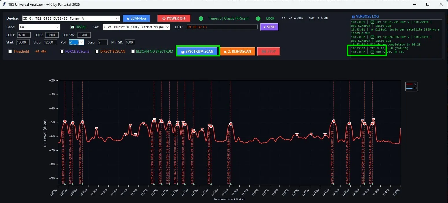

  • Here are some comparative results for Nilesat (7W)

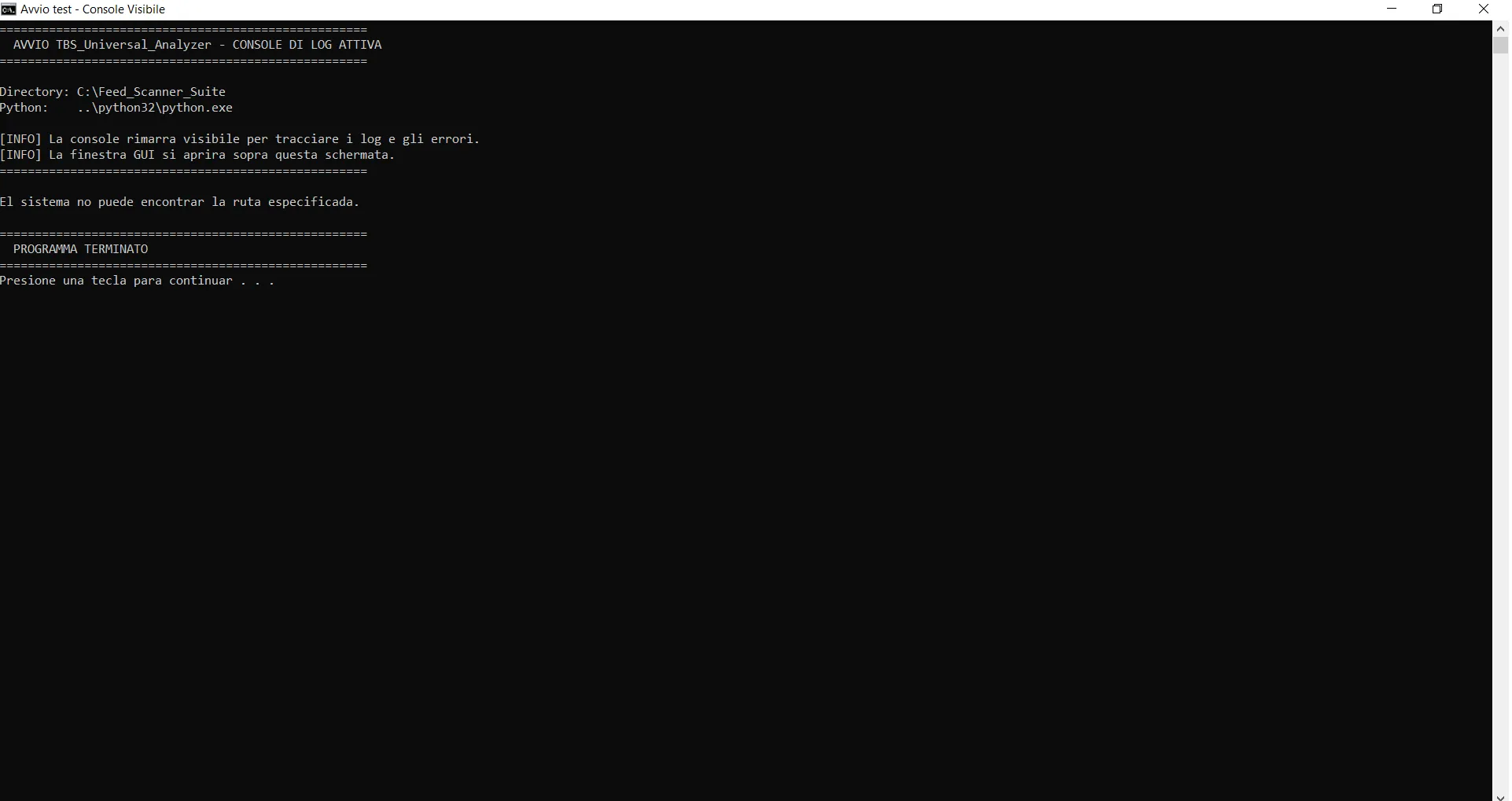

  • Thank you so much for your great work. I can't get this program to run; it just closes when I start it.
    I think the directory C:\Feed_Scanner_Suite is correct

    Hi! To install and run the program correctly, just placing the executable in the directory isn't enough; you need all the other required component files. Please follow these steps:
    1. Read the guide: First of all, carefully read the detailed explanations available in this forum post: 👉 Feedscanner Suite Guide
    2. Download the complete package: Download the ZIP archive containing all the necessary base files from this link: 👉 Download Feed_Scanner_Suite.zip
    3. Installation and Paths: Once the complete package is extracted, please remember that all the apps created by me must be installed inside that folder. For this specific software, it must be located exactly in this directory path on your PC: 📁 C:\Feed_Scanner_Suite\TBS_Universal_Analyzer_4.0
    4. DiSEqC Configuration: If you need to configure your DiSEqC switches, you can find the instructions in that same guide post. Alternatively, feel free to ask here about what you're struggling with, and some fellow users will guide you step by step!
      PantaSat

    Thank you so much for the quick guide and for the excellent work. I'm impressed and eager to try all the options. Best regards.

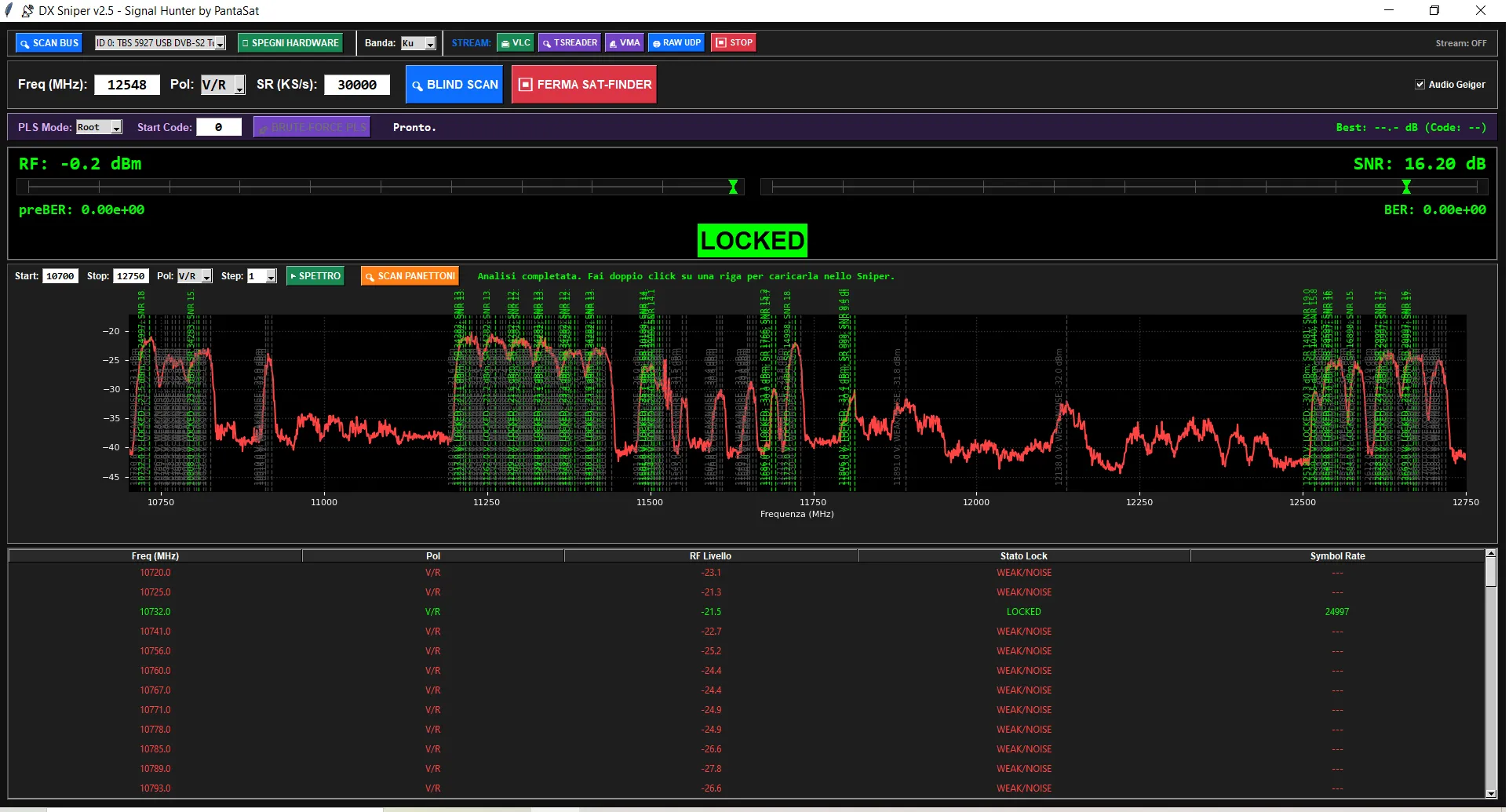

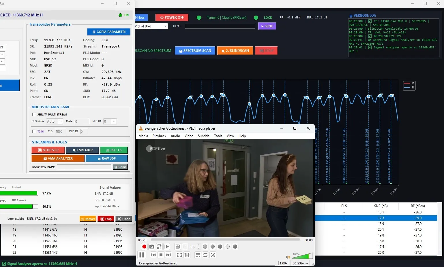

  • Has anyone tested, if the app works with the TBS 5925 usb card?
    It works quite well in all options; here's a screenshot from DXSniper on the Hispasat 30w satellite.

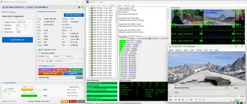

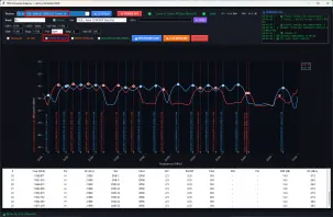

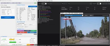

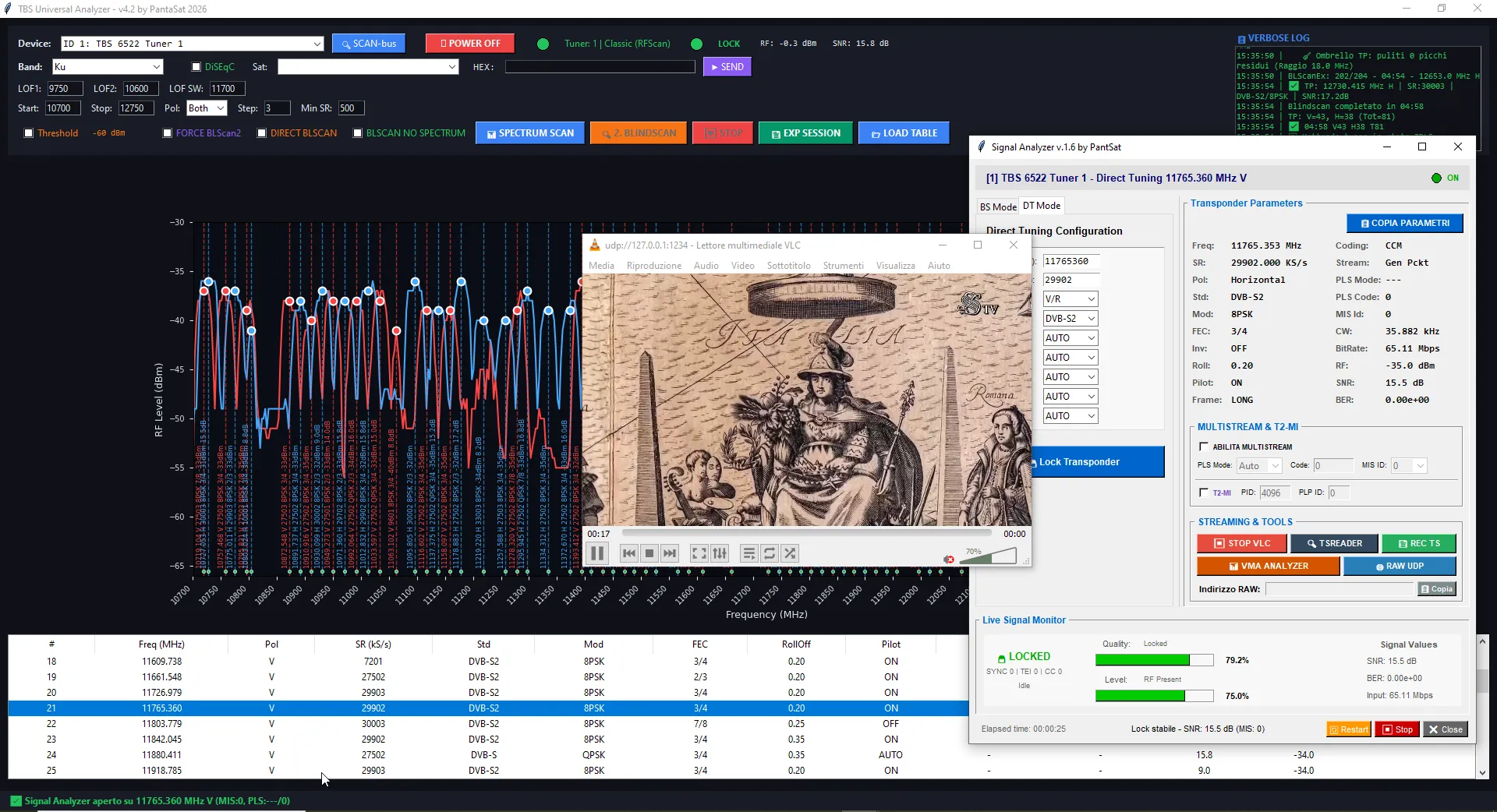

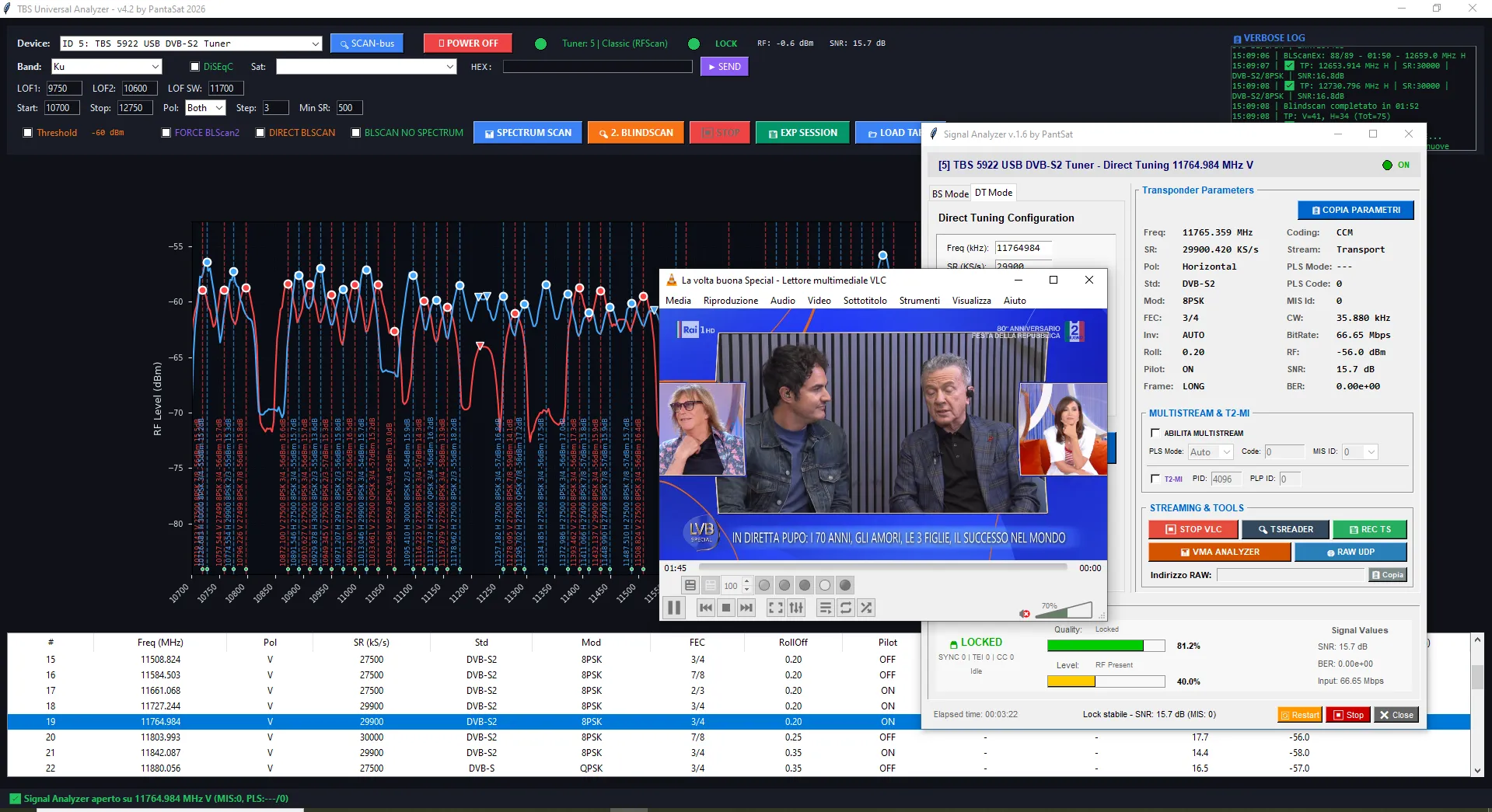

  • TBS Universal Analyzer v4.2 – Spectrum Optimization and Compatibility Testing
    I am currently working on version 4.2 of the software. The main goal of this update is to optimize spectrum generation and improve peak detection, including the introduction of manual thresholding to filter out noise ripple.
    I have completed full compatibility testing with the demodulator functions for the four cards I currently own
    Below are the screenshots of the actual signal lock for each card:
    TBS 6522

    TBS 5922
