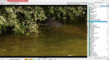

    Although the 5927se driver is incomplete for Windows, I've run a few tests that look promising. We still need to wait until we can use DVB applications on this tuner.
    It’s a pity that the StreamReader file cannot yet be used in established applications; only DVB players can be used.

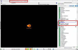

    On Linux, the situation is better for the 5927se, and expectations may be met once Deeptho’s driver – which does not yet exist – can be installed for the neumoDVB app, instead of the TBS driver. I carried out an initial test with a symbol rate of 666 on 11465 H at 5.0 W, or with the RAI DAB streamer on 12564 V.

    Here’s a lower symbol rate: 11481 H, 542, 1/2-radio Nostalgie on Ubuntu 24.04.

    Without Crazycat’s StreamReader file, I couldn't test many applications, including CrazyScan. I limited myself to the TSReader, TBS Blindscan utility and a few DVB players, particularly AltDVB.
    I’d also add that I think the driver for this device still needs some fine-tuning. And that’s hardly surprising, as I’m working with an early version of the driver.
    Even without these DVB tools – the ones we’ve been using for existing cards for a long time (I assume you’re familiar with them) – the tests I’ve carried out with the 5927Se are promising.
    One example would be locking onto muxes with a low symbol rate. I managed to lock onto symbol rates of 542 and 666 at 5.0 W on both Windows and Linux. I also tested 16-APSK and 32-APSK modes with no problems. DAB streams also play on Linux.
    I hope a developer will take the time to draw inspiration from the StreamReader file and make it usable for many DVB applications. For now, this is the only thing missing: a library similar to CrazyCat’s, so the 5927’s potential can be fully utilised, as with established cards.
    A few aspects of this tuner’s driver still need fine-tuning. I hope we’ll discover as soon as possible what this device can do once we have a fully optimised driver and the StreamReader file, which is the backbone, so to speak, of many DVB applications. For now, I’m exploring it step by step.
