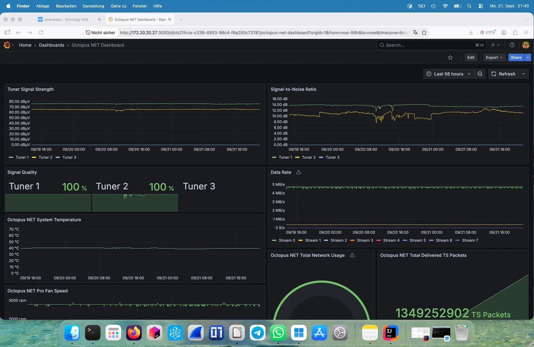

    But I do have a screenshot of a Grafana dashboard that shows an example of metrics collected by the octonet-exporter program:
    In this example screenshot, I had my Octopus NET's Tuner 1 on 19,2°E/12460/H (green line) and Tuner 2 on 19,2°E/11604/V (yellow line). One can clearly see that the weather at my home wasn't very good on the 20.9. around 09:00-12:00. 😁
