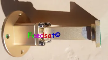

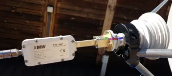

  • Not a LNB but a professional adapter KU/KA Channel Master Feeedhorn (especially built for this one), silver inside, 1.5 to 2 dB gain Versus regular XMW feed, I will done more acurate tests later this winter I think.
    Picture just to show the assembly
    That is very interesting. Does the beam width of the feed remain the same for Ka compared to Ku? I have a Prodelin Ka 1.2m dish and a Ku 0.8 f/d feed but can not find a reasonably priced Ka 0.8 f/d feed.

    It has been created especially for this Antenna and this feedhorn
  • The answer (copy/paste):
    Feed beam width is related to frequency . From Ku to Ka it changes much . Ka Prodelin dishes require very expensive Prodelin feed. 1000 Euro or so.
  • The frequency - beam width relationship made me wonder what the beamwidth of your Ku on Ka feed would do. If it has narrowed the width it would be useful for the Prodelin.
    1000 Euro - eek. I thought it may be expensive but.... The dish, mount and LNBs only cost 10% of that!

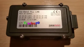

  • My new toys for Band A, B and C. Testing them, when I´m not so lazy next...
    Thanks for sharing this collection with us.
    Nonetheless, from my point of view, it would be more interesting as a Dxer we are, to see some of your test report between each of LNBs, and the difference of the values, C/N, SNR, MER between the various feedhorn used, etc
