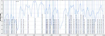

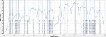

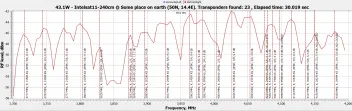

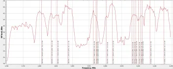

Here's my scan of 8W from today. Note - the polarization is swapped! Also attached a picture of how the LNB is installed.
