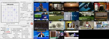

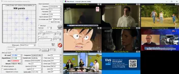

It works in "manual work"... using CrazyScan and tuning in (for example here) MIS 171 and stream to file, than open VMA Transport Stream Analyzer and play TS, after that activate T2-MI Mode and set the correct paramter settings (here: PID 4097 and PLP 0) and launch new Transport Stream Analyzer. After all you can launch VMA Mosic.

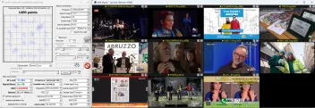

I have (personal) probs when using VMA Stream Reader, because I didn´t see MIS 171, MIS 173 and MIS 174 - only "MIS 3" appeared,
so I can´t choose MIS 171 for example....?It works in "manual work"... using CrazyScan and tuning in (for example here) MIS 171 and stream to file, than open VMA Transport Stream Analyzer and play TS, after that activate T2-MI Mode and set the correct paramter settings (here: PID 4097 and PLP 0) and launch new Transport Stream Analyzer. After all you can launch VMA Mosic.
Probably new here...

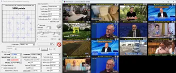

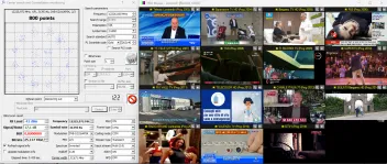

3732 L 40416 2/3 DVB-S2 8PSK, T2-MI
MIS 171 and PLP 0
MIS 173 and PLP 2
PS: [MIS 174 and APid 2003/APid 2004/APid 2005 - ID: FM Radios]
...can´t remember these parameter for ASBU feed here in the last 5 years...
PS: Signal de-creased later rapidly...

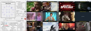

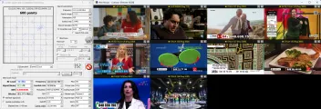

11146 V 2500 3/4 DVB-S2 8PSK -
11074 V 3000 3/4 DVB-S

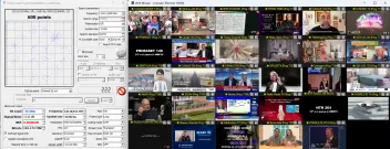

Just my signal on 1.2m in VERTICAL range for:
13507 V 30000 2/3 DVB-S2 16APSK
13545 V 34280 2/3 DVB-S2 8PSK -
11074 V 3000 3/4 DVB-S...

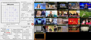

11127 V 2200 8PSK 5/6 ID: IMN.POOL
11663V 3330 2/3 8PSK
