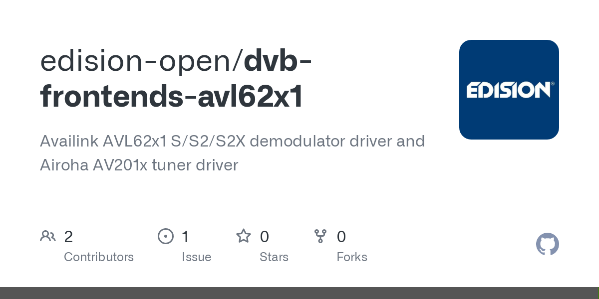

Are you still trying receive 10492H with osmio? Tested OpenAtv7.3 and modified driver works there too.
You need to change few lines in the driver, see attached diff. Don't edit other files in Enigma2. Only new .ko file and reboot.
Also large dish is not needed, it works here even with 1m Triax.
If it still doesn't work, maybe problem is the LNB. I use Inverto black ultra.
Hm, kein Glück heute
Haven't tested blindscan. Try tuning 10492H SR1500 manually. (I only use OpenVix)
Line 1111 should be adjusted, is it enough to go down from 950MHz to 900MHz?
Not at home right now, but 10492 was something like 742MHz if I remember correctly. I used 700.
Also you need to modify other file av201x.c same way, or it won't work.
is this change only for avl6261 tuners or ?
I'm afraid so, unless you have source for them. Also that github has not been updated for 2 years, but it still works. If anyone tries to build, use Ubuntu 20.04, driver did not build in Ubuntu 22.04 (new gcc I guess)

Does that mean that the tuner itself can do this and only the frontend.cpp is adapted and enigma2 has to be recompiled with it?
Can you go into a little more detail and describe the procedure?
No enigma2 changes are needed. Only tuner driver avl6261.ko needs to be modified. Driver source and build instructions are in github.
