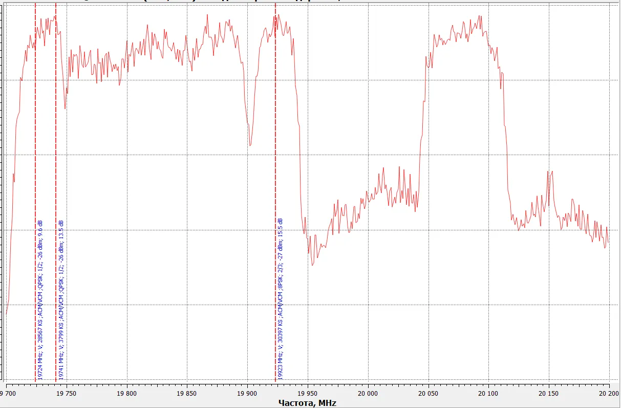

qwer any signal changes for you at lower bands? 10950-11200 and 11450-11700 ?

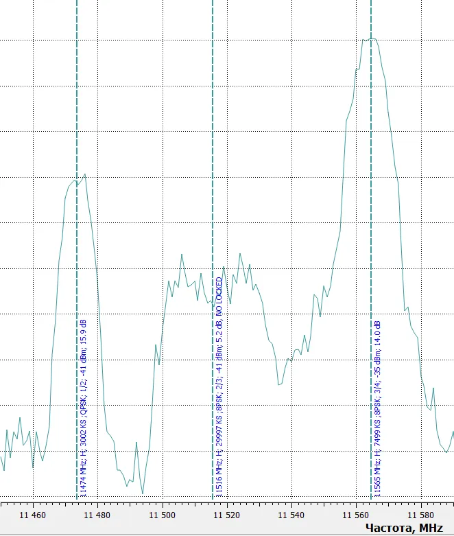

qwer wonder why you can't view 12303V... See my spectrum above.
with its parameters changed, to 11588 V, 20200, 3/4, 8PSK.

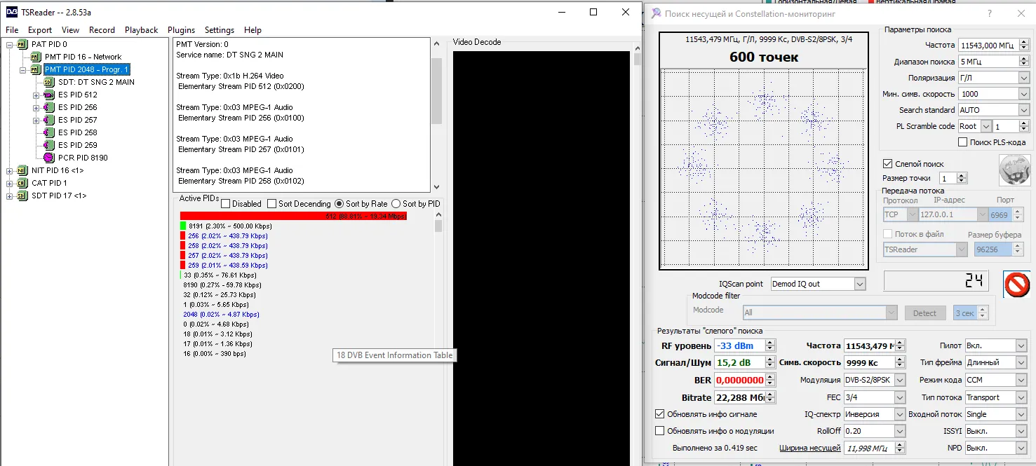

11366 V, 6400, 3/4, 32APSK-GS, new.
