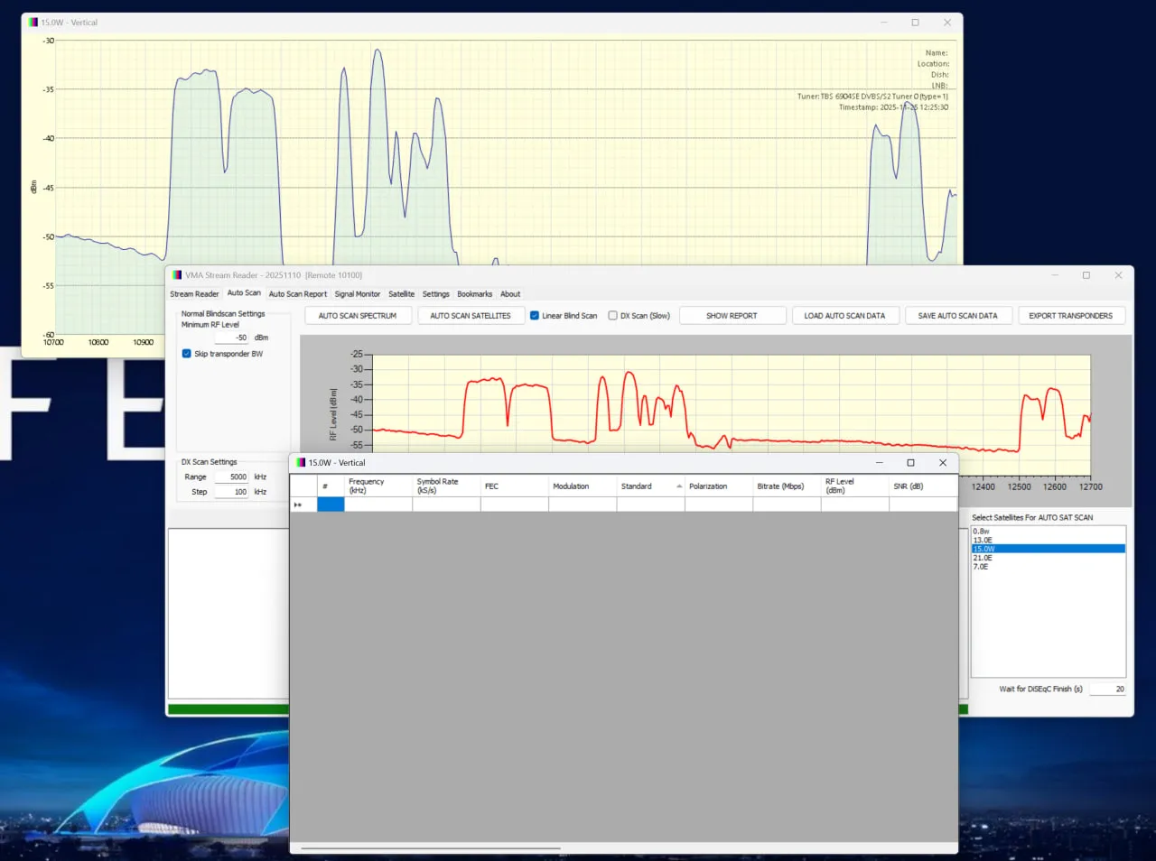

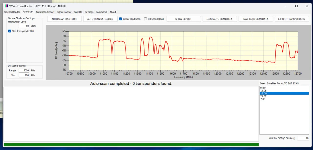

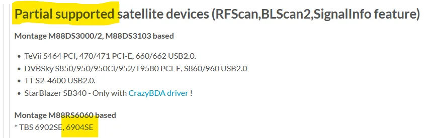

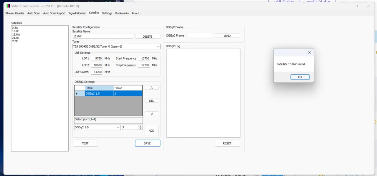

My dear friend, I have two cards. The first is the TBS6904SE; the spectrum works well on it, but it doesn't display the frequencies. The other card is the TBS5927; the spectrum and frequencies display perfectly normally, just like with other programs such as EBSpro and others.
Solution to what problem?
Please explain what is the problem!
The problem is that it doesn't get the frequencies in the Blscan process on my TBS6904SE card.
I hope you find a solution as soon as possible, my dear friend. Best regards.

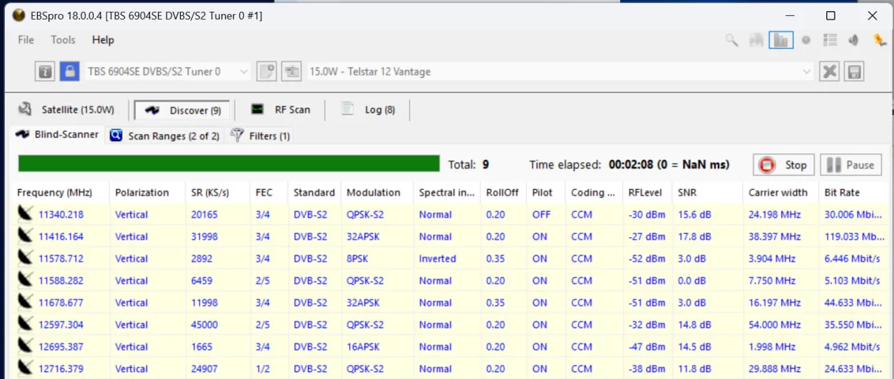

EBSpro simply does not show a log with all tried frequencies.

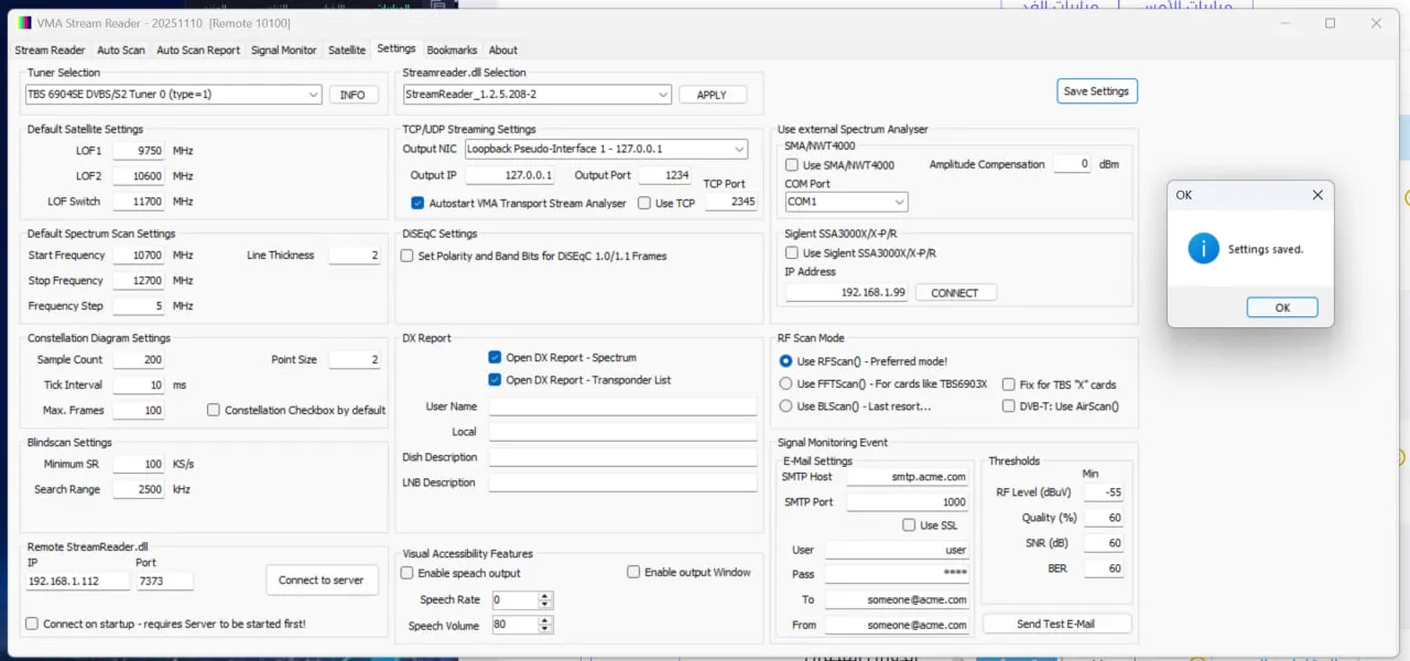

@All: CrazyScan/EBSpro/IQmonitor/VMA Stream Reader all use Crazy Cat's streamreader.dll. The results os RFScan(), BLScan(), FFTScan() are ALWAYS THE SAME in any of the software used. If the results are different, it is because you are using different versions of streamreader.dll or different configuration of streamreader.ini.

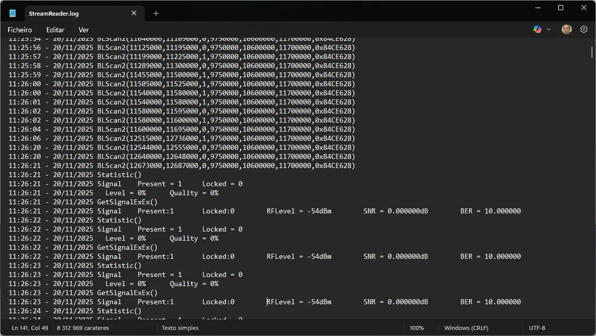

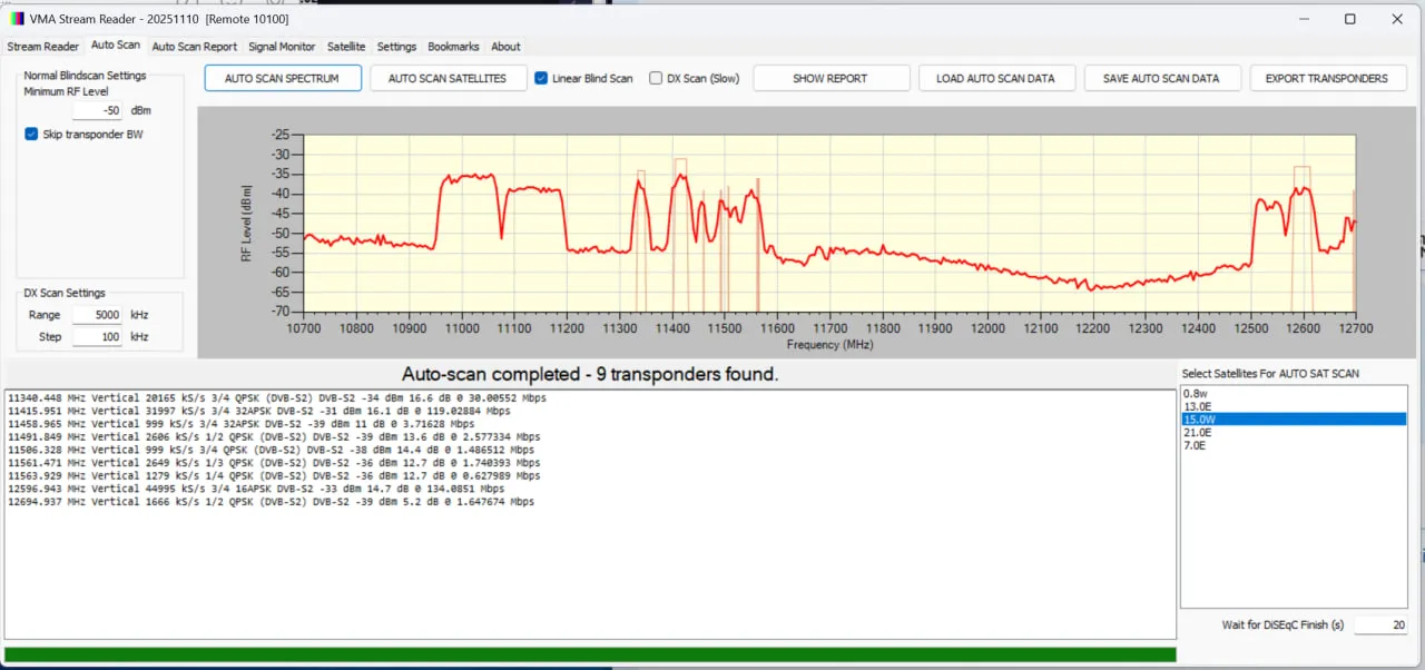

In VMA Stream Reader a log shows everything that has been done, so if Auto Scan tries all frequencies, you will see many BLScan() results that did not lock. I have not tried, but did you look at the Log tab in EBSpro? Doesn't it list the same kind of information?
This is Log tab in EBSpro VMA
https://www.mediafire.com/file/4zcm4z9l6…Reader.log/file -
It means that BLScan() was unable to lock to any transponder in the selected frequency.
When you do an Auto Scan, all frequencies are scanned sequentially at the programmed frequency step.
Example:
10770
10775
10780
...So for some/many frequencies, BLScan() will not find any lockable transponder.

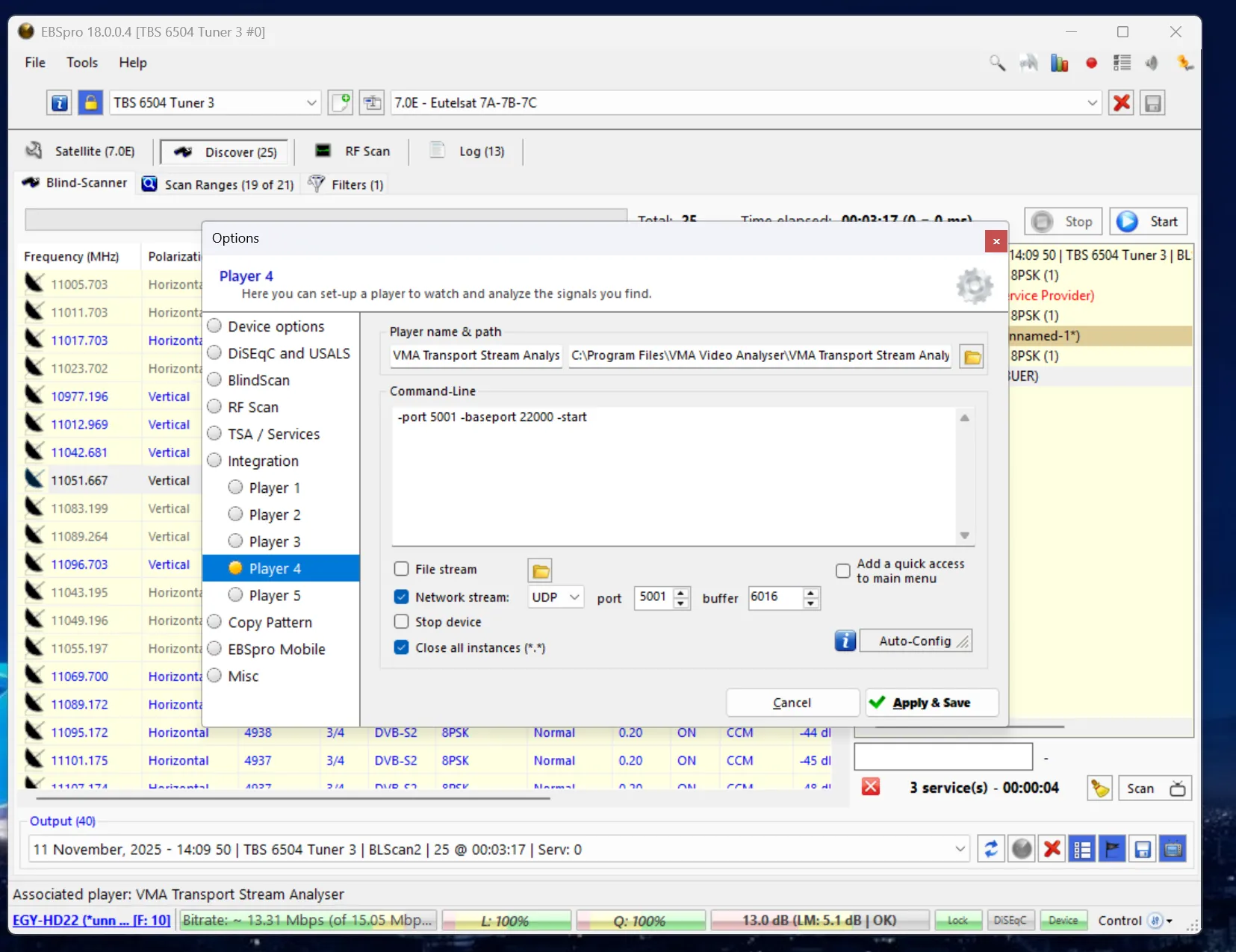

However, the EBSpro software works normally on the same TBS6904SE card.

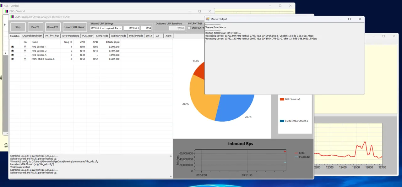

The macro saves all data in c:\satellites - you must fteat this folder first.
Yes,the macro feature doesn't work for me either in newer versions.
