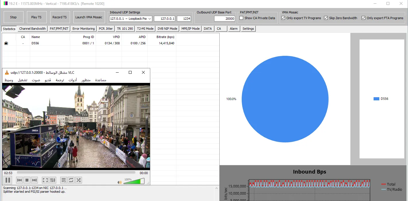

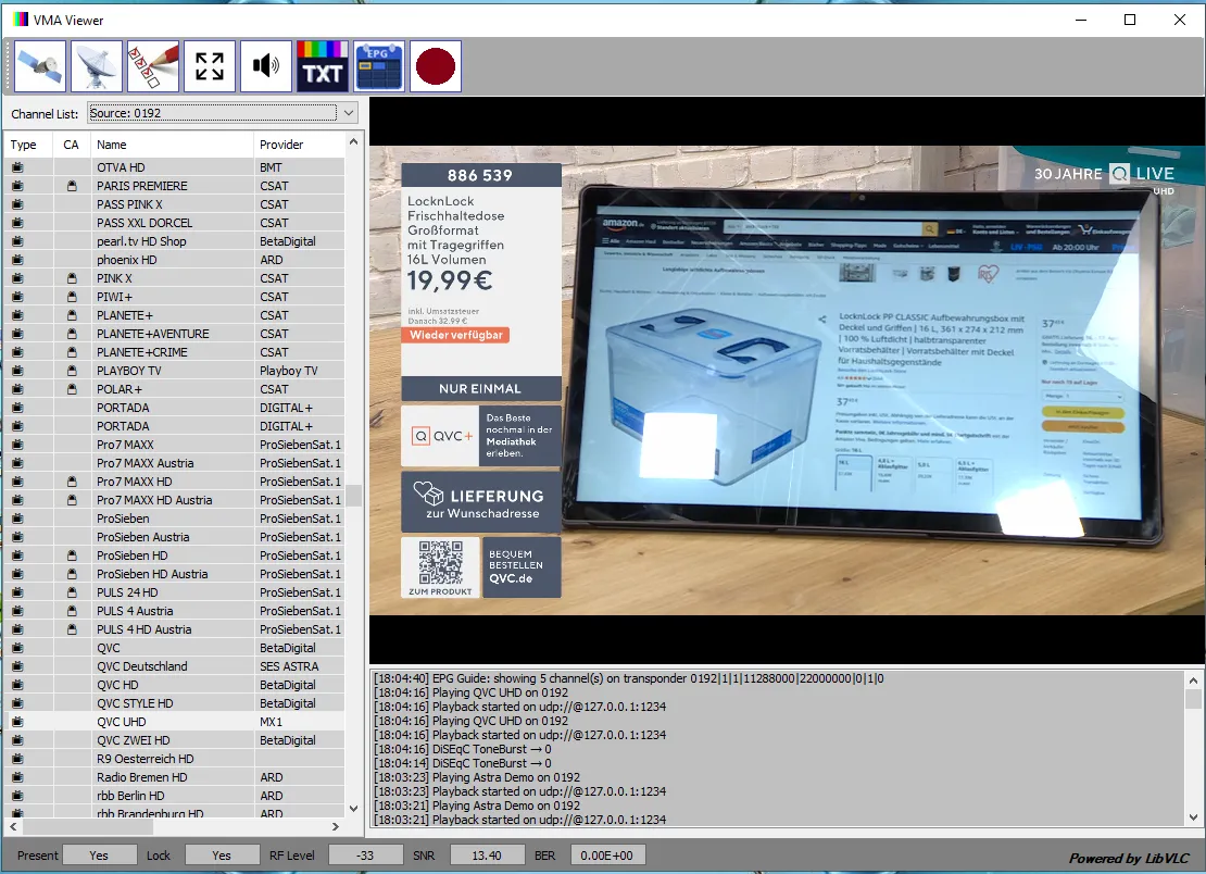

Display MoreI tested the VLC player on Windows 11 on cable and terrestrial frequencies, and I was able to scan and view.
The settings for these standards are the same as what I did with VLC under Linux, posted previously.I used the 6590 card for C/T scanning.
For now, I haven't been able to scan satellite frequencies with VLC for reasons that escape me at the moment.
I will try again, and if I succeed, I will post the results here.

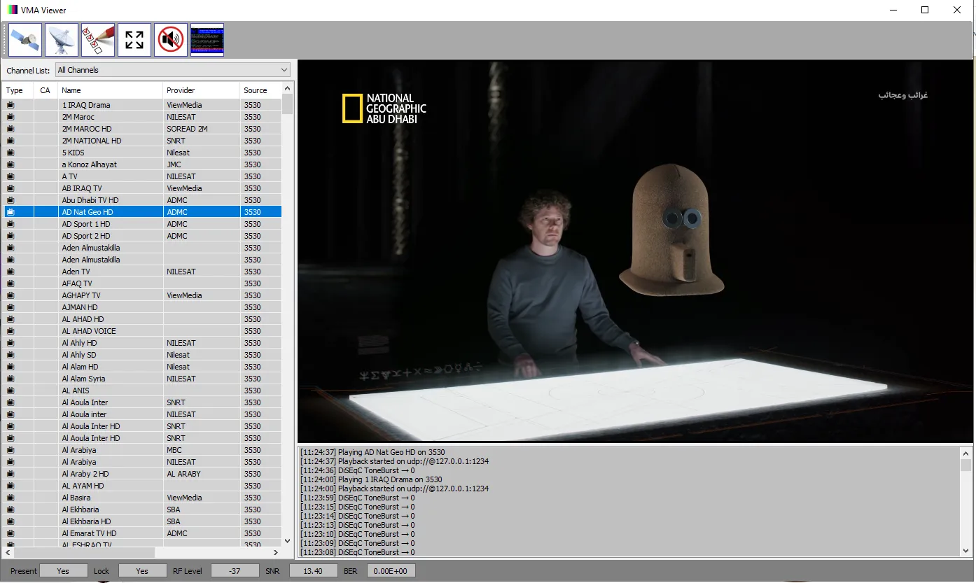

Although I showed above how to scan with the VLC player, I was asked to show specifically how I set up the player to scan satellite or cable frequencies.
Although it is redundant, I will post a how-to video again showing how I set up the player to scan and view TV programs on satellite and cable
I should add that I worked with the 6903x card under Ubuntu 24.04.
External Content youtu.beContent embedded from external sources will not be displayed without your consent.Through the activation of external content, you agree that personal data may be transferred to third party platforms. We have provided more information on this in our privacy policy.External Content youtu.beContent embedded from external sources will not be displayed without your consent.Through the activation of external content, you agree that personal data may be transferred to third party platforms. We have provided more information on this in our privacy policy.

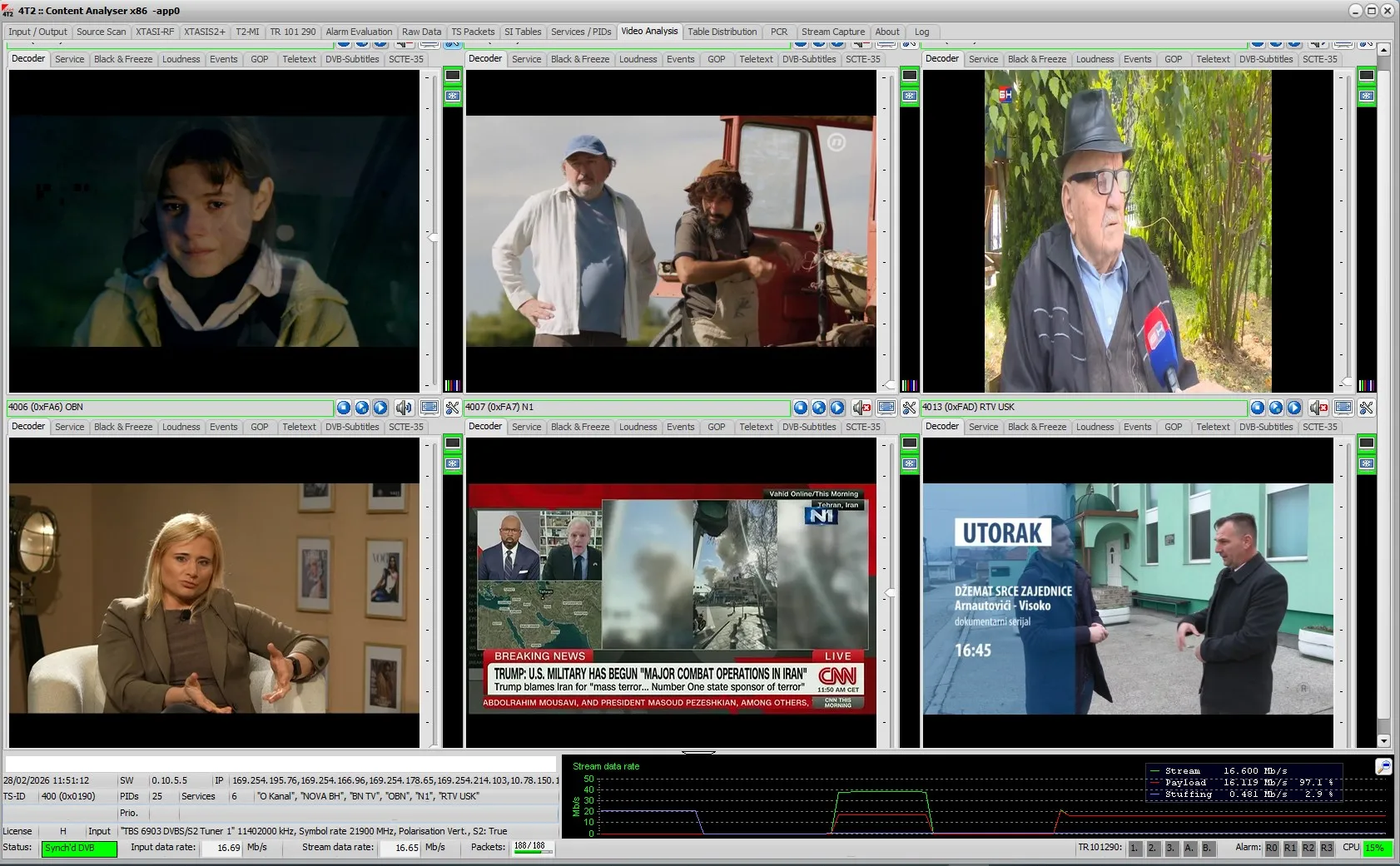

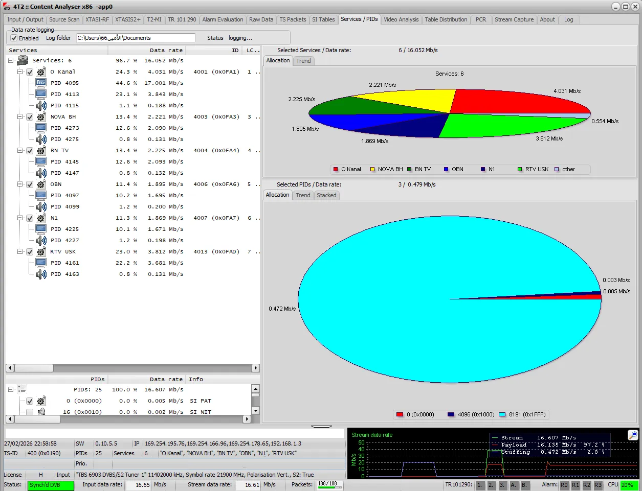

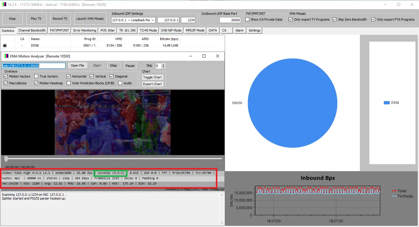

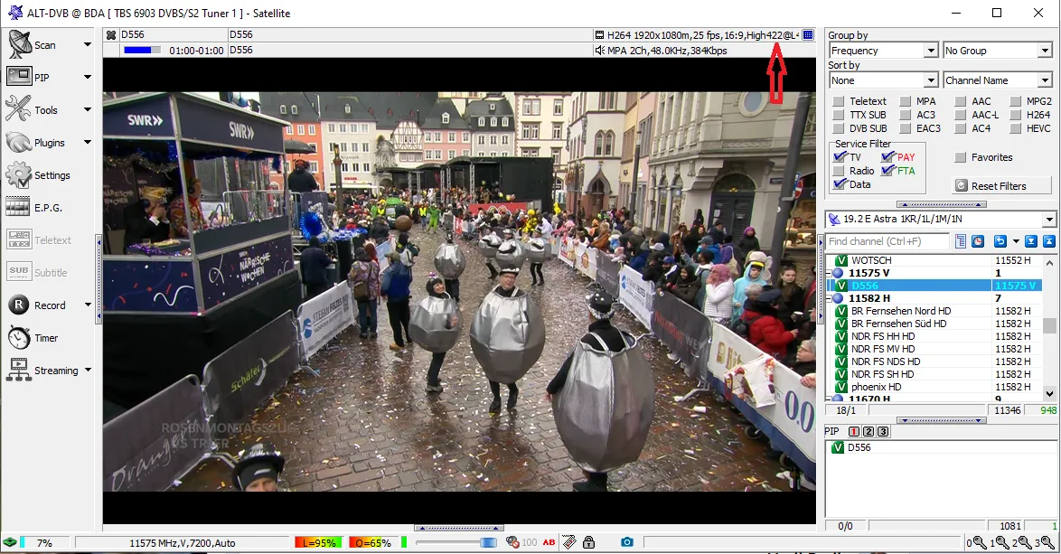

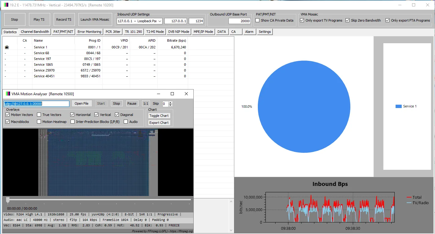

I'm now getting a weak but stable signal, but altdvb still isn't working.
Of all the ones I've tried, only 4T2 Content Analyzer has worked.
After the VIDI TV package was working normally on the 21.6° East satellite on frequency 11402 Vertical 21900,
using the ALTDVB program with T2-MI technology, it stopped working even though the channels still appear during scanning.
Today, we present a simple explanation of how to run it using the ABC4T2ContentAnalyser program,
which is considered a leader in T2-MI technology.

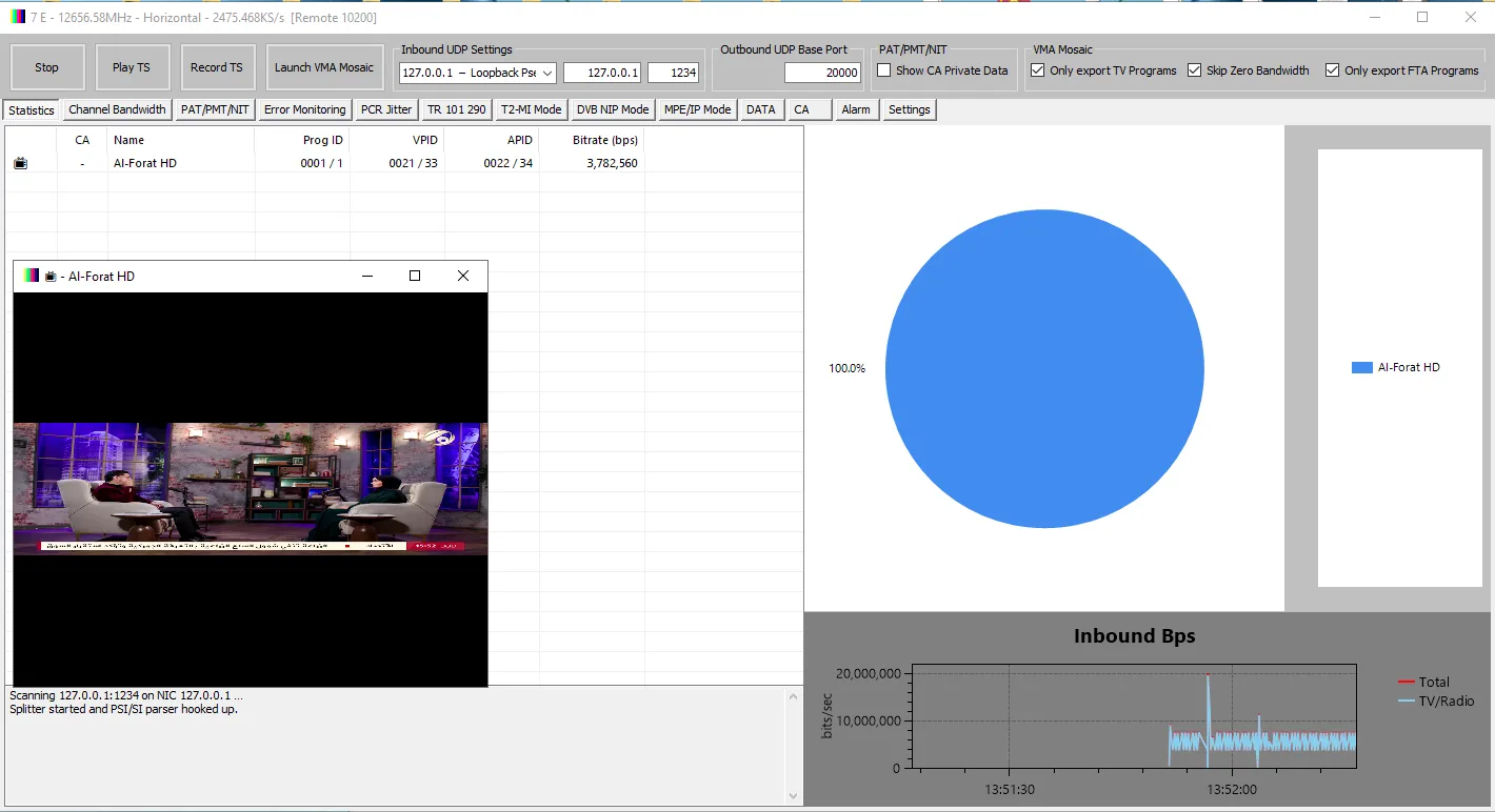

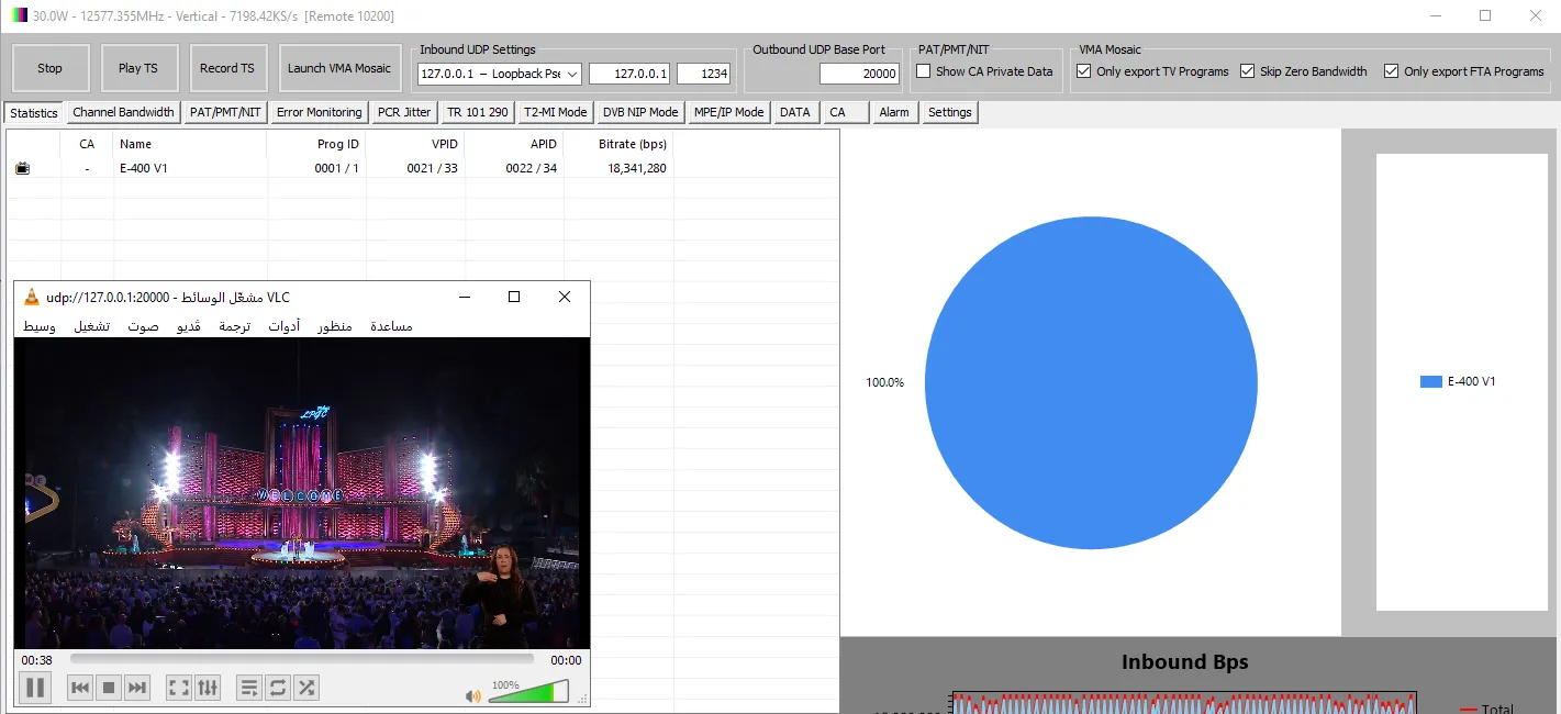

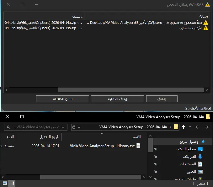

I cannot read arabic.
I think you need to enter the password.
Everyone with license.
You will find it in the VMA program directory
