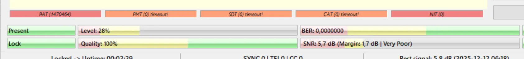

    Can you point bout, with screenshots, which are the priority texts that require a bigger font? I am not promising anything, because I am sure that increasing the font will break the layout...
    You can probably see it from here. The characters in the transponder data are really tiny on a 4K screen.
    I’d say the graph looks fine.
    I’d just add that the software works perfectly well even like this! :)

    I’ve noticed that this type of scan is much more accurate than BLScan2 for a 6903.
    One question: I have a 4K screen and the text looks very small.
    Do you think there’s a way to make it bigger? Perhaps in a configuration file?
