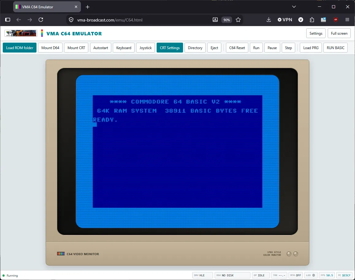

    In case you might have wondered about my absence in this forum (which I follow daily): I have taken a break on my satellite/TV hobby and dedicated my time to a different subject that has always been a passion, too. I am talking about emulation - reproducing a computer/console/calculator/etc. in software.
    The result is here: https://vma-broadcast.com/emu/ - this contains some pages with the historic context and currently 36 (!) emulators done in HTML/JScript. The required ROM's are not included for obvious reasons.
    And there is a stand-alone emulator that emulates a PC with Intel 486 CPU, capable of running DOS, WIN3.0, WIN3.1 and WIN95. Of course it can be used to run all those old PC games.
    It can be downloaded at the bottom of this page: https://vma-broadcast.com/download/
    Some interesting facts:
    1) The emulators include (where appropriate) a CRT simulation of common defects like scan lines, shadow mask, phosphor decay, etc.
    2) The VMA 486 Emulator includes a full debugger with disassembler and hex editor, allowing live analysis of the whole memory space of the emulated machine. It includes a "trainer", too. It can detect the memory where life count, damage, etc. is store for direct patching.
    3) The emulators are designed to work on mobile devices (smartphones and tablets) as well as on PC. They include virtual keyboard and joystick.

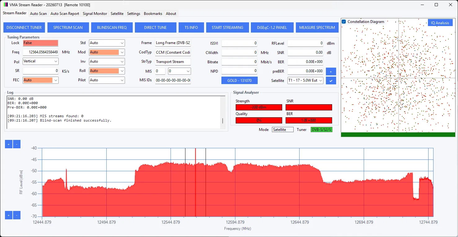

    Satellite Spectrum – perhaps it is time to use the right tool
    Hello,
    I have been following the continued discussions about obtaining increasingly detailed spectrum information from DVB tuner cards and satellite receivers.
    I find this slightly ironic.
    Satellite enthusiasts are prepared to spend considerable amounts of money on dishes, feeds, LNBs, positioners, tuner cards and receivers, and then spend an enormous amount of time trying to overcome the limitations of a DVB tuner in order to obtain something approaching a proper spectrum display.
    A DVB tuner is fundamentally a receiver and demodulator. Its spectrum display can be extremely useful for finding transponders, checking reception, blindscan and identifying signals. I have worked with these techniques myself for many years, and it is remarkable how much useful information can be extracted from comparatively inexpensive tuner hardware.
    But there are physical and architectural limits to what such hardware can provide.
    If the objective is really to examine the RF spectrum - weak carriers, adjacent signals, transponder shape, interference, noise floor, bandwidth, shoulders, spurious signals, etc. - why not use an instrument designed for that purpose?
    A proper spectrum analyser is the obvious solution, and used instruments are often surprisingly affordable. Today there is also another very accessible option: an SDR.
    Devices such as a HackRF, PlutoSDR or similar wideband SDR can provide a much more detailed and flexible view of the spectrum than the relatively low-resolution sweeps produced by most DVB tuners.
    This does not make tuner-based spectrum displays useless. Quite the opposite. They are excellent tools when the objective is receiving and analysing DVB signals.
    But spectrum analysis and DVB reception are two different jobs.
    For DVB parameters, lock, modulation, FEC, MER, constellation, transport streams, blindscan, etc., use the tuner.
    For examining the actual RF spectrum, use a spectrum analyser or an SDR. It will show you ALL transponders, no matter how low the SR. You will be able to determine the frequency and can THEN try to lock the transponder with a specific blindscan on that frequency.
    There comes a point where spending more and more effort trying to make a DVB tuner behave like RF measurement equipment becomes less practical than simply adding the appropriate instrument to the setup.
    For serious satellite experimentation, I think the ideal solution is to have both. They complement each other extremely well.

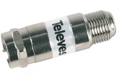

    Just make sure to use a DC BLOCKER when connecting the LNB output of the receiver (or a T), to prevent burning the input stage of the spectrum analyzer/SDR.

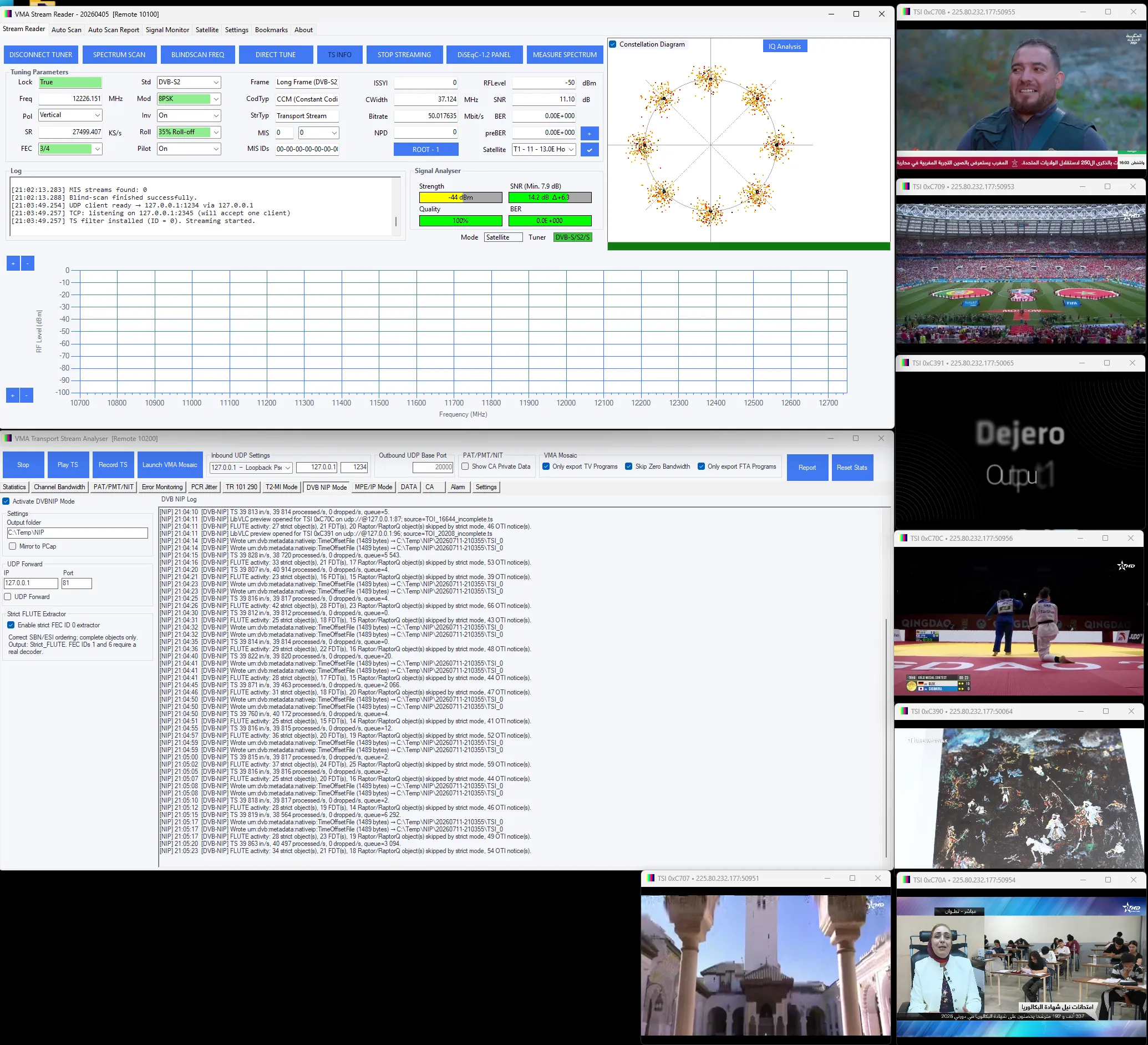

    With the new VMA Transport Stream Analyser version, you can reduce the Time to Parse PAT/PMT:
    This allows a much faster start of the application when START is clicked.
    Also, any subsequent change in the TS will automatically be recognized and all relevant tables will be updated accordingly.
    It is no longer needed to cycle STOP - START to update for a new TS.

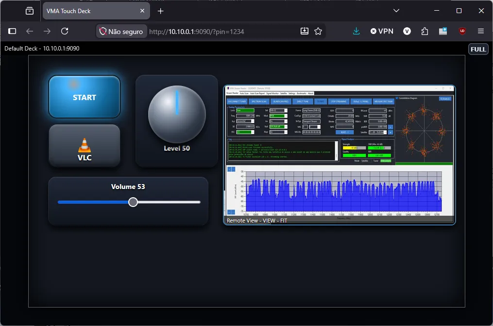

    VMA Touch Deck turns any phone, tablet, touchscreen, or browser into a customizable remote control panel for a Windows PC.
    You design buttons, sliders, knobs, labels, and remote-control views in the Studio application, assign actions to them, and then control your PC or applications over the network. It can be used locally or remotely through a VPN, making it useful for broadcast tools, media control, production workflows, demonstrations, support, and general Windows automation.
