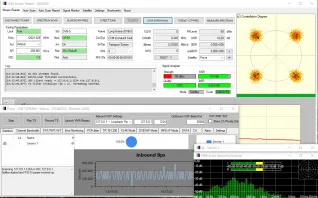

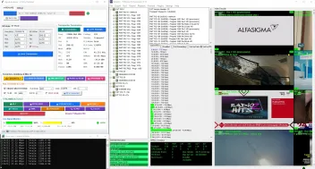

    My test results: on frequency 4102 H, it is impossible to view the feed using the Superdish mosaic engine; however, frequency 4029 H works fine for me, even with version 2.1.0.
    Tested with TBS5927 and TBS6904SE.

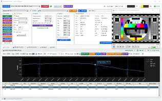

    Hi, i have spectrum but no lock signal with TBS 6904SE

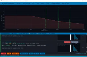

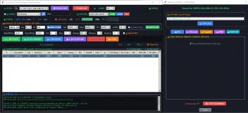

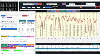

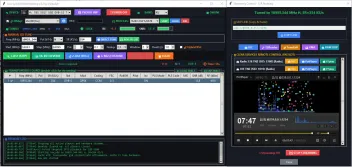

    The TBS6904SE works well for me; since it only supports BLScan 2, you need to set the "Force BLScan2" option (as shown in the image below), after which you can perform all types of scans: PEAK, FULL, FINE, and FFTSCAN.
    Clicking on the detected transponders initiates tuning automatically, without requiring any further action:

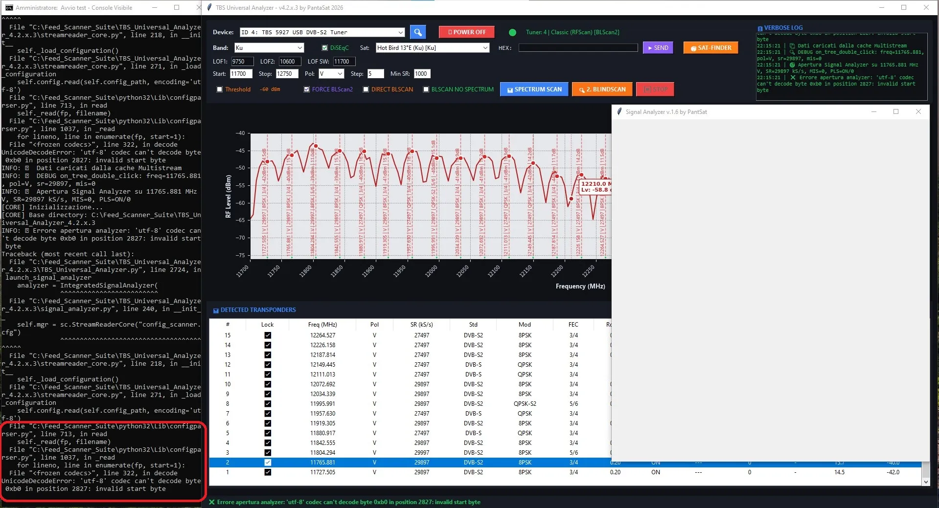

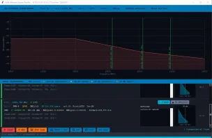

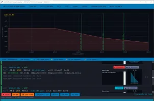

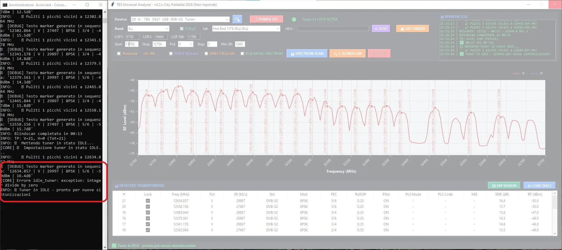

    Thanks to those who tested the TBS5927. I wanted to know if the issues I'm experiencing are unique to me. While my 5927 works perfectly with CrazyScan and other apps, it doesn't work at all with TBS_Universal_Analyzer v4.2.x.3, or even crashes.

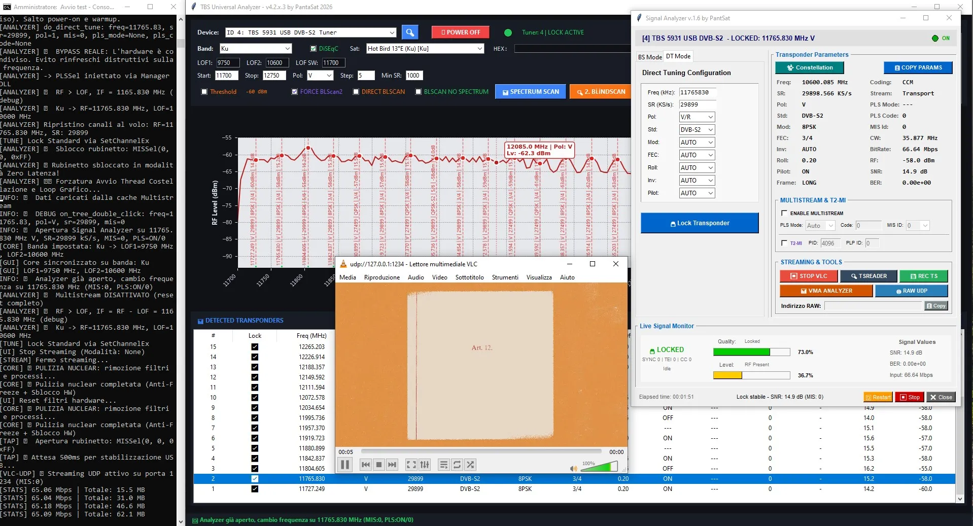

    TBS5927:
    TBS5931 (5930 Lite), on the same USB port, OK:

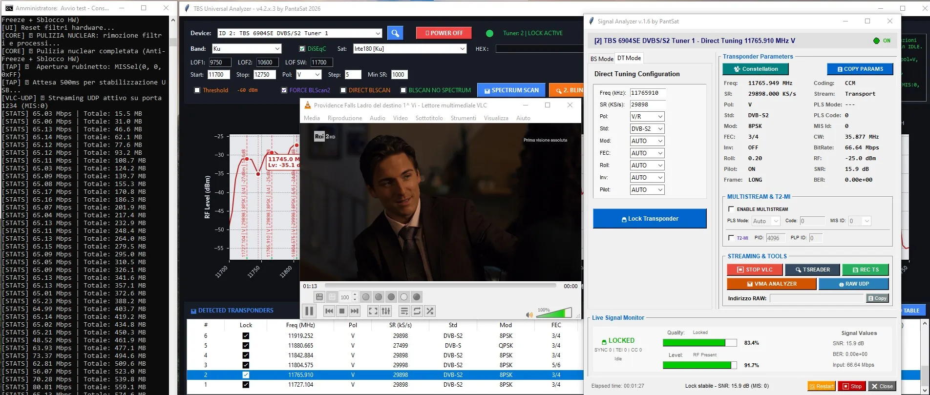

    No problem with TBS6904SE on PCIe:
    Since I've been able to test all versions of TBS_Universal_Analyzer, which generally worked well, either something has changed with the updated Python folder, or something has changed on my PC (Windows updates?):25::25::25:?

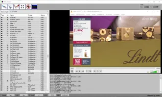

    PantaSat
    Oddly enough, unfortunately, it doesn't work on my TBS5927USB...even the frequencies that used to work fine don't work anymore...One question: what version of StreamReader.dll are you using for this test?
    VMA
    I'll test it thoroughly later, but at the moment I don't seem to notice any significant differences for low SR.

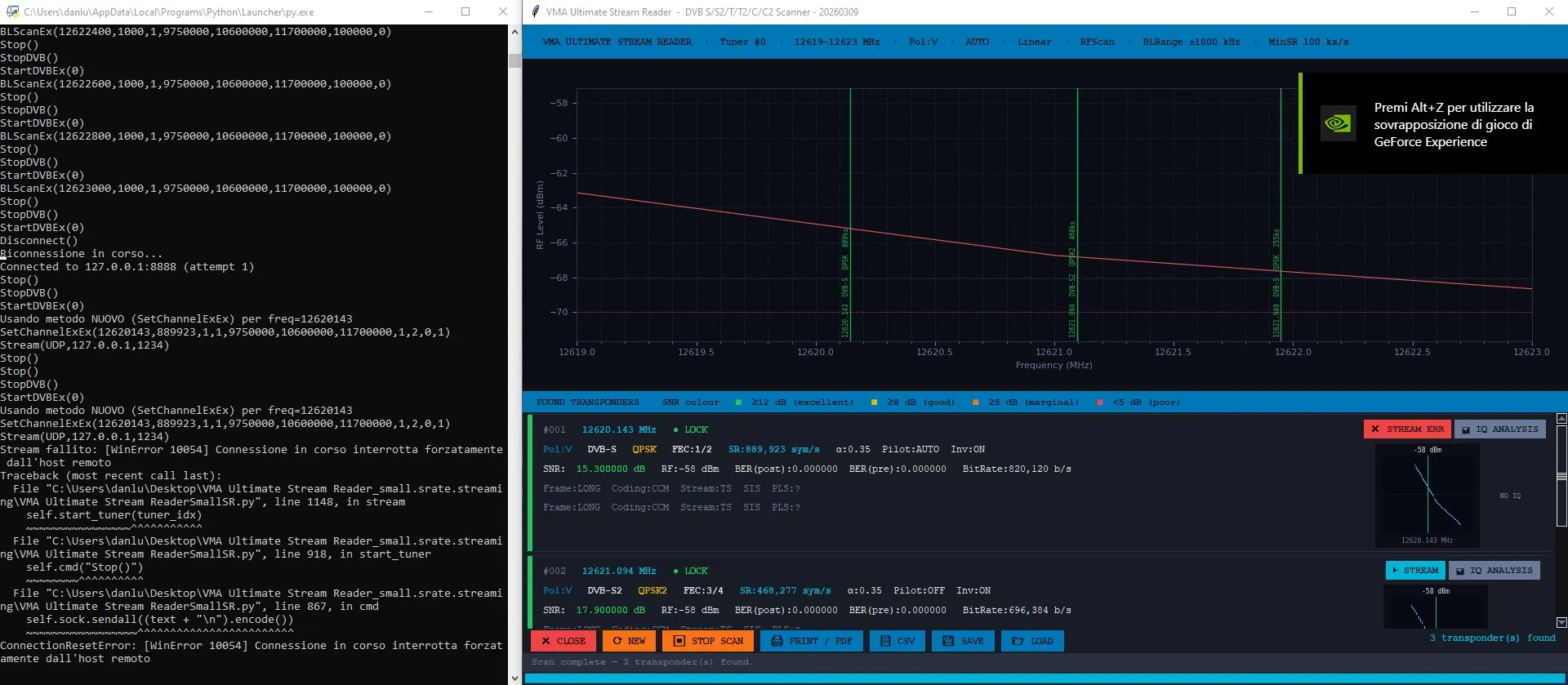

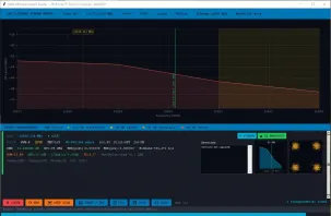

    Could it just be my problem?... do others have problems with low SR?... I've tried for a long time and have almost never been able to get radio channels below 500 mega symbols to work. Here's a good example, to test a scan, on 8W: freq. 12620, 12621, 12622 with SR of 890, 468, 255, all vertical. This happens to me: if I set something in "IQ constellation" or "service list," it finds the first frequency with SR 890, but already on the second, with SR 468, it stops, disconnecting me from the server.

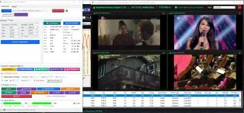

    If I leave everything free in the settings ("Skip Faster, no diagram" and "Skip Fastest"), then it finds all frequencies:

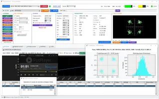

    But...if I tune the first freq. (SR 890) everything is OK:
    On the second frequency (SR 468), the block light on the TBS lights up for just a moment, then goes off; it's very unlikely that the block will activate permanently:
    On the third frequency (SR 255), it's too difficult... stopping and trying again leads to this:
