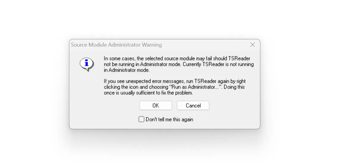

I have to open TS Reader from the main start menu to get the Profile Browser
Then use the File New or the New Icon

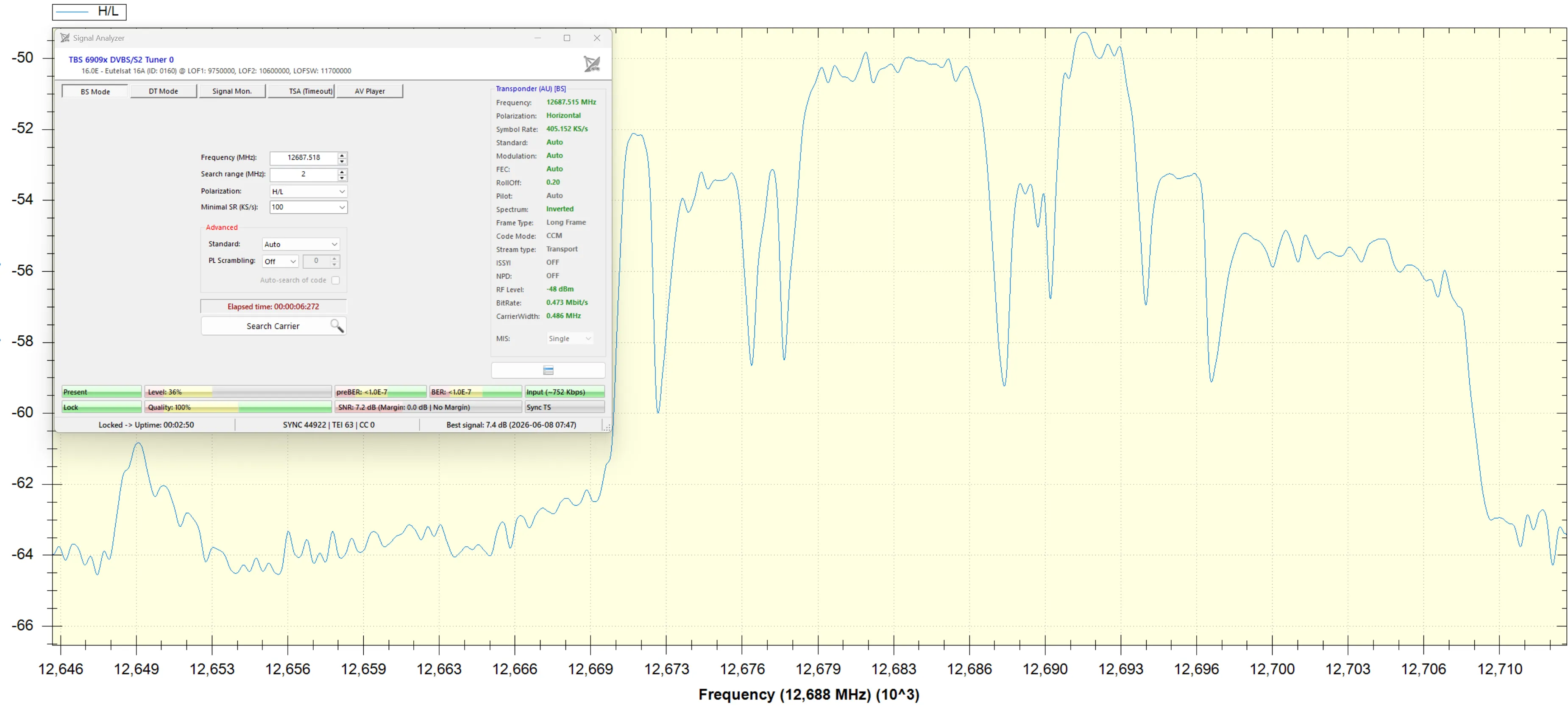

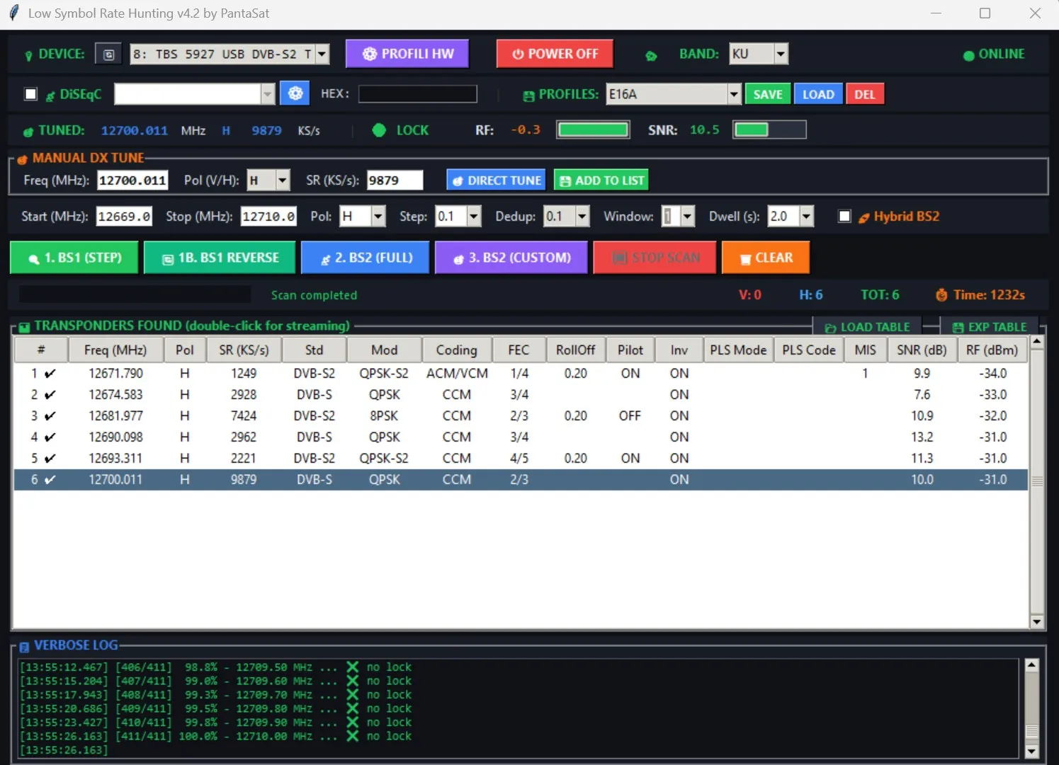

So I see you have a higher signal strength than me, 10.9dB to my 7.4dB. I see the signal is reported as QPSK-S2 FEC 3/5 which have a 2.2dB threshold?? but EBS shows a 0 dB margin with a 7.2dB signal.
I see also in your previous post #7 you had the success on 22°W Low SR signals on C Band with a FEC 1/2 and good signal
However the fact remains I can catch it with EBS but not LSRH V4.2 ? I will try a few more settings.
Thank you for the feedback.

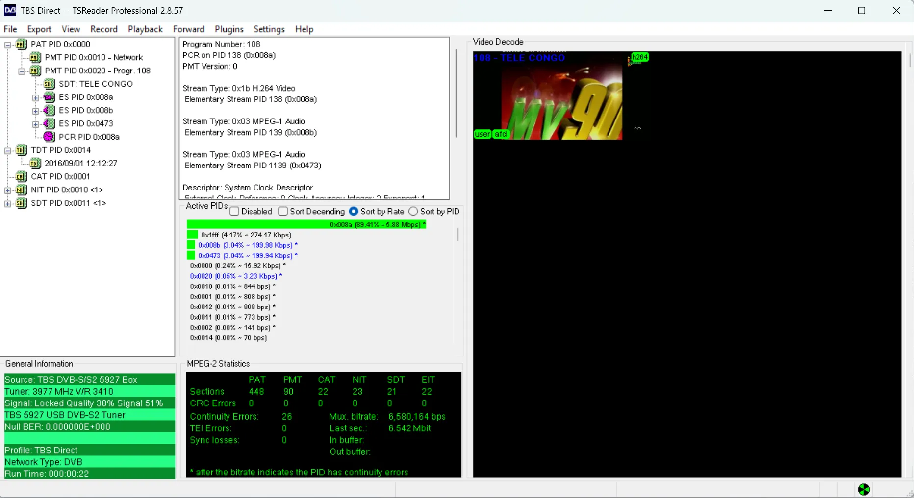

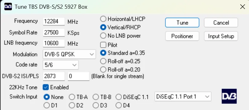

I have tested the Low SR V4.2 with my TBS5927. On 16°E The system seemed to miss the three Low SR transponders that I could lock using other software.
Please can anyone comment on my settings - (I have tried many combinations including dwell up to 10 seconds) or try the same 16°E scan with another card (TBS5983)

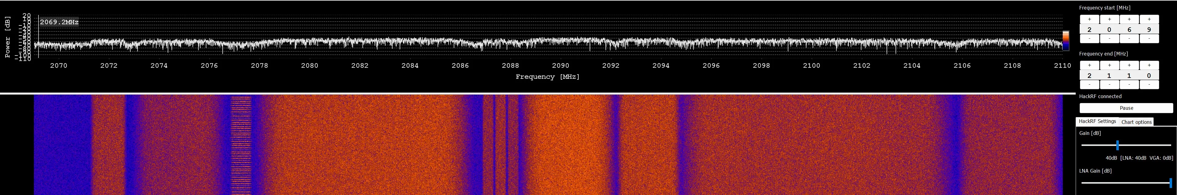

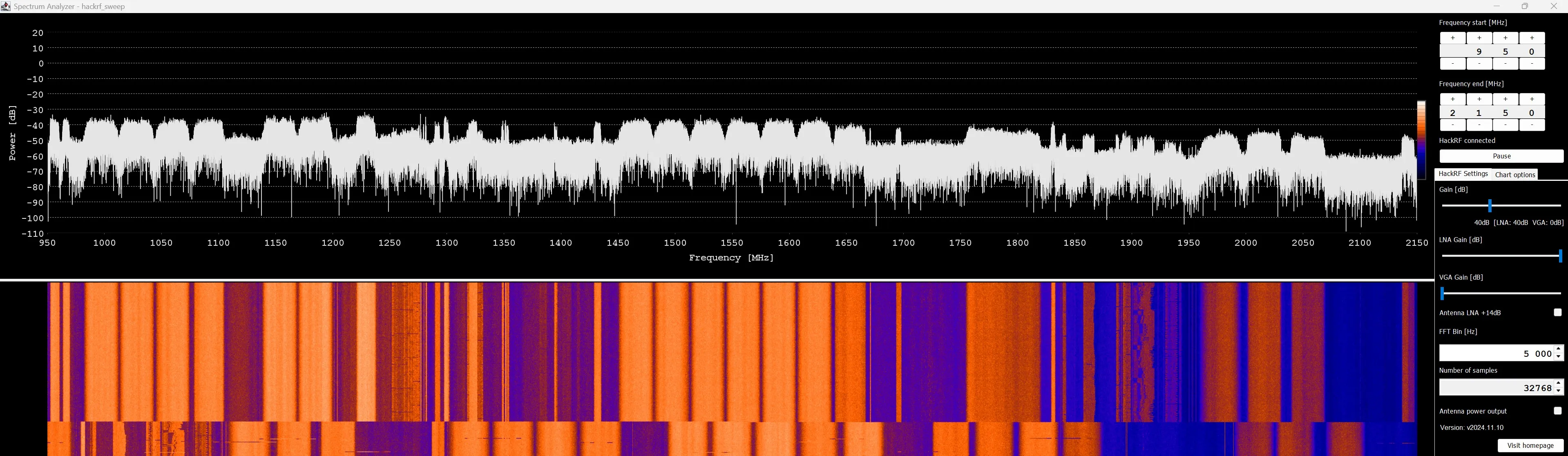

The spectrum shown using a 6903 or 6909 is very good in your applications, plus you can click them to scan etc. I know what you mean about a conventional spectrum display and have an Avcom unit.
VMA Sorry for my misunderstanding.
The HackRF and it clones are good for a wideband real time scan. See https://github.com/pavsa/hackrf-spectrum-analyzer - 6 fps at 950 -2150Mhz sweep
At this speed you could stich Low / High band and V+H together into one image in less than a second!
I don't have a TinySA Ultra (Yet?) - I know your software can use one, please can you explain its usage.
I currently have SDRs such as HackRF / SDRplay / Airspy etc

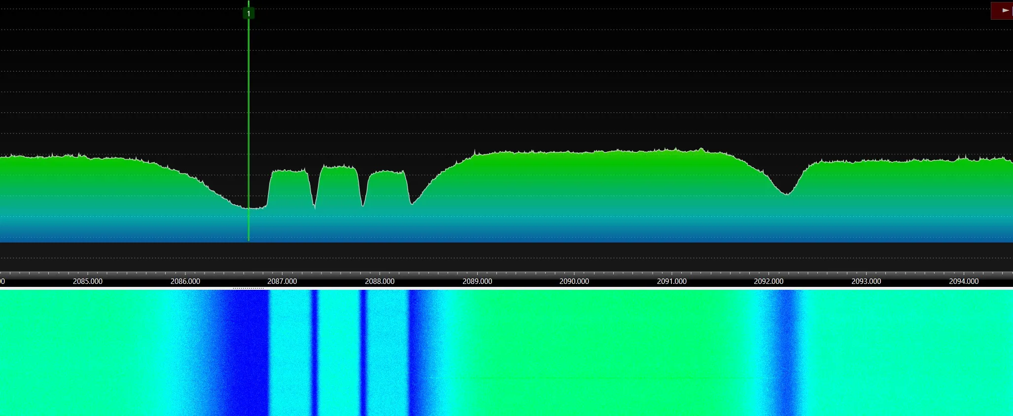

A few more narrow bandwidth signals in this location. IF Frequency shown with 9750Mhz LO LNB (PLL but not calibrated)
