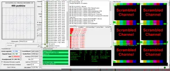

With the new AltDVB, we have access to satellite IP streams. The first test is at 1.0 W where Simmin TV/Radio is transmitted on mux 11056 V,3500, 1/2, S2.

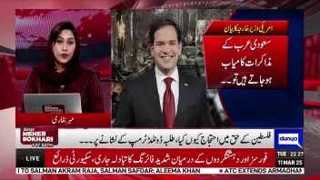

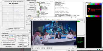

I used the DVB applications implemented in the player through which we can analyze the transmission data and run an IP stream, this time via TSReader.Here is a first test with the Simmin TV IP stream obtained with AltDVB:
Hello satesco
how do you make it work with altdvb that tsreader see already clear stream?
you use stream function? but do you add manually any pid to scanned service?
with other software im able to play but maybe altdvb will be easier to see this stream from time to time.
