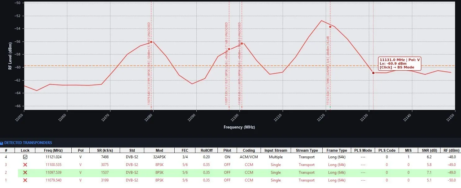

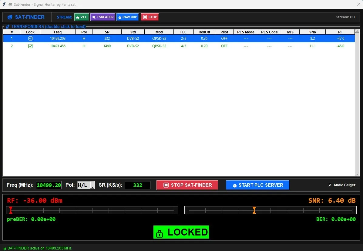

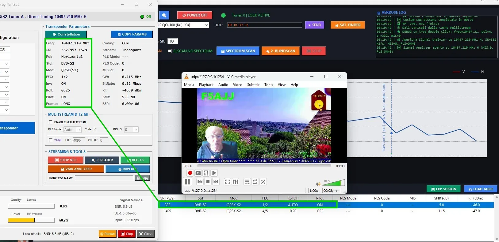

Hallo,
ich habe gerade einen Test mit einer funkAmateurfrequenz auf Es'hail-2 gemacht.
Mit „Spectrum+ fine“ wurde sofort eine Frequenz mit einem SR von 332 gefunden.
Anschließend wurden alle Analyseoptionen genutzt, und das Ganze lief stabil.
Hier sind die Ergebnisse in Bildern.
I’ve just carried out a test using an amateur radio frequency on Es’hail-2.
A frequency with an SR of 332 was found straight away using ‘Spectrum+ fine’.
I then tried all the available analysis options, and it worked consistently.
Here are the results in pictures.

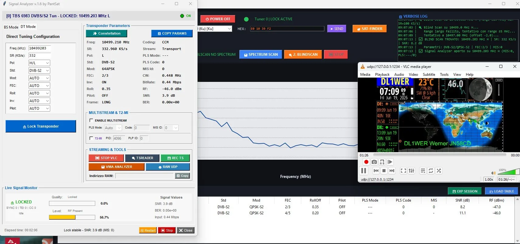

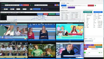

Same result for me with the TBS 6983.![]()
What superb work, Pantasat (especially in such high temperatures).![]()
We’ll need to slightly adjust the habits we formed with the previous versions.
I can't wait to try this new version of TBS Universal.![]()

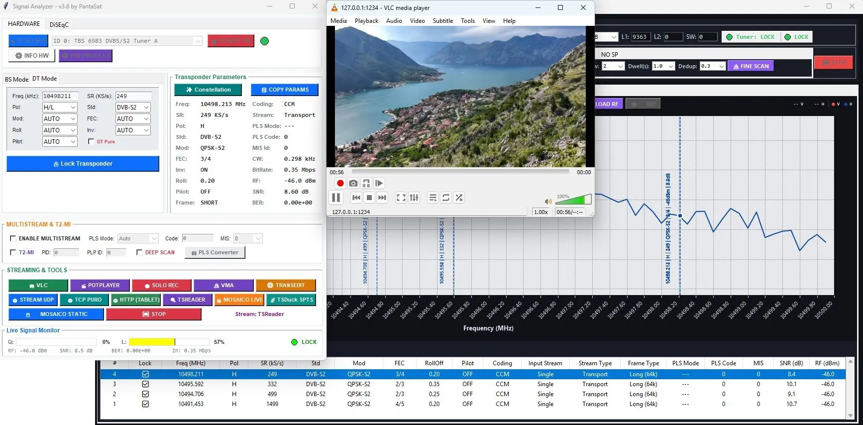

How would you prefer these scan types to be organized? I am open to suggestions—
PantaSat
With "Frequency Tester," a green dot appears when the device (tuner) is activated; I find that very clear and easy to understand.
In the other programs in the suite, the dot stays red when the tuner is activated because it indicates a "lock," so you really have to look closely to see if the tuner is actually on; I don't find that very practical.
I prefer the approach used in Frequency Tester.

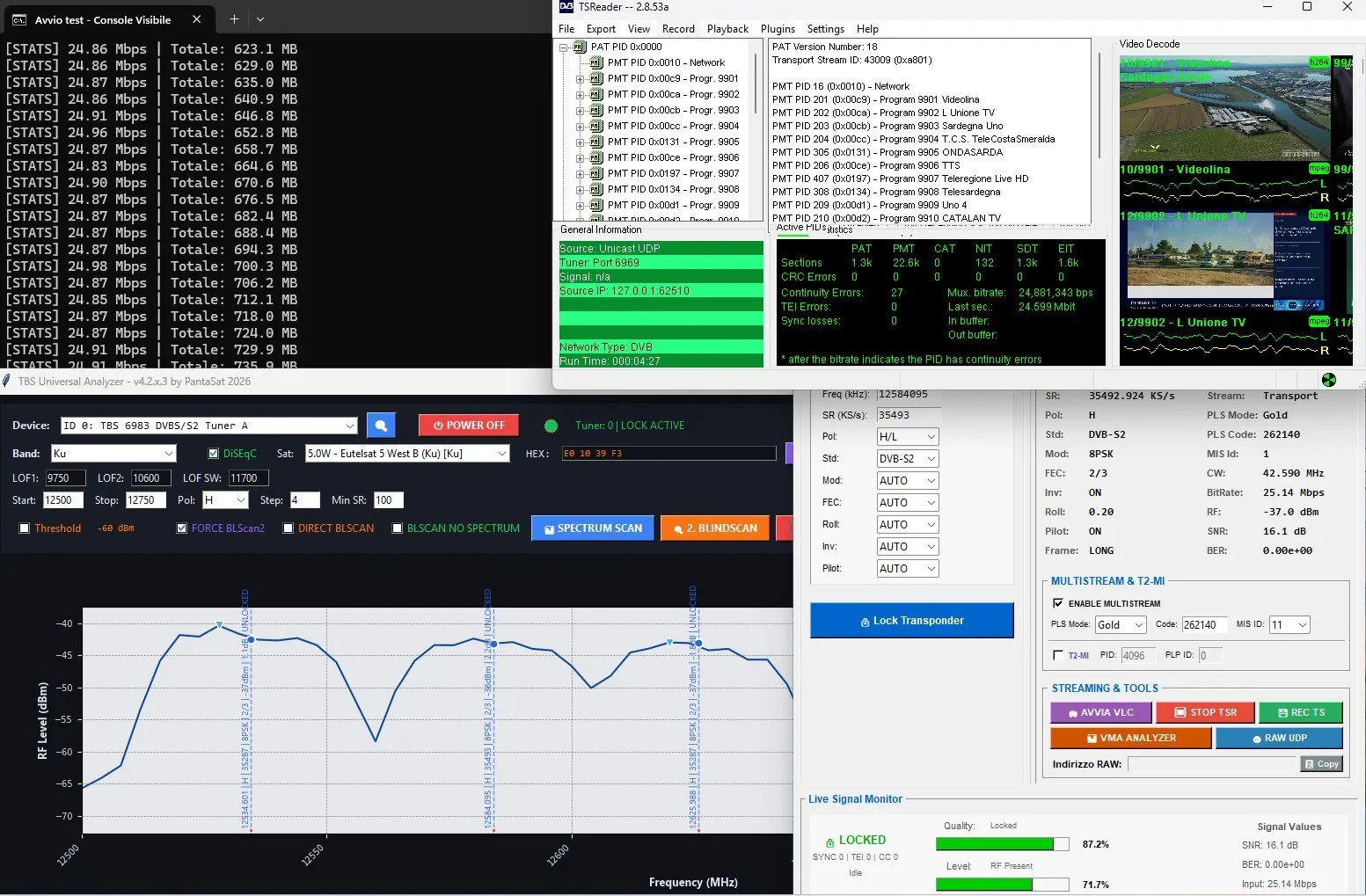

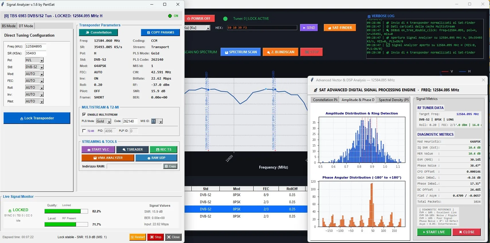

Tbs Universal Analyser funktioniert ganz gut mit sehr kleinem SR ( 500 mit BLS2 gefunden)![]()
Signal Analyser und Satfinder haben auch damit kein Problem ![]()
einzige Fragezeichen ; bei dem BS diese Transponder ist mit QPSK-S2 FEC 3/5 gefunden und bei Signal Analyser mit 64APSK FEC 25/36 eingegeben.![]()
The TBS Universal Analyzer works quite well with a very low SR (found 500 with BLS2).
The Signal Analyzer and Satfinder have no trouble with it either.
The only question mark is this: with the Blind Scan, this transponder was detected using QPSK-S2 FEC 3/5, whereas in the Signal Analyzer, it was entered as 64APSK FEC 25/36.

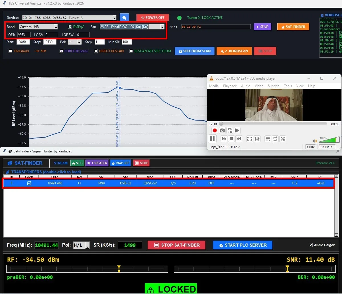

With Custom LNB
BS1 Blindscan step 1 is not working ?? It works above.
BS2 Blindscan ist working with step 0.2![]()

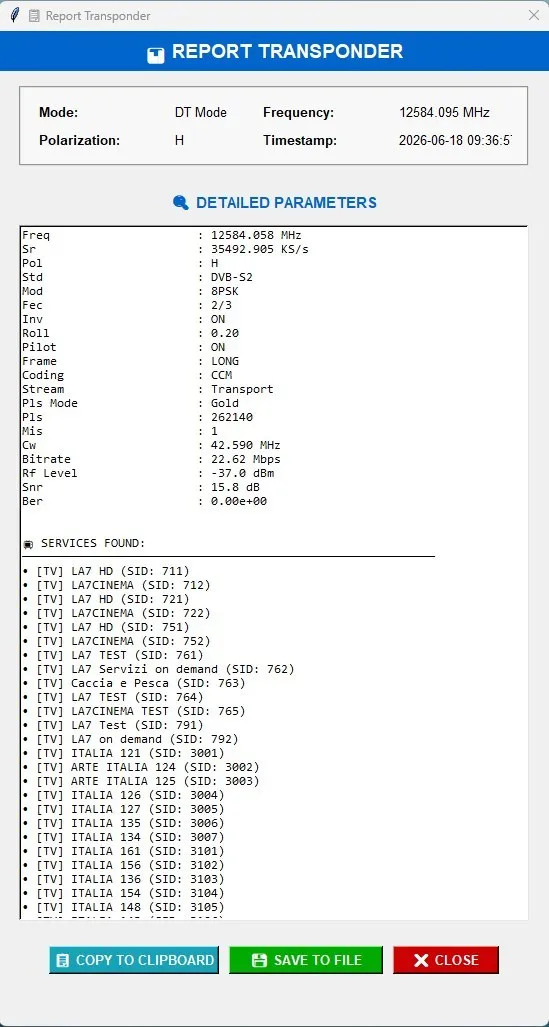

it would be even better, however, if the spectrum could be enlarged as needed. Let’s not forget that reception results using this utility are posted on forums to illustrate them. They are, therefore, also intended for those who want to compare what can be compared.
Hallo satesco
Wenn Du auf „exp session“ klicken, erhaltest Du ein großes und gut lesbares Spektrum.
If you click on "exp session," you get a large and easily readable spectrum.
