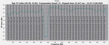

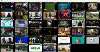

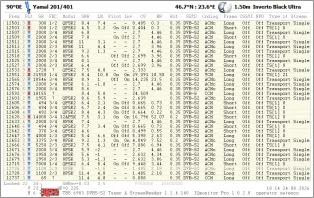

    I thought I’d post in this section about reception on the upper band at 90.0E because, although most recently activated transponders are generic streams, their reception matters more than other forum-related considerations. First, sensitive tuners are needed to detect them, but more importantly, DVB applications are required to detect and lock onto them.
    Of those I’ve used – IQmonitor, Crazyscan and TBS_Universal 8.6 – the first is, as I expected, the most effective at detecting and locking onto nearby transponders. The other two mentioned are also useful, more for confirmation, so to speak, because, although they do the same thing as the first one, they lack the precision and ability to ‘dig deep’ and lock a weak signal detected a few kHz away, as IQmonitor does. That’s why strannik created it. I haven’t resumed scanning with IQmonitor because I'm short on time, even though this is just a hobby.
    Of course, with this ability to do what other apps cannot, there is a price to pay: the risk that IQmonitor might crash. This has happened to me twice while scanning this Ku-band section. Last week it detected several muxes with symbol rates of 2000 Ks, and this week it found symbol rates of 1000 Ks in the same band section. This IQmonitor crash may also be due to the settings I applied.
    But without going on too long, I’ll post the results of this scan. It would be good if other enthusiasts with the 6983 card tried scanning this band section. If they get a stronger signal, they might find others I couldn't detect (even though they appear to be there).:3:

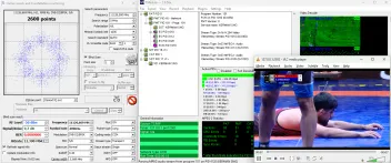

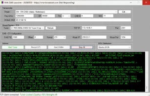

    With 6909x, I locked 12564 V using DAB Launcher, then played the stream; however, I’m seeing what looks like a playback error because the app isn’t reading it correctly (?), and the DAB player won’t launch.
    On the other hand, the Metropolitan DAB stream displays correctly, but Dablin won’t launch because it’s pinned to the taskbar. In fact, it’s the same error as before.
    I also checked WDR DAB at 19.2E using the 6983 card, and here’s the message I get from the DAB Launcher.
    I think the problem is the DAB player, because it won’t launch even though the stream displays correctly.:25:

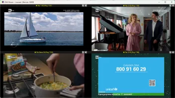

    I assume you’re trying to tune in to 12,564 V-RAI streams at 5.0W using the 6903x card. With the stid135 cards, it’s a problem if the signal is on the limit on these PLS multiplexes.
    I tried using Crazyscan, but as the signal was on the limit, it crashed after a while. However, with your app, VMS Stream Reader and the 6909x card, it locked as soon as I entered the code, but I was also able to run the stream from a MIS smoothly.
    You’re probably trying to check the VMA DAB Launcher, which yesterday I couldn’t use to decode DAB RAI on a PLS stream with a TBS card. :74:

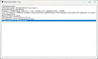

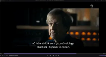

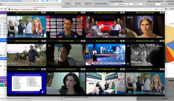

    Hi Vitor,

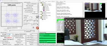

    I can’t work out why the DAB is giving an error when playing the RAI DAB stream on 12564 V. I’d also add that, although I had a good signal, I found it extremely difficult to lock it.
    I also checked DAB Metropolitan and, although the stream started playing correctly, it couldn’t open; even though the Dablin player was enabled, it wouldn’t launch on the desktop. The screenshot shows a player issue.
    Could you identify the error from these two screenshots and the StreamReader log?
    I have no issues with other DAB apps on the streams mentioned.
    Thanks :3:

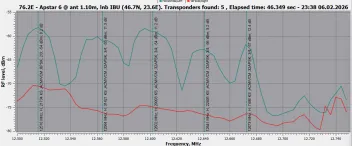

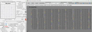

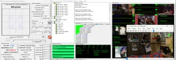

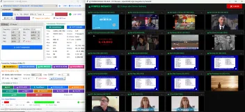

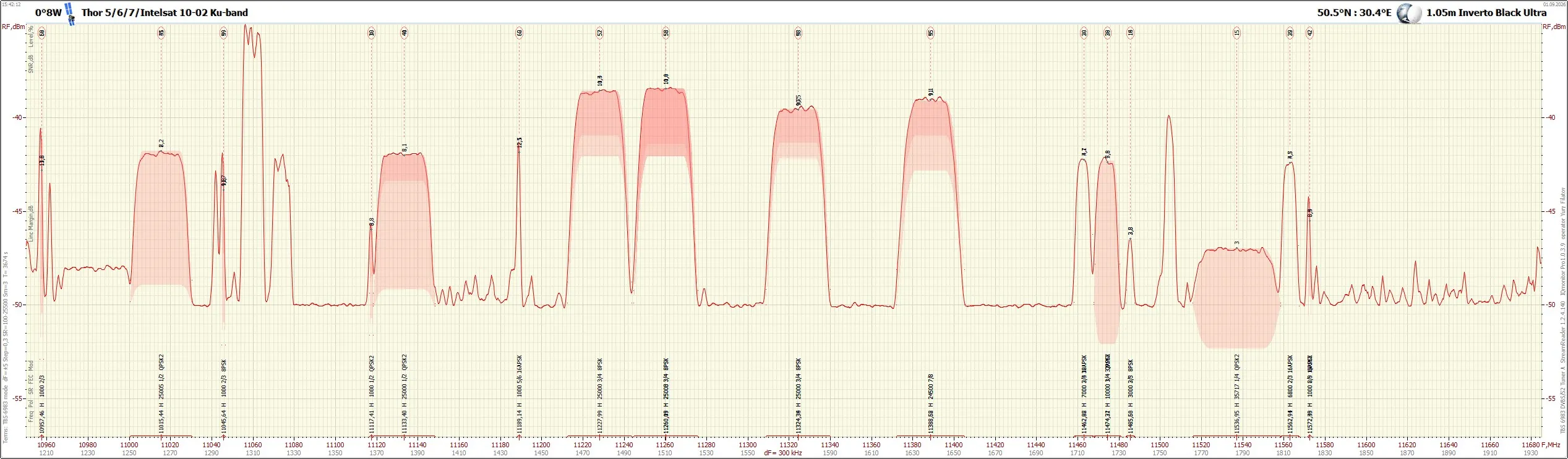

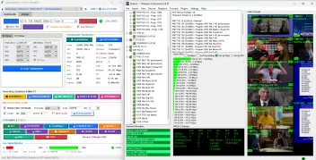

    I did more than just scan with IQmonitorPro v.1.2.0.8 and Crazyscan v1.2.0.181 using the TBS6909x card at 1.0 W; I also used the TBS Universal 8.2, VMA Stream Reader and EBSPro apps, and for all of these I used the same version of StreamReader: 1.2.0.140.
    I also carried out a scan at 1.0 W on Linux using the neumoDVB app, in case anyone is interested.
    With this version of StreamReader, I managed to scan and achieve the best result with the tbs6909x card since I started working with IQmonitorPro using a stid135 card.
    And with this test using the 6909x card, I also regretted that you didn’t have it on hand.
