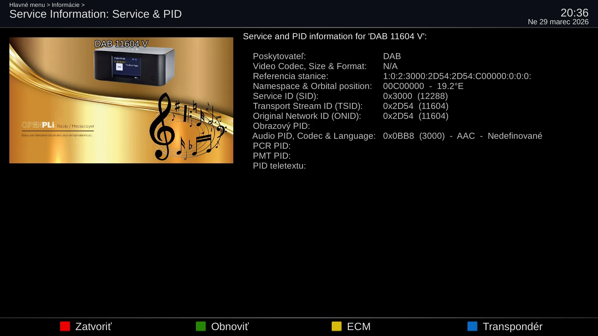

At this point I would appreciate if someone could tell me how to configure a DAB transponder on E2?

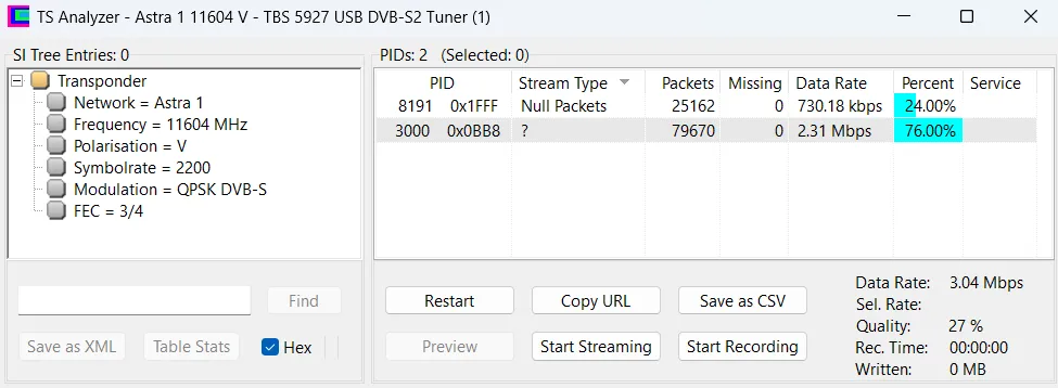

Please consider the 19.2E 11604 V transponder carrying WDR DAB service.

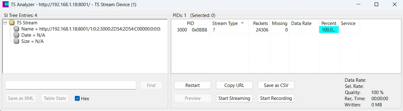

A normal transponder scan says: 0 transponder found. So how do I configure this?If the transponder does not contain a PAT or SDT, the scan result is zero.

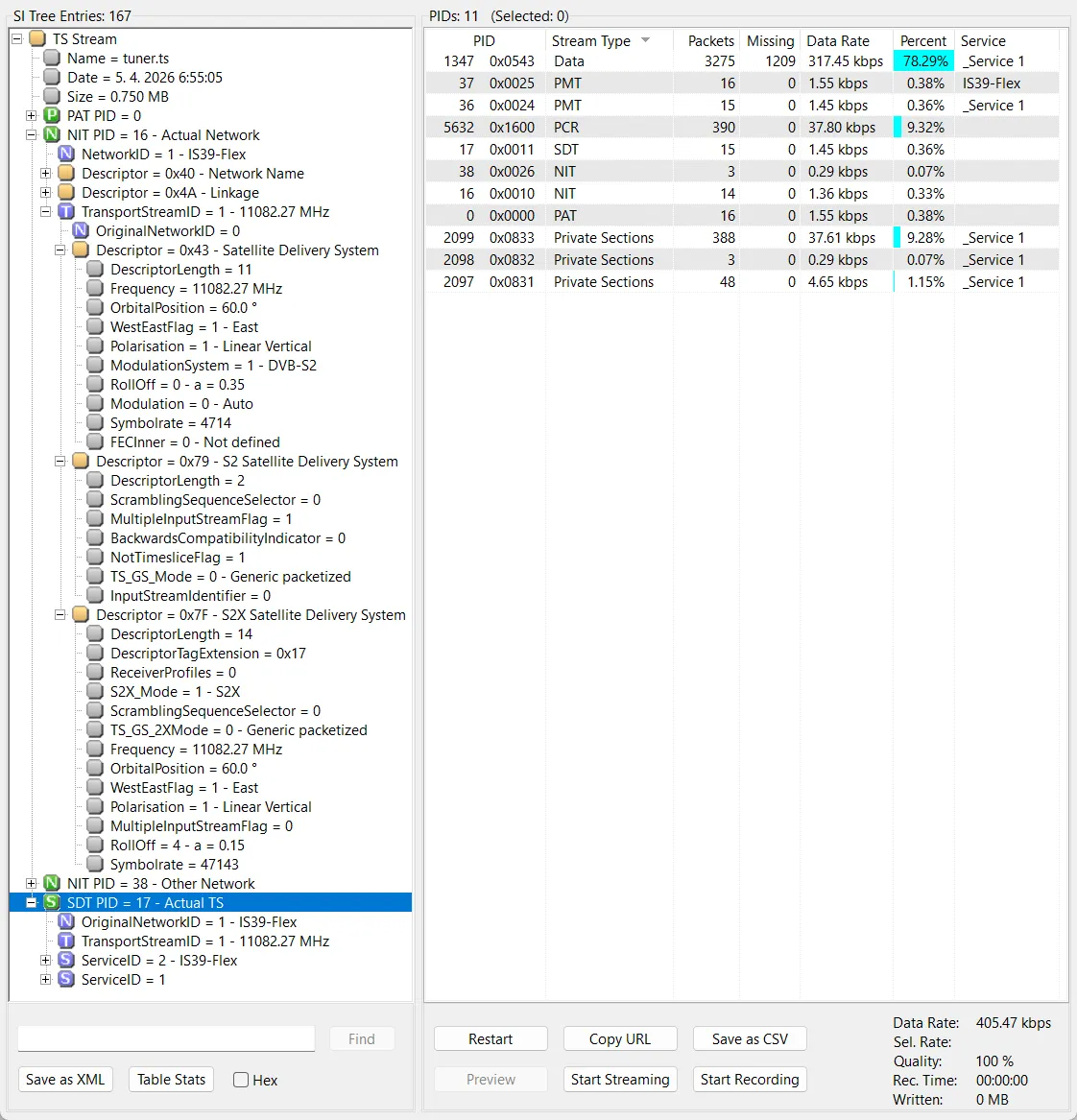

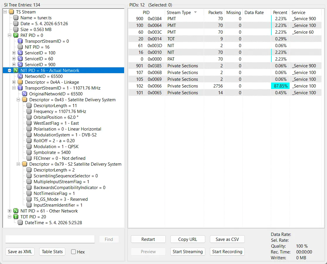

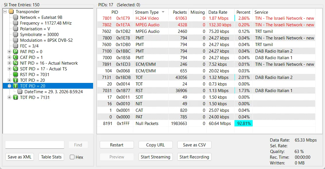

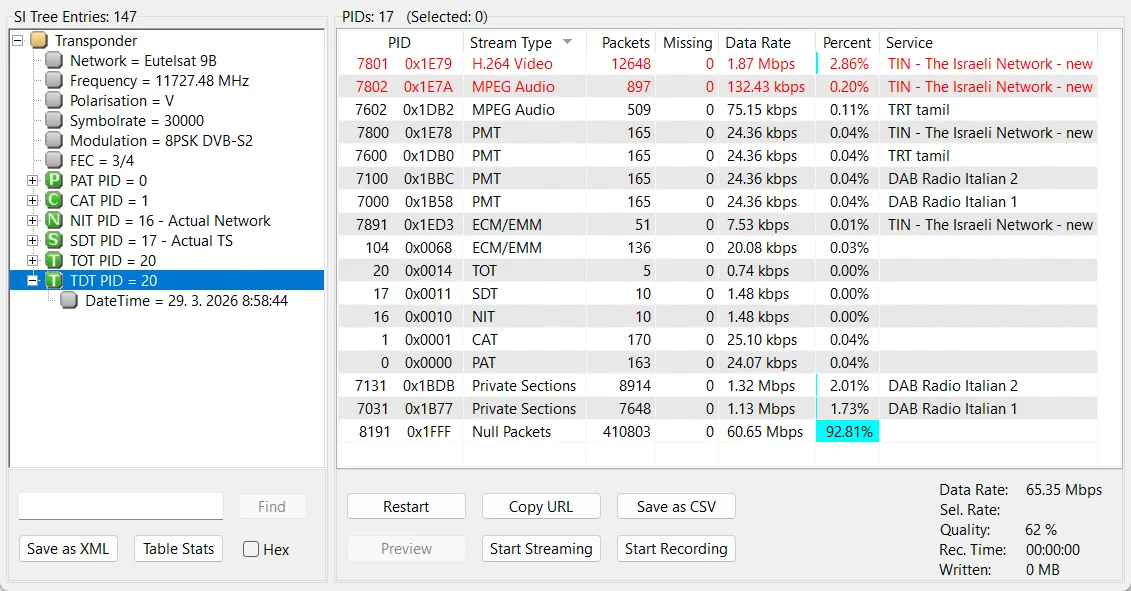

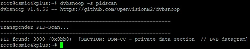

You can also use dvbsnoop to identify active PIDs. If a DSM-CC PID is found, there is a high probability that the content is multimedia.
Using the editor or by editing the lamedb file, you need to create a virtual channel for this transponder
lamedb.txt - (remove the TXT extension)
e.g.
eDVB services /4/
transponders
00c00000:2d56:2d56
s 11606000:1000000:1:3:192:2:0
00c00000:2d54:2d54
s 11604000:2200000:1:3:192:2:0
end
services
3000:00c00000:2d54:2d54:2:0:0
DAB 11604 V
p:DAB,c:150bb8,f:4
fffe:00c00000:2d56:2d56:1:0:0
Test c
p:TEST,c:001000,c:011001,c:021002,c:031003,c:041004,c:051005,c:061006,c:071007,c:081008,c:091009,c:101010,c:111011,c:121012,c:131013,c:141014,c:151015,c:161016,c:171017,c:181018,c:191019,c:201020,c:211021,f:4
end
Have a lot of bugs!

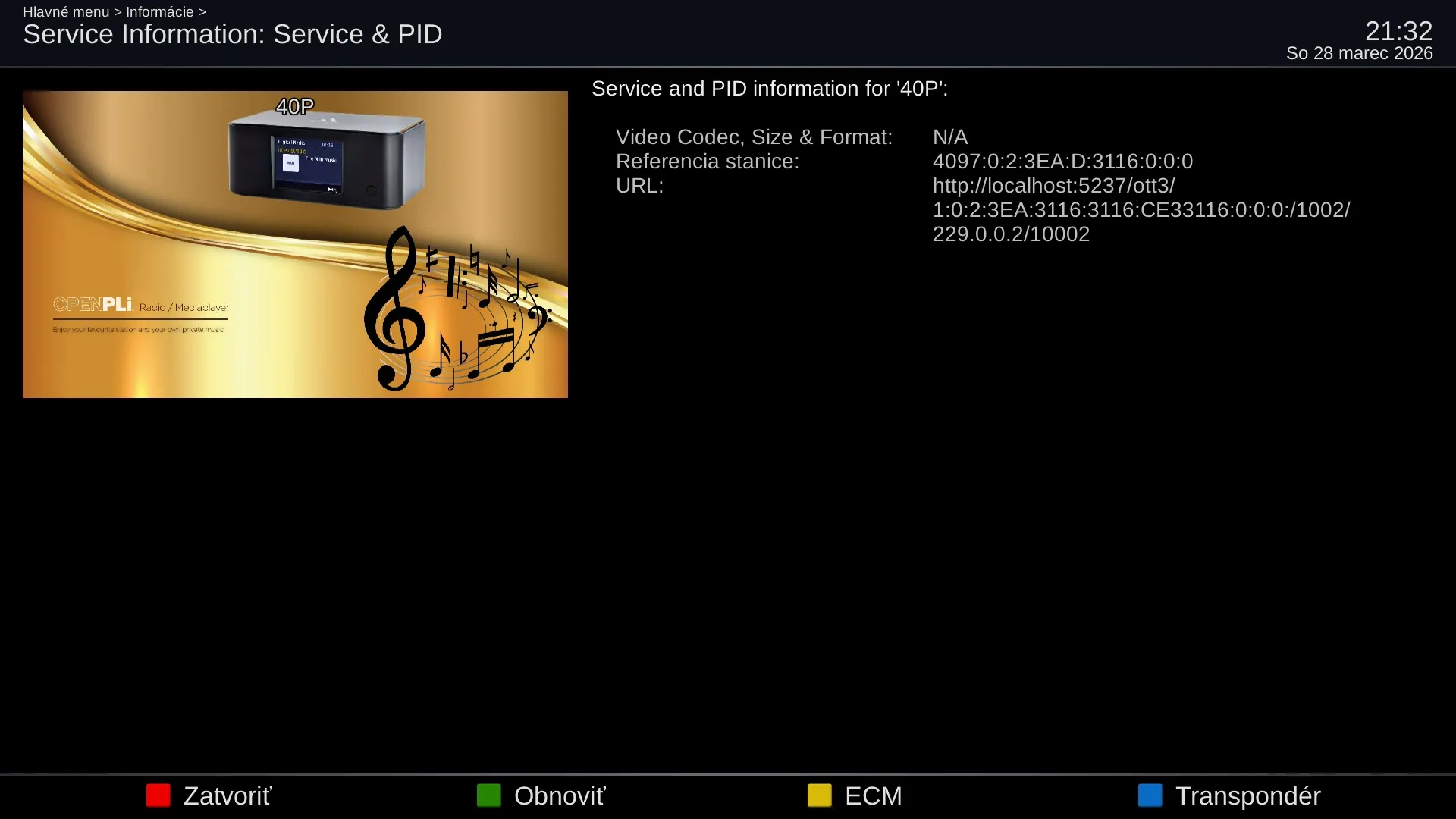

PS: The OpenPLi-based system uses the c15 parameter as the DATA-pid definition. The OpenATV-based system uses c18 as the DATA-pid definition, but also accepts c15 as the AAC-pid.

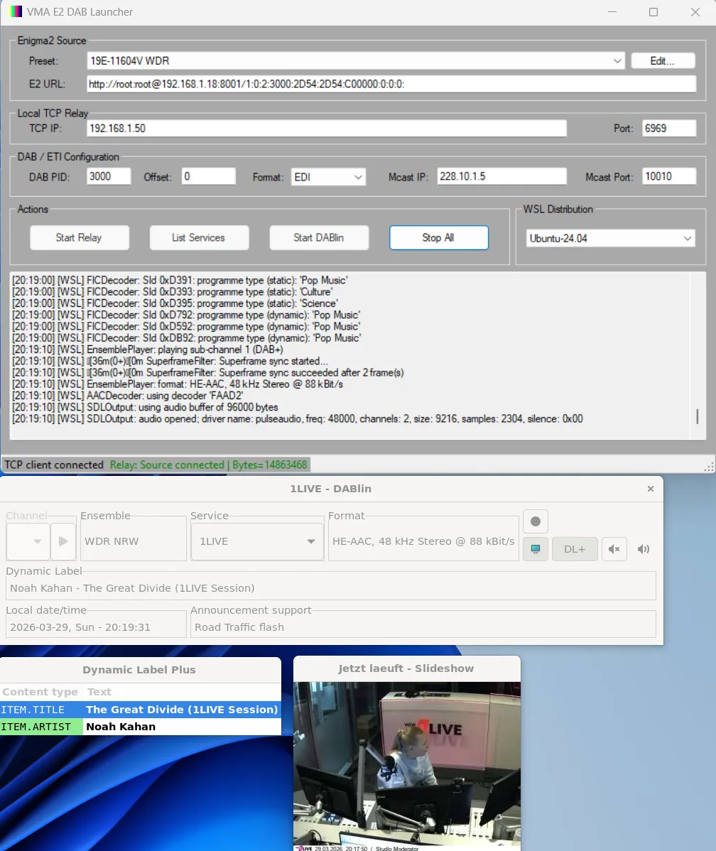

After the update, a virtual channel is available in Enigma2

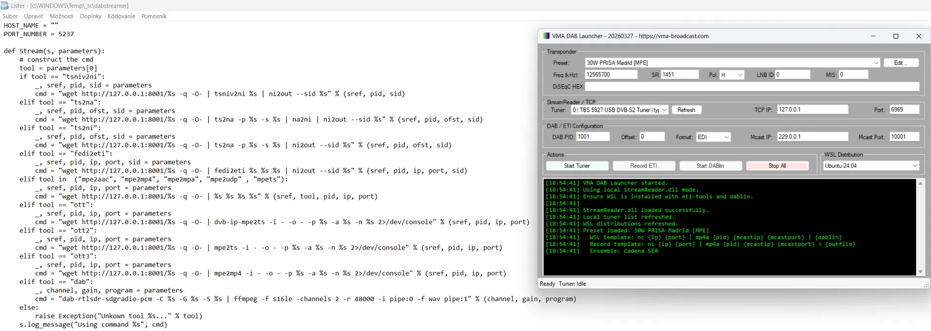

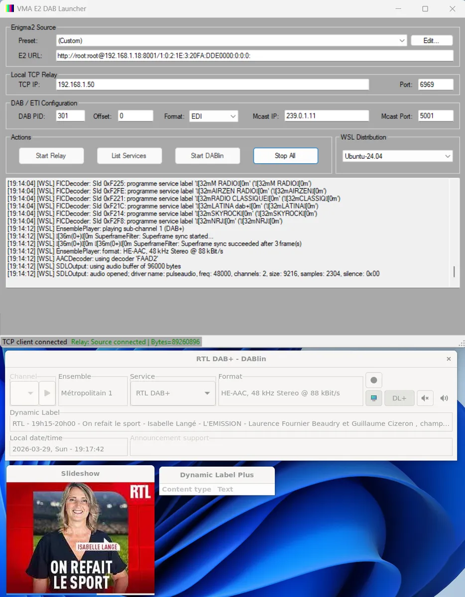

The initial tests with the "VMA E2 DAB Launcher" look very promising
Truly excellent work VMA
Perhaps a dedicated "VMA E2 DAB Launcher" would make more sense. But again, I am not sure of how big the "market" for such a tool would be.
Probably very few people—just a handful—know how to use the Enigma for more than just switching channels
On the other hand, if it's on the menu, people will start using it

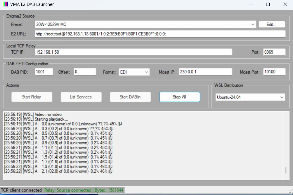

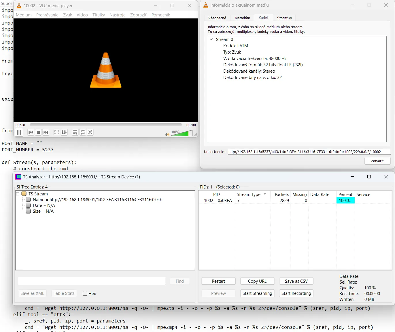

For example, use an Enigma2 box as a tuner that sends DATA from a PID (in this specific case, for example, PID 1002 = MPE ip 229.0.0.2 port 10002) to the VMA DAB Launcher, where the controls are more intuitive than creating a userbouquet from Dabstreamer in Enigma2.
Dabstreamer - uses the eti-tools utility in Enigma2 -
VMA Do you think it would be possible to add an IP stream from Dabstreamer as a Tuner e2 ?

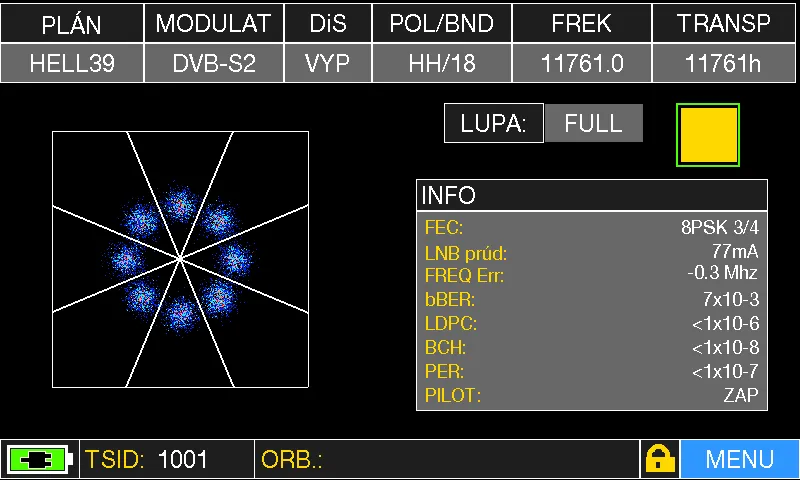

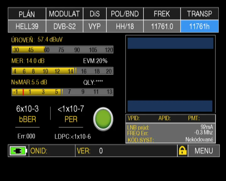

It displays what is defined in satellites.xml (does not display data from the signal). And since it operates in AUTO mode, it can handle even incorrectly configured DVB-S/DVB-S2 mode.
ROVER HD TAB900+ accept only GOLD 242133
Enigma2 accepts both, but only processes GOLD
<transponder frequency="11761000" symbol_rate="15155000" polarization="0" fec_inner="3" system="1" modulation="2" is_id="0" pls_mode="0" pls_code="211867" t2mi_plp_id="0" t2mi_pid="4096"/>
<transponder frequency="11778000" symbol_rate="15155000" polarization="0" fec_inner="3" system="1" modulation="2" is_id="0" pls_mode="1" pls_code="242133" t2mi_plp_id="0" t2mi_pid="4096"/>
