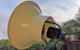

    Here are some pictures of the set-up used for Alphasat on 39.402GHz.

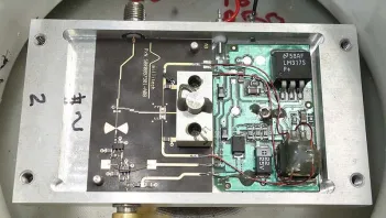

    It is part of an old experimental link RX head end, thanks to uhf-satcom. An external, 9.5GHz, GPSDO locked source is multiplied, in the harmonic mixer, to give a 38GHz LO. The noise figure is in the region of 12-14dB with a linear polarised feed on a 220mm Cassegrain dish. It had been stored in a dusty environment for a while and the LNA chip shows it. There have been problems with poor connections but repairs are difficult.
  • The LNA was in a bad state and gave up. The conductive epoxy, holding the LNA & de-coupling die, had not stuck to the aluminium base very well. All 3 die fell off when touched. I removed the remnants of the LNA, modified he board and fitted an Analog Devices HMC1040 LNA using a combination of silver paint and low melting point solder. It took a while to get it stable and needed some absorber over the new chip.
    In the end, I got about 12dB better SNR on the Alphasat 39402MHz beacon.
